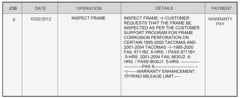

    No, unfortunately the previous owner didn't get it undercoated by Toyota. That was a requirement to get the extend the warranty of the frame. When I called corporate I did say that right in their service history details of this truck it does say "warranty enchantment 15YR/No Mileage Limit" when the previous owner got it inspected.

    Definitely worth calling especially regarding the last statement on your Service Invoice -

    I called before I started the fix, got a case manager. They said because the previous owner never got the coating done it was not warrantied anymore. Do you guys think pursuing this issue with a different case manager might lead to a different outcome? I don't recall, don't have the recall letter, but I think the owners had until the end of 2012 to do the undercoating in NY.

    Did you ask the Case manager if they might reconsider because the reason it was not undercoated before 12/31/2012 is because on 10/02/2012 the dealer said, in effect, the frame was fine and, in effect, the frame did not need to be undercoated. Here in Ohio the Toyota undercoating program was at no cost to the vehicle owner so why would your prior owner turn down a free service when he was already there unless he was informed by the dealer's technician it did not need to be undercoated since it had passed inspection so well. He was there, they had the truck, why wasn't it undercoated? That is a very long shot but maybe it's worth one more phone call.
