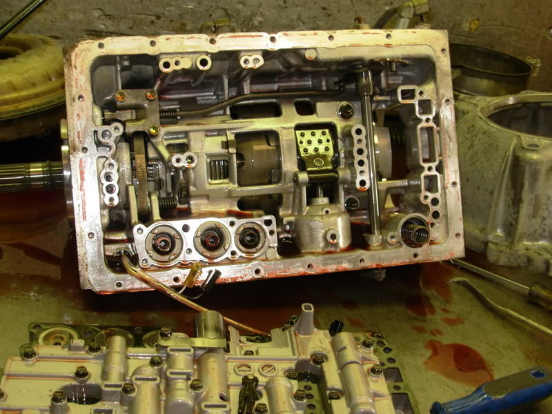

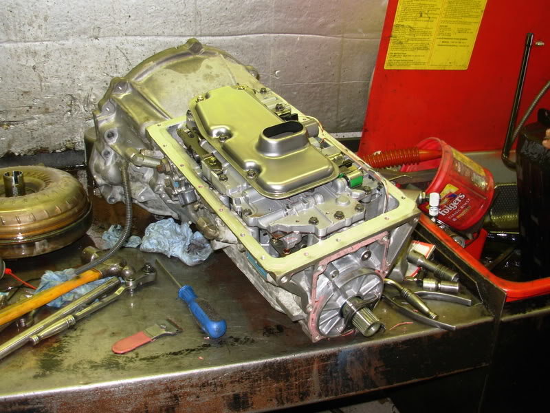

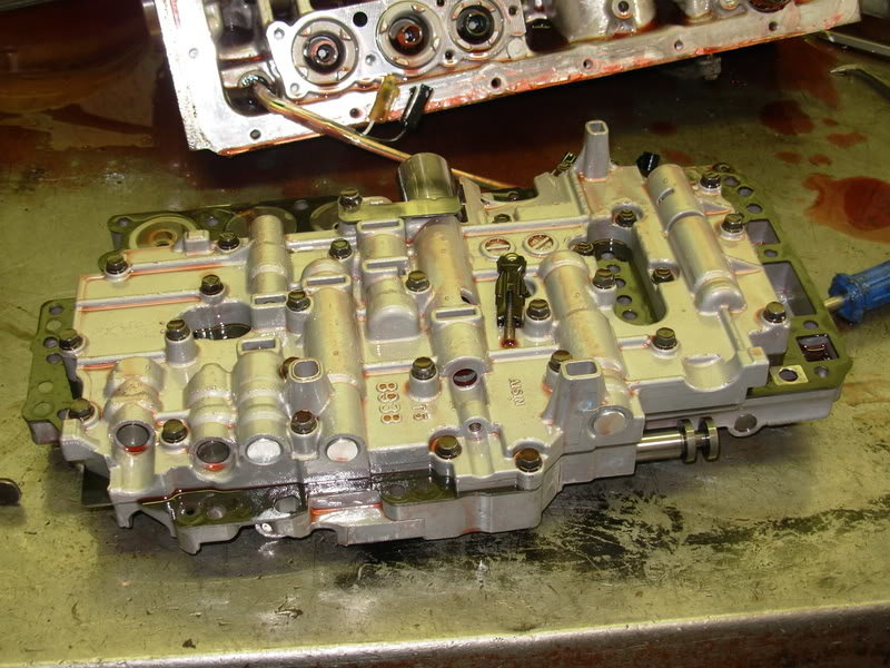

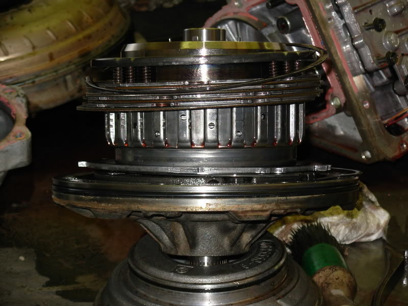

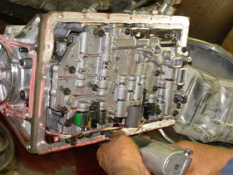

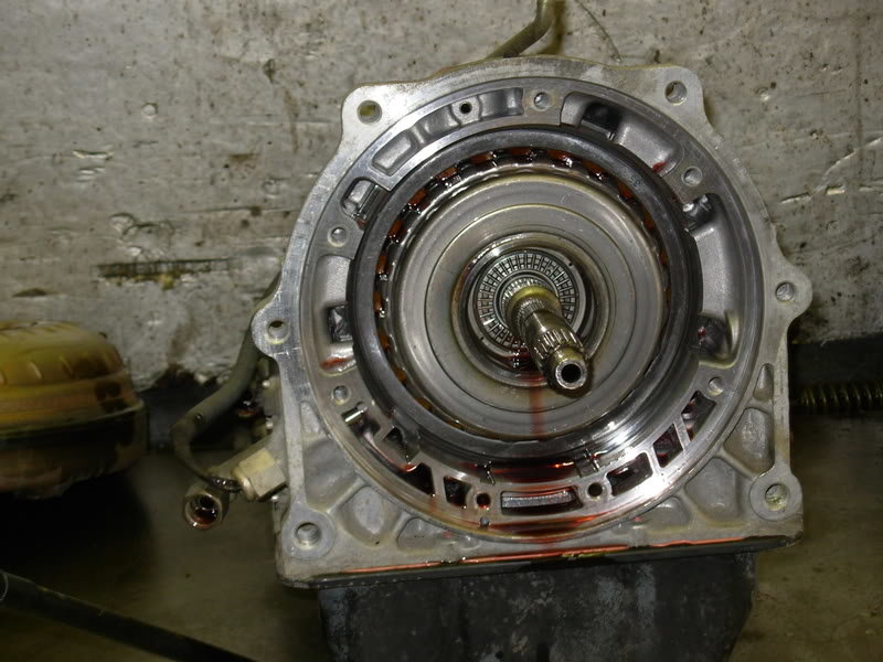

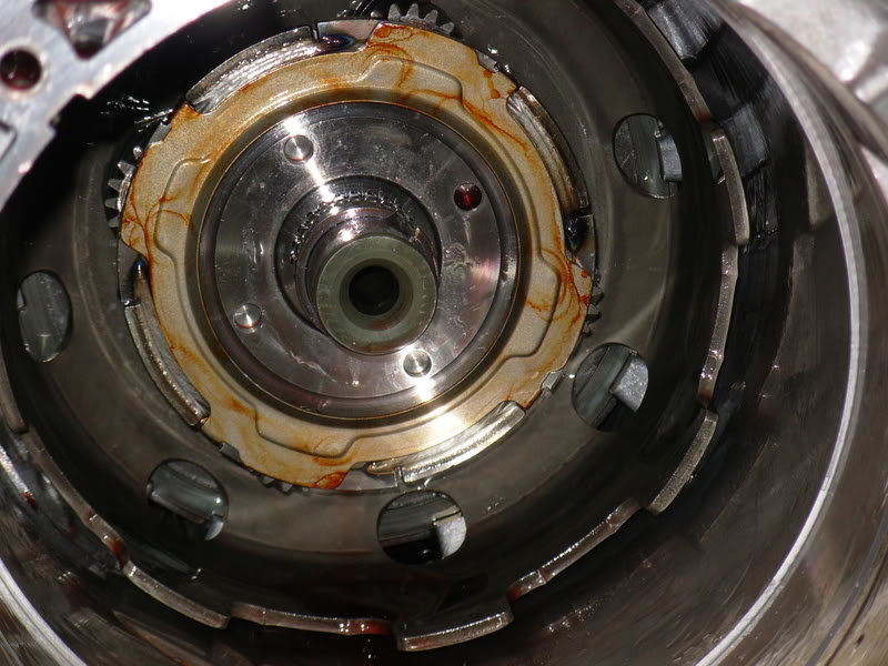

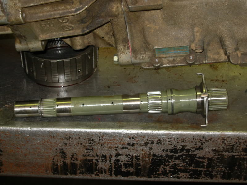

    Bellhousing and pump removed
    some internal parts
    removing valvebody
    without VB

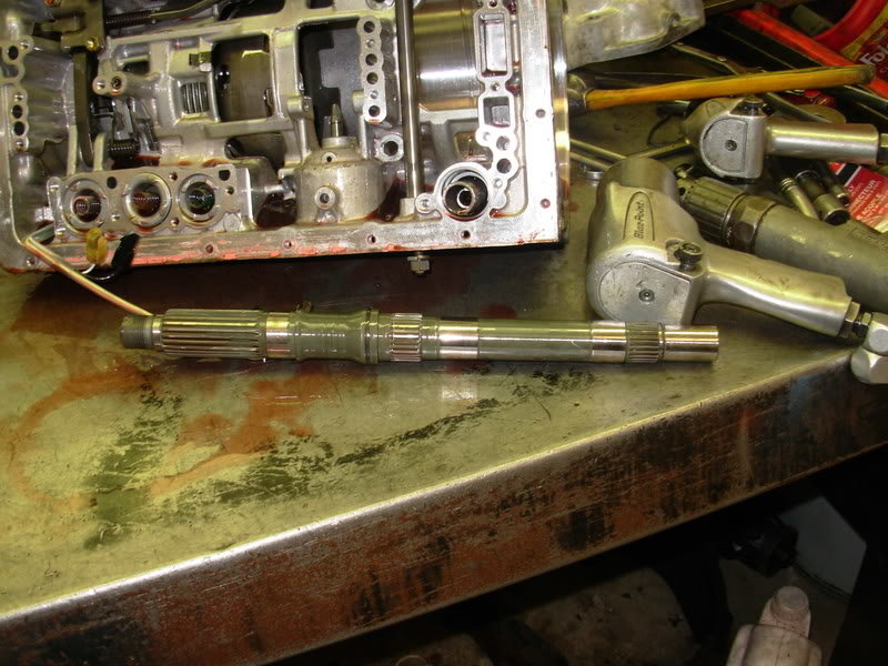

    removing snap ring from output shaft
    all this work just to swap out this shaft
    2wd shaft
    4wd shaft and VB reinstalled

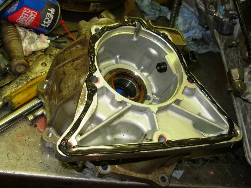

    transfercase adapter thingy

    transfercase and adapter

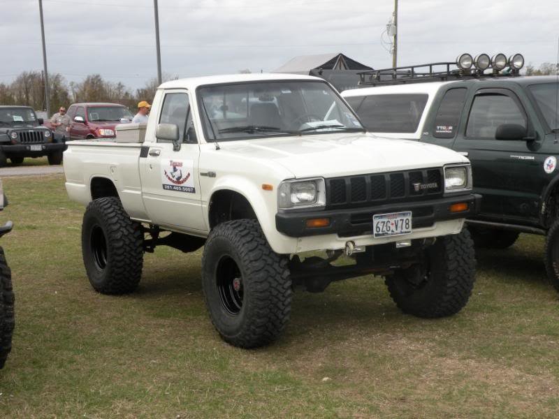

    Yeah, he's always helped me and my brother with our late night projects! lol
    Here's a pic of his 82

    Im planning on doing the same conversion, is changing the output shaft absolutelly nescesary? Or can something be modified to work without dissasembling the trans to that extent?

    You can go with a adapter with a lefty transfercase for about $2350+

    so to make a prerunner trans work you just need to switch adapter shafts? what is the "transfercase adapter thingy" thanks!.. got everything i neeed for the swap just need to figure out what imma do with my tranny, whether it be get a new one or have the shafts swapped...

    Its the back end of a 4wd transmission

    My idea was look for a core at junk yards, you need the shaft and the rear housing portion of the 4wd trans that the transfer case bolts on. As long as the tail shaft and housing are good it doesnt matter if the rest of the trans is bad.
    The transfer case adapter you are thinking of is probably from inchworm, its an adapter to use the prerunner trans with an inchworm transfer case, as far as I know you cannot use a toyota transfer case with that specific adapter
