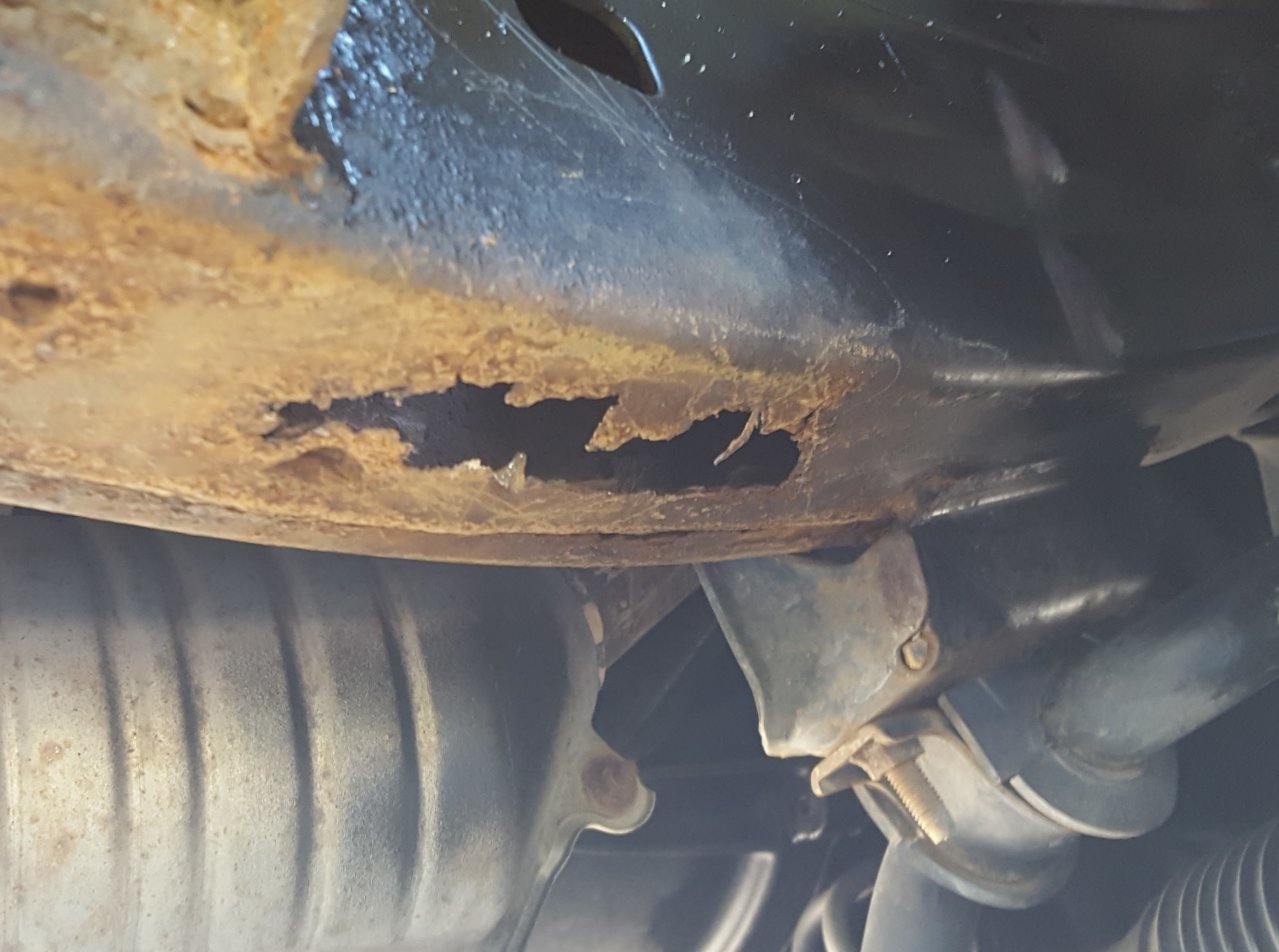

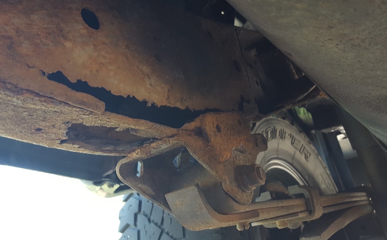

  19. Jul 9, 2018 at 6:02 AM
    #99
    HomePC
    HomePC If it ain't broke, let's fix it anyway.
    Jul 9, 2018
    #258772
    56
    Omaha
    2001 Toyota Tacoma Double Cab Black TRD Off Road V6 Automatic 4WD
    Been following the rust issue. Wanted to share a picture of what a 2001 Taco that has lived in Nebraska for 17 years looks like. Nebraska does NOT require the undercoating, so it was never done. A few years ago I checked out the frame and it looked visibily solid so I never took it in before the 15 year extended warranty deadline. Even if I did I doubt much would've been done. My mistake. I should've took a hammer to the frame. Looking to find a shop to mend the frame. But I'm not complaining. It's my own dang fault for not staying on top of the rust issue.
  20. Jul 9, 2018 at 6:21 AM
    #100
    ghs57
    ghs57 Well-Known Member
    Jul 27, 2010
    #40832
    1,092
    Chops
    Catskill Mts. NY
    '17 Grey TRD OR xtracab 3.5L 4WD
    Pretty much stock right now
    Wow that's pretty bad for a truck from the lower midwest.
    My '03 frame was just inspected, and they were not able to fail it because there were no perforations. This despite how bad it looks on the outside. My warranty is up in late November, so I have one more chance at it. But it really looks like this one is going to hold together. So next year I will be planning to weld on reinforcement brackets and do a though frame repaint/rust prevention job. I was holding off investing any more money in this truck unless the frame was to be replaced. I have also been looking at a few 2nd gen tacomas which fit my price range. But there is no reason to do that just yet. After owning 4 1st gen tacomas, I'm not ready to move on unless I find a very good deal.
