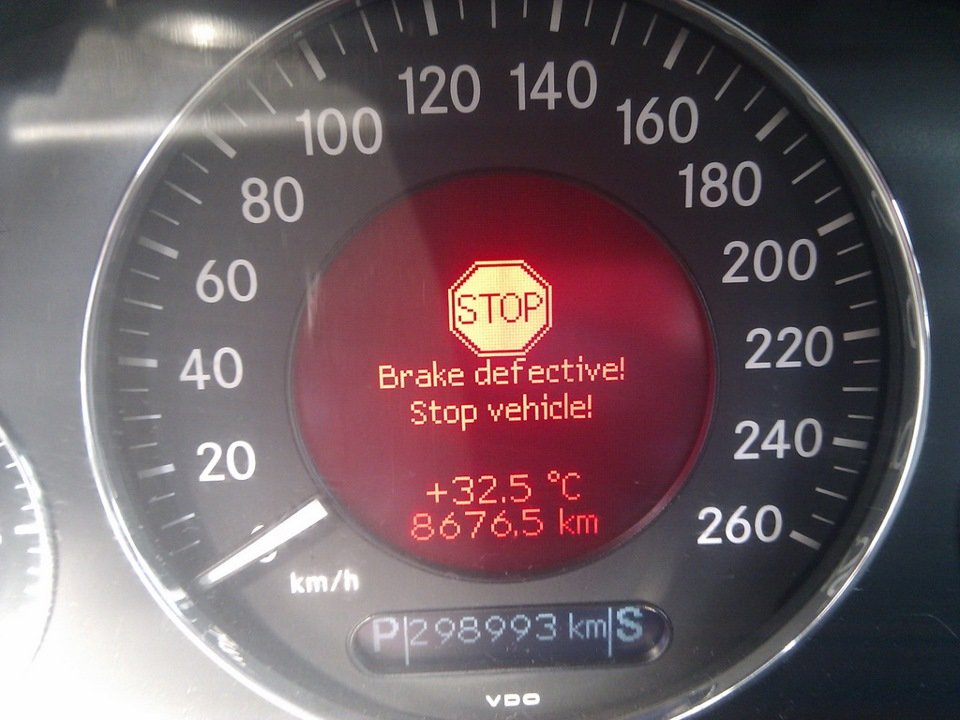

    Hooollllyyyyyy ssshhhhhheeeeeeeetttt you've gotta be exaggerating man? How much does it cost to have that job done at the dealer or shop? You know off hand?

    Around $2-3K
    Pump alone is around $1.5K
    Doing it myself I can find a refurb for about 1K plus my labor. I already have the software which would have been an additional 1K.
    All because the pump is rated for a certain amount of pedal presses.
