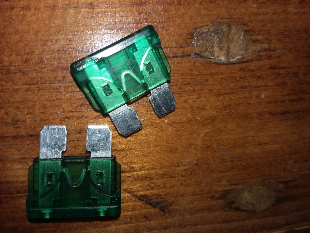

    I found and removed these 2 fuses under the dash. Both were inline, not in either box so I'm pretty sure their aftermarket.
    I can't see anymore fuses under there, but no change in symptoms.
    Any other possible solutions before I see about getting a professional? I banged on the starter and starter solenoid, no effect.

    Those two fuses are way too big to be an alarm. Those are probably for an amp or something else you have installed in there. Did you happen to see a small black box under there that’s probably zip tied to the harnesses with a bunch of wires coming out of it? If there is, try unplugging it.
