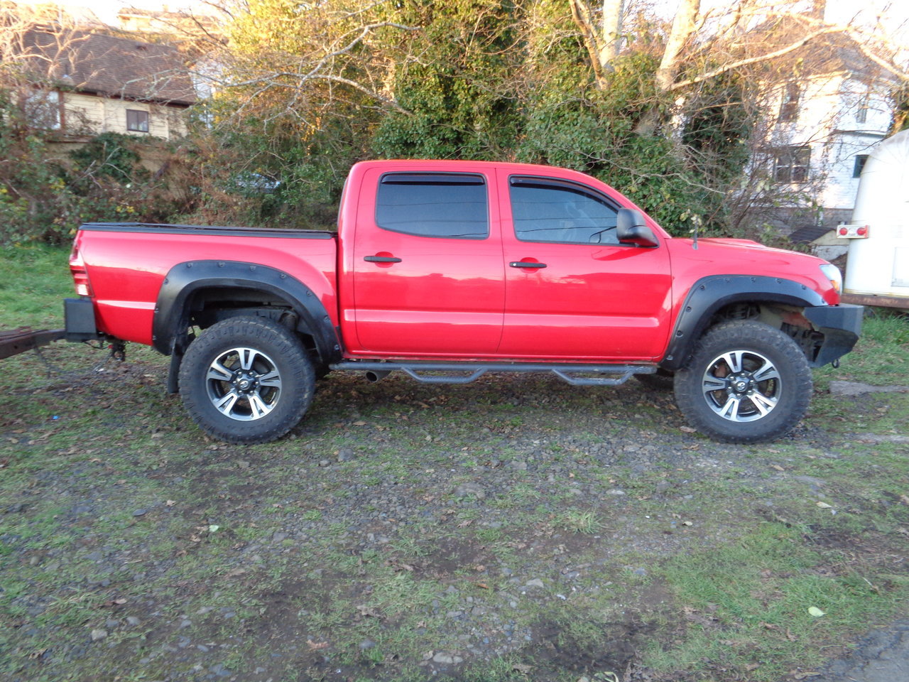

    Well it is the end of the line for me and the 36 Tacundra. I traded for a 06 Tacoma double cab 4x4 4.0 v6 auto with E-locker and 170,000 miles. I kept my wheels and tires and got some cash on top. I text the guy today and he said that the truck felt like a muscle car. He really likes it. I do not have any remorse. It was time to move on. I am putting a 99 tacoma back together with a 4.0 so I am busy. I like that the 06 has more interior room. It also has neat storage behind and below the rear seat. I have looked it over and I think it would be very simple to put a 4.7 in the 06. I want to put a 5.7 in it but who knows If I get another 4.7, I would use it too. hear is the new truck.DSC00551.jpg DSC00561.jpg

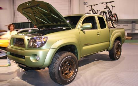

    This SEMA Truck has a 4.7 in it

    Have any links to more details?

    That was a sweet swap on the 1st gen taco! Can’t wait to see what you do with the 06.
