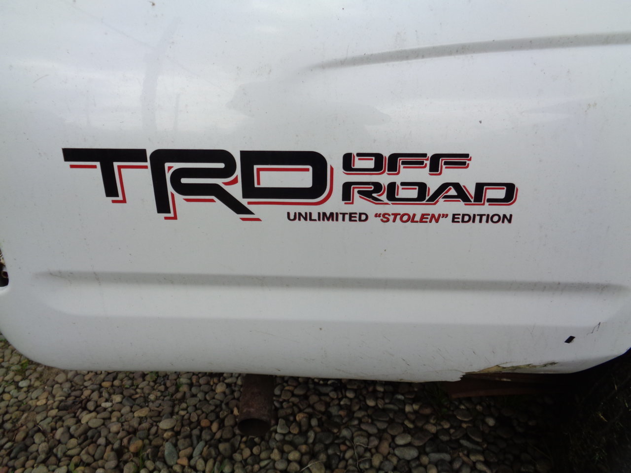

    I got to change the oil in the monster today. It was cool to see it once again. I think It would be cool If I had made the skid plates line up with the drain plug on the 4.7 oil pan. I still took them off to keep oil off of them. Here is the first trd decal I had made for the 03. The short box had been extended ten inches to the rear. So I had the decal made 3 inches longer and a half inch taller.

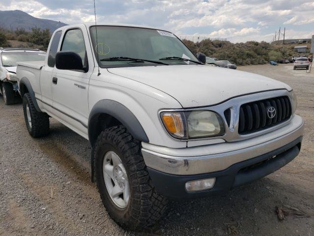

    Cutting to the chase, I'm an old geezer whose all-time favorite pickup truck shape just happens to be a first-generation Toyota Tacoma with the extra cab option, as opposed to the far more common double cab variant. Found one for sale on Copart, and have posted a couple of pictures showing the specific Tacoma model and body style that ticks all the boxes for me. Buying this vehicle online and sight unseen is indeed risky, due to the well-known chassis rust issue that can only be checked visually and up close, but I am prepared to roll the dice on such a buy.
    Cutting to the chase, I dream of converting this stock V6 powered chariot into a fire-breathing, offroad trail-scorching V8 wolf-in-sheep's-clothing, by dropping in a drive-train based on the 4.7 V8 transplant that has been kindly detailed by 36tacundra over the preceding pages. The procedure for this conversion does appear to be a daunting challenge for a person like me with very limited mechanical skills, however, I do happen to reside way out in the sticks where mechanics and welding service labor charges are affordable.
    Cap in hand and with the utmost respect, I would therefore like to ask whether 36tacundra might be kind enough to publish a master list of all drive-train components used to complete the V8 Tacoma conversion described here so that a novice like myself could save lots of trial and error by following the path already blazed, as it were. Similarly, if there is a means of identifying the new locations required for engine and transmission mounts in terms of measured distance from the inner surface of the vehicle frame's longitudinal beams, I would gladly pay for such a template.
    I am very much aware that the easier and quicker option would of course be to buy a Tundra with a V8 powerplant, but I am really drawn to the idea of achieving a higher thrust to weight ratio, by transplanting a Tundra V8 into the far lighter Gen 1Tacoma Etra Cab body. I have taken copious notes while reading the details of this conversion described here, but a conversion parts shopping list made out by the wrench-meister himself would be enormously appreciated by this soon-to-be Tacoma First Gen owner.
    Much thanks in advance for any pointers that can be offered. Finally, I must ask how this converted Tacoma runs currently, a few years after this V8 engine swap was made, assuming of course that the truck hasn't been sold off to a lucky buyer out there.
