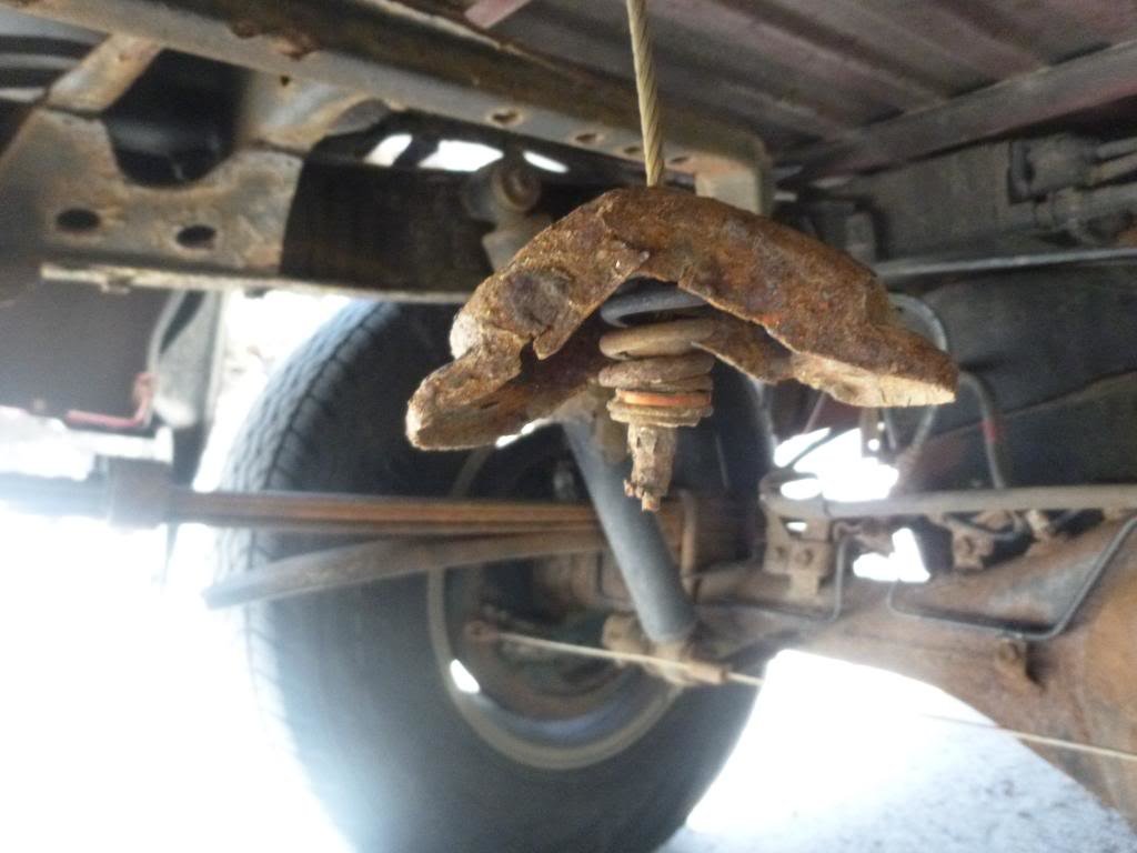

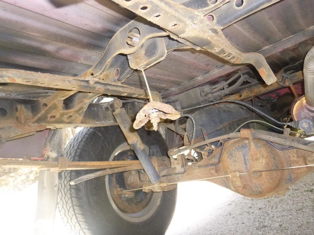

    Here is a couple of pics so you can see how the plate is rusted and bent.

    How the hell could that thing fall off without you noticing? I think someone snagged it dude.
    Regardless, that rust is insane.

    Well if your going 65mph and it drops straight down and your gone from under it in a flash. How would you notice it? Especially if it is night time. If it was daytime I would have thought I would have heard people behind me spinning out and beeping their horns etc. No clue when it came off.

    What part of the country do you live ? Im shocked at the amount of rust in the pics.

    Steel wheel for the spare. It seems to me if the tire just "fell off" I would think there would be marks on the bracket that goes through the center of the wheel. I'd lower that metal bracket down, inspect it and snap some pictures. If the wheel did indeed fall off while driving I'd be counting my lucky stars that it didn't injure or kill someone.
    That rust is insane. Is the rust eating away at your shock body too?
