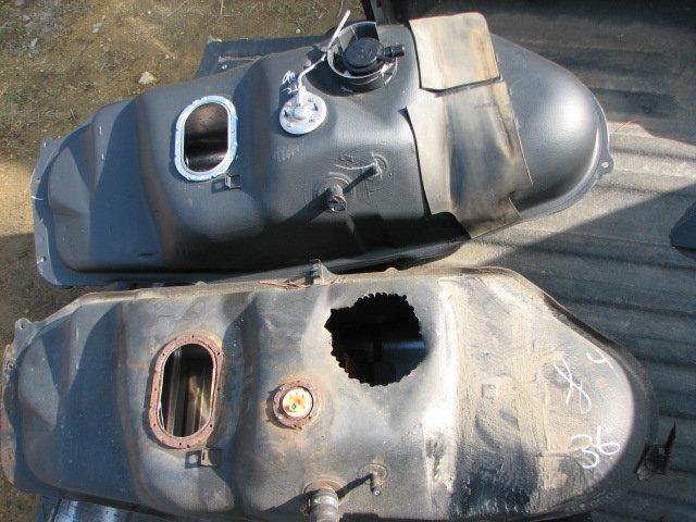

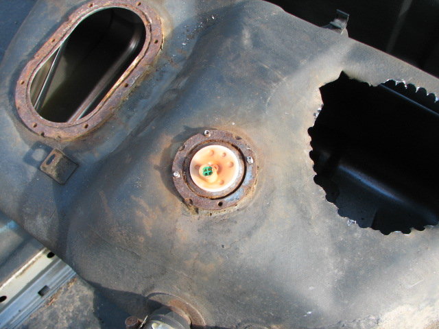

    A smoke test showed I was leaking around sender assy. Looking at the tank from the outside will not tell you anything about the rust under the seals.
    The first photo shows a new tank that I just about to put in, the bottom shows my leaky tank. From the outside both look rust free. BUT once you pull the seals you'll see the pitted rust. It is not a light skim of rust you can sand off.
    My new tank seal surface has a smooth polished finish and has to be this way for the seal to make a firm occlusive seat. You can see just how pitted the old tank surface was in the close-up.
    If this was a 70's or older car then I would have re-used the old tank, just sand and use alot of thick sealer but that won't work with todays' pressurized and EVAP system. Tacotank1_3b8d2dc3984fd8a14072a7dc6d50ae3082f3cb0a.jpg
