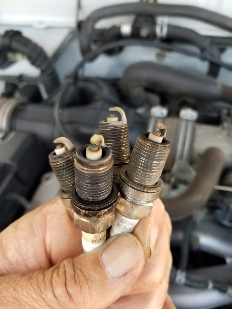

    I highly doubt that the plugs I pulled here at 140,000 miles were stock...
    They were Bosch Super Plus FR8DCX+
    The one up front in the attached picture with the darker staining I felt was a tad loose.
    I replaced with the Denso K16R-U11 that the dealer sold me.
