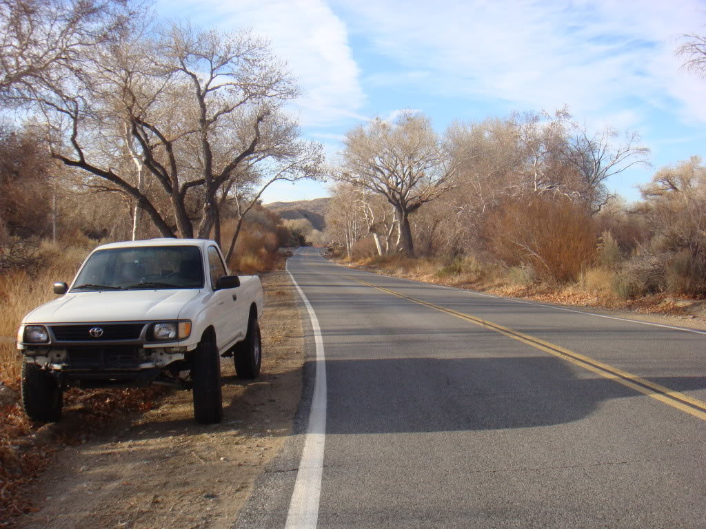

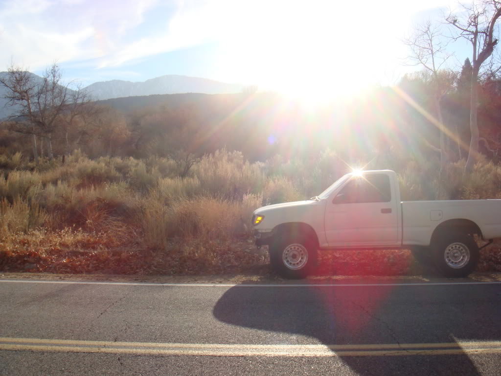

  4. Mar 3, 2012 at 12:53 AM
    5LUGTACO
    5LUGTACO Gear Head
    Aug 27, 2010
    #42323
    663
    David
    California
    06 TACOMA 5 LUG
    Total Chaos Mid Travel, Sway away coilovers,31x10.50x15 goodyear wrangler authority's
    This is my old tacoma with doetsch tech spindles, downey off-road mid travel kit, and 31" tires. There are plenty of options for the 1st gen tacoma's. Its the 2nd gen 5 lug taco's that have a problem of limitations.
