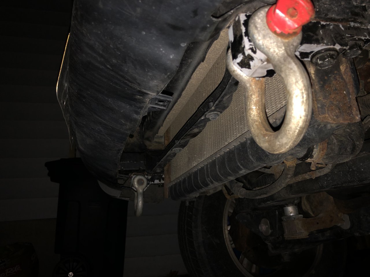

    Installed my old D-ring shackle mounts from the 4Runner in place of the flimsy oem shipping hook points. Now I have a solid recovery point at the front.

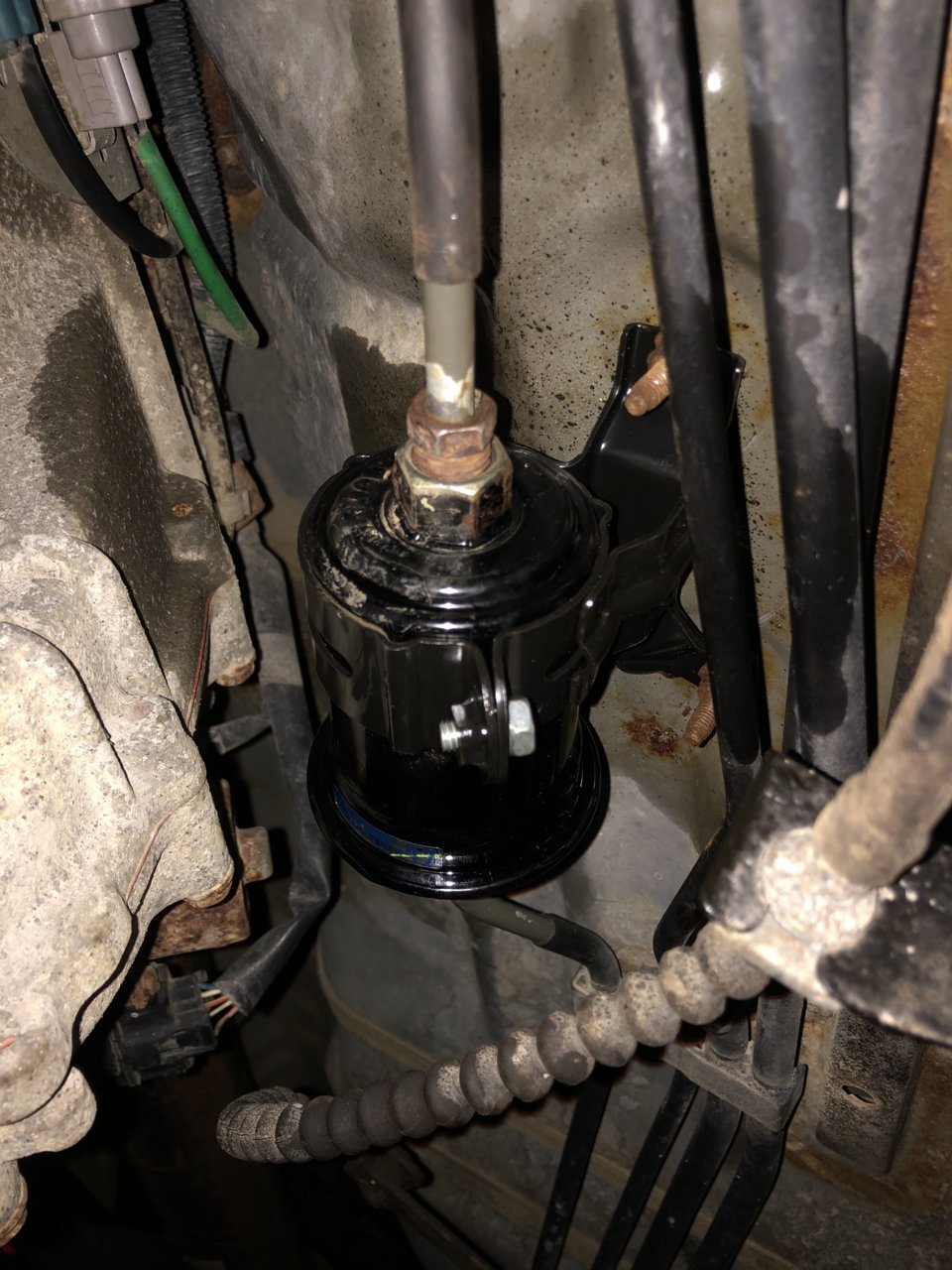

    Also changed the fuel filter with an oem unit.

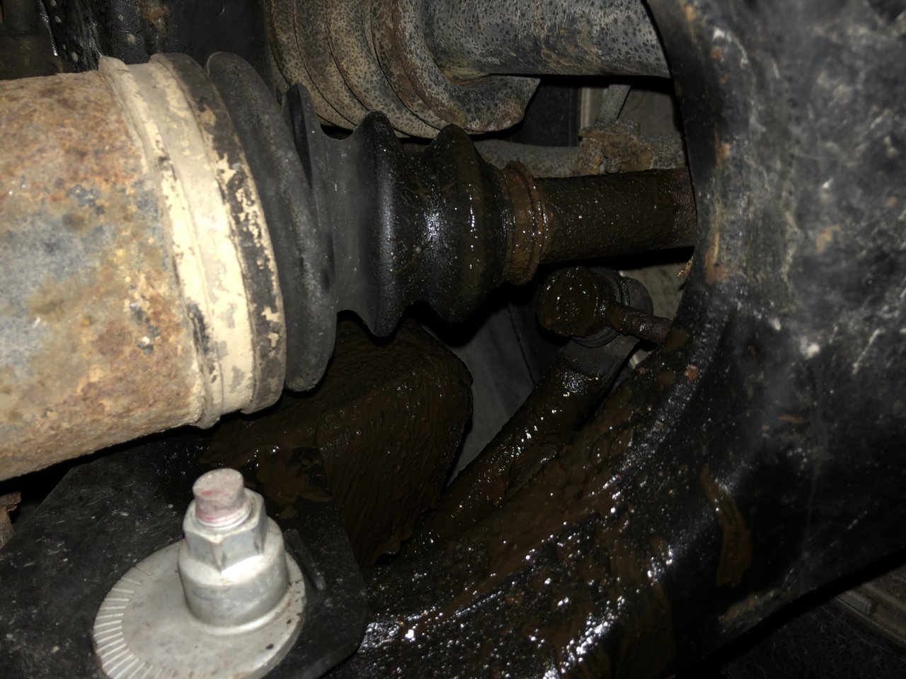

    This thing keeps on giving. The drivers CV inner boot decided to explode this weekend and I found the front sway bar bushings barely hanging in there as well.
    After sitting for awhile, it acts like it’s isn’t getting fuel and stumbles when starting. Hopefully the filter takes care of that because there was much more resistance when I tried to blow through the old one

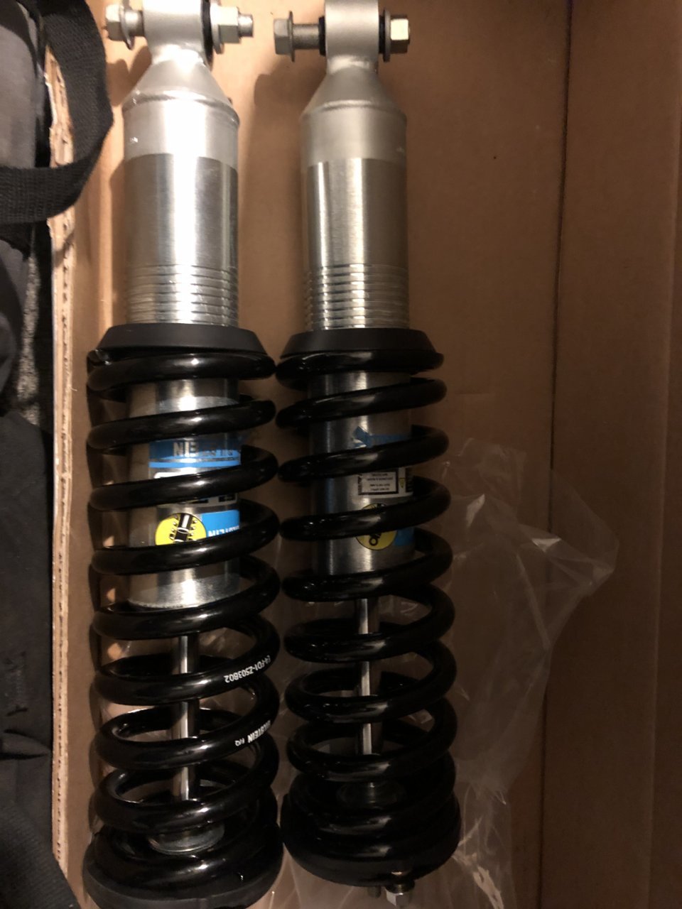

    Ordered up a pair of bilstein 6112s for the front to replace the oem shocks with the 2.5” poly spacer. I decided not to cheap out because after spending $200 on 5100s and another $180-$200 on lift coils it would make sense to spend the extra $200 and take a big step up to the 2.5” body 6112s that I ran on my 4R.

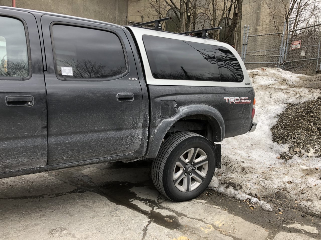

    I got a used silver Snug Top Super Sport with Thule tracks and tower/crossbar setup for very cheap.
    I will look to "restore" it because it spent the least 17 years in the northeast. The rail clamps and latches are very rusted.
    the carpeted interior could use a spray cleaner and hand brush scrubbing.
    The bottom bulb seal is very compressed but no cracking or dry rot
    The previous owner just spent $800 (insurance money) on a new back glass assembly.
    The fitment is incredible. The seller was kind enough to help me install it. Once positioned, we each pulled down on one side and it literally snapped into place.
    Now I realize how bad my tailgate is tweaked. The outward bow keeps the back glass from closing and now I have a ratchet strap holding the glass shut.
    I need a black tailgate asap

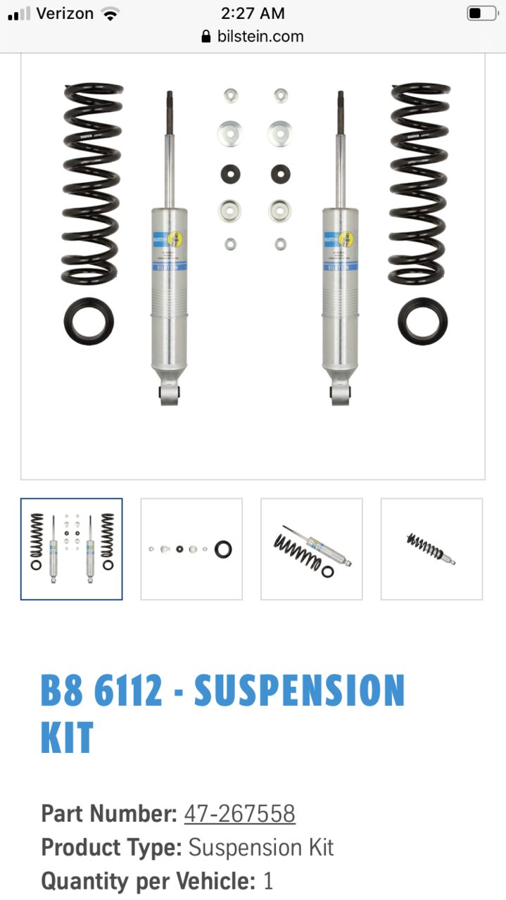

    How'd you like these shocks? I want to stick with Bilstein, was also going to upgrade the rear with these (BILSTEIN 25248692 B8).

    I haven’t installed them yet as I am waiting on more front end rebuilt parts.
    I had the 6112s in my 3G4R and loved them.

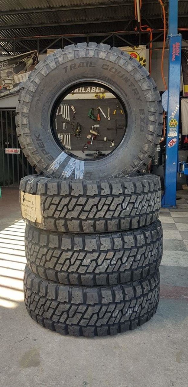

    Order a set of 265/75/16 Dick Cepek trail country exp for the stock wheels
    $572.11 to my door
    The Firestone’s are dry rotted and hold air for about 5 days

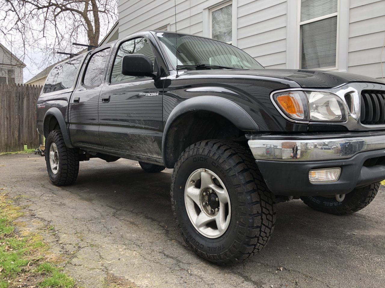

    1,032
    Installed new 265/75/16 Dick Cepek Trail Country EXPs, installed the 6112s at the 8 and 9 (of 11) positions, and installed oem LBJs
    cruiserguy likes this.
