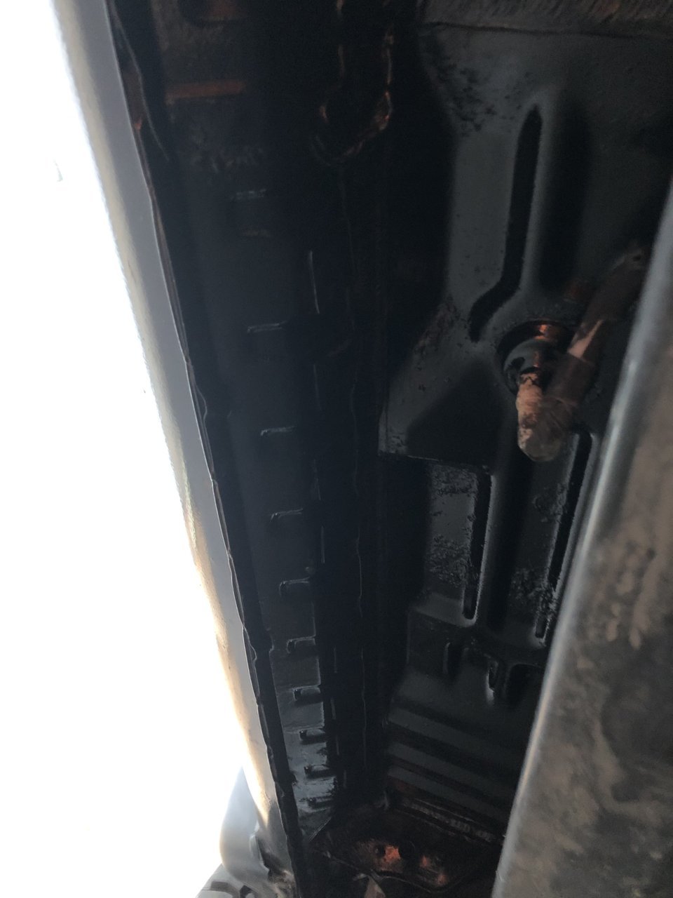

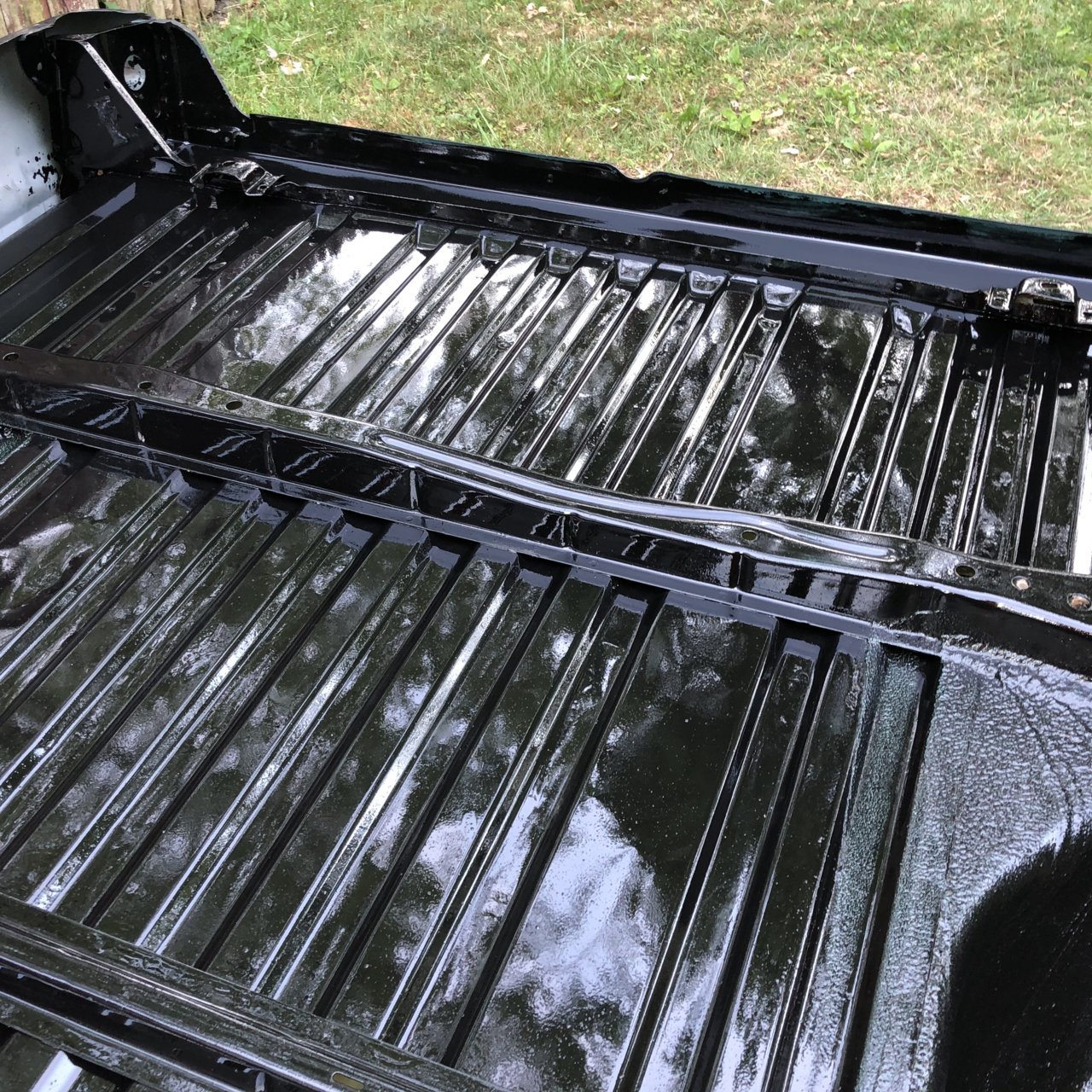

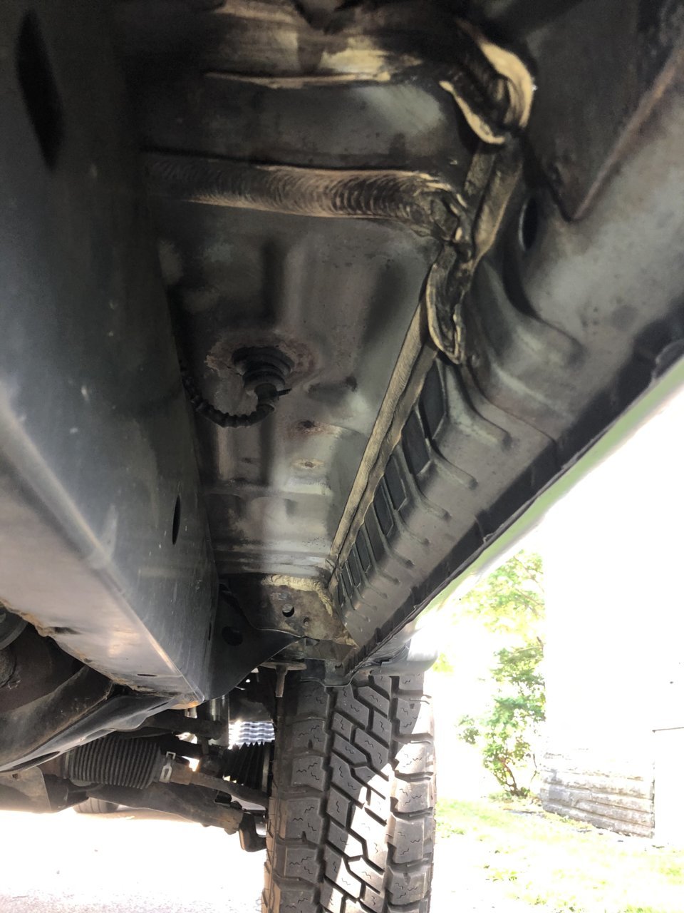

    Another maintenance day
    Transmission pan drain and refill with Toyota T-IV
    Mounted B&M transmission cooler behind the grill.
    Awaiting the new radiator and then I’ll plumb it in.
    Fixed the canopy hatch
    Wire wheeled, scrubbed with mineral spirits, and applied POR-15 to the lower cab and body mounts as well as the underside of my new bed. I took before photos to prove I wasn’t covering rust if I ever sell it.
    Next weekend I will hit it all with a second coat
