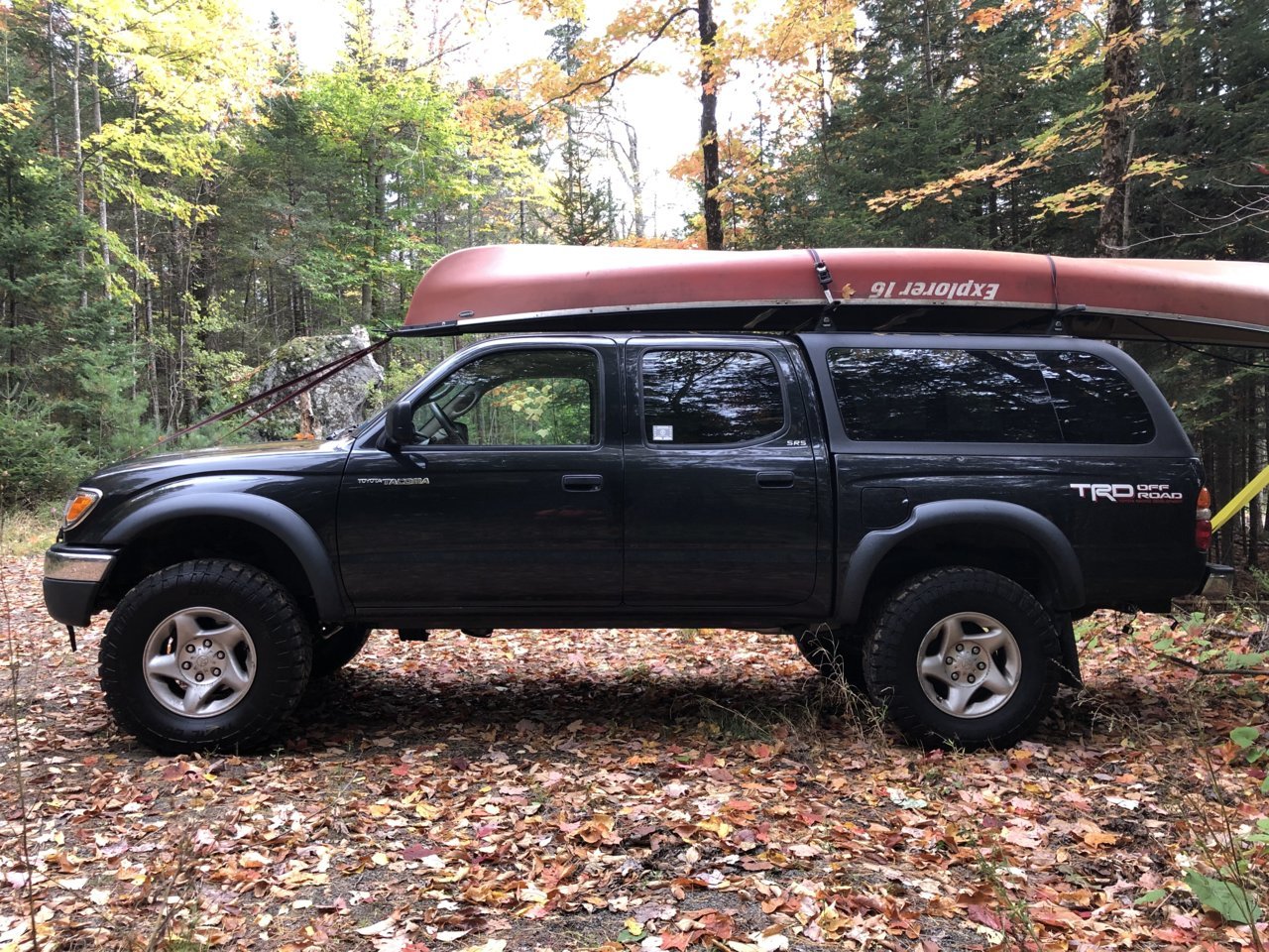

    I am very impressed with how the stock leaf springs handled the weight of the topper, canoe, paddling supplies, fishing gear, and all luggage, gear for a camping/hiking weekend for 3+dog.
    there was probably 500lbs of additional weight.
    I also hit a deer on the way home yesterday around lunchtime.

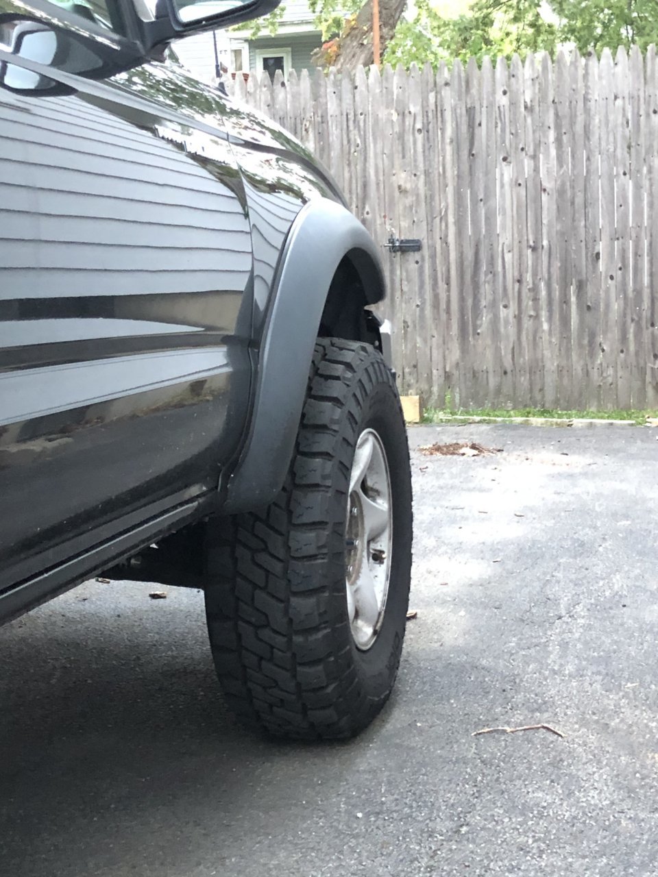

    I have started saving for the original plan of some 4:88 gears and an ARB rear locker. After that, some "cheap" 33's like the yokohama geolander MTs which are currently only $700 for 285/75/16. I want to be able fully load this truck and still be capable.

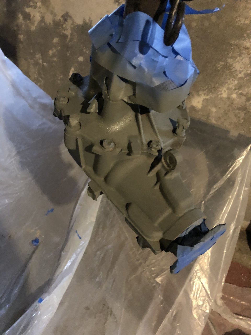

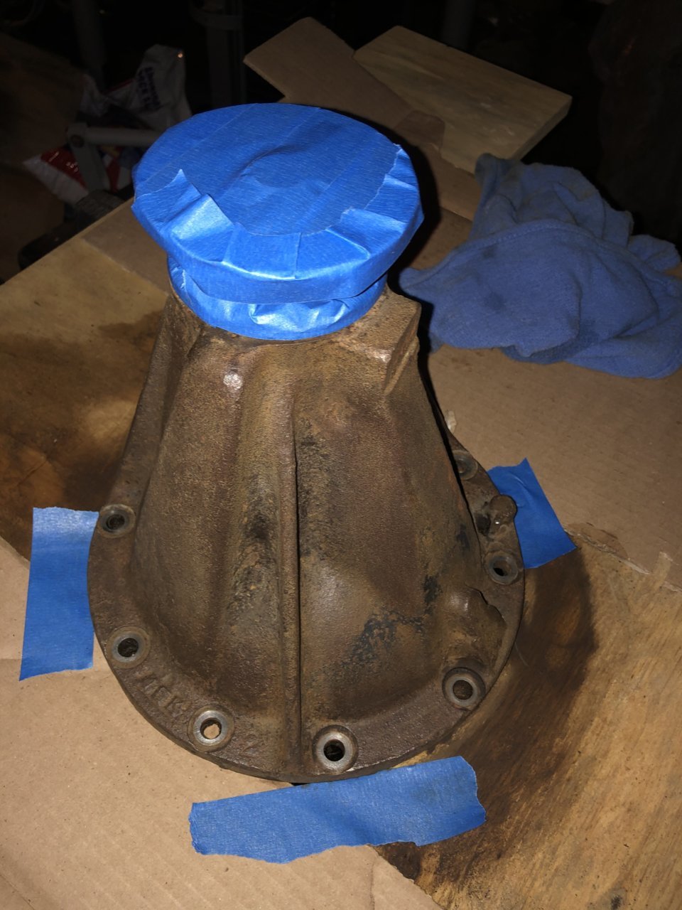

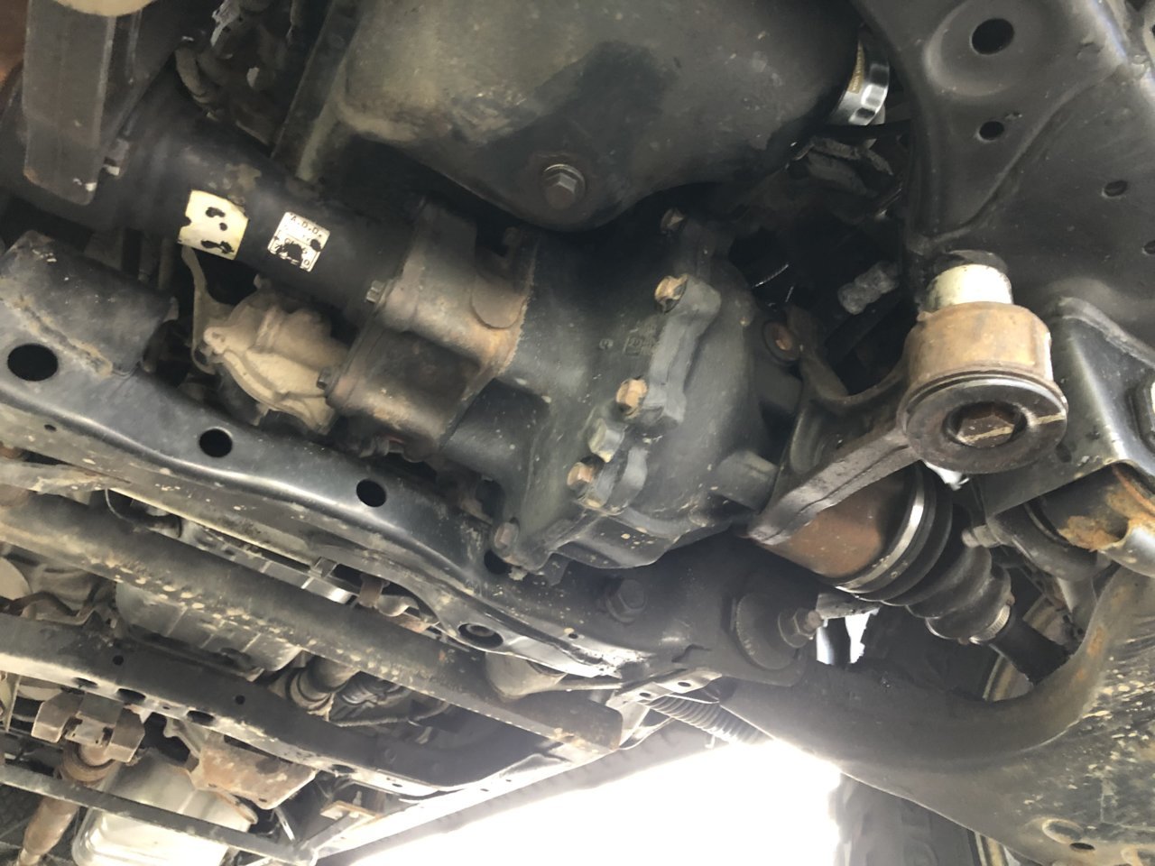

    Replaced the diff breathers and bought a junkyard 4.56 add front diff.
    I decided $300 for an oem toyota geared diff compared to $1,500 for a rebuilt one with ARB is worth the money.

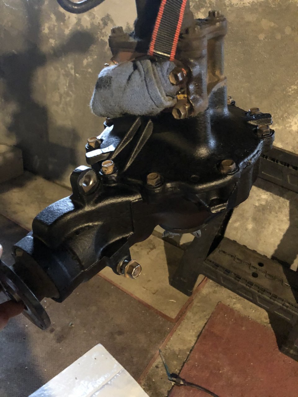

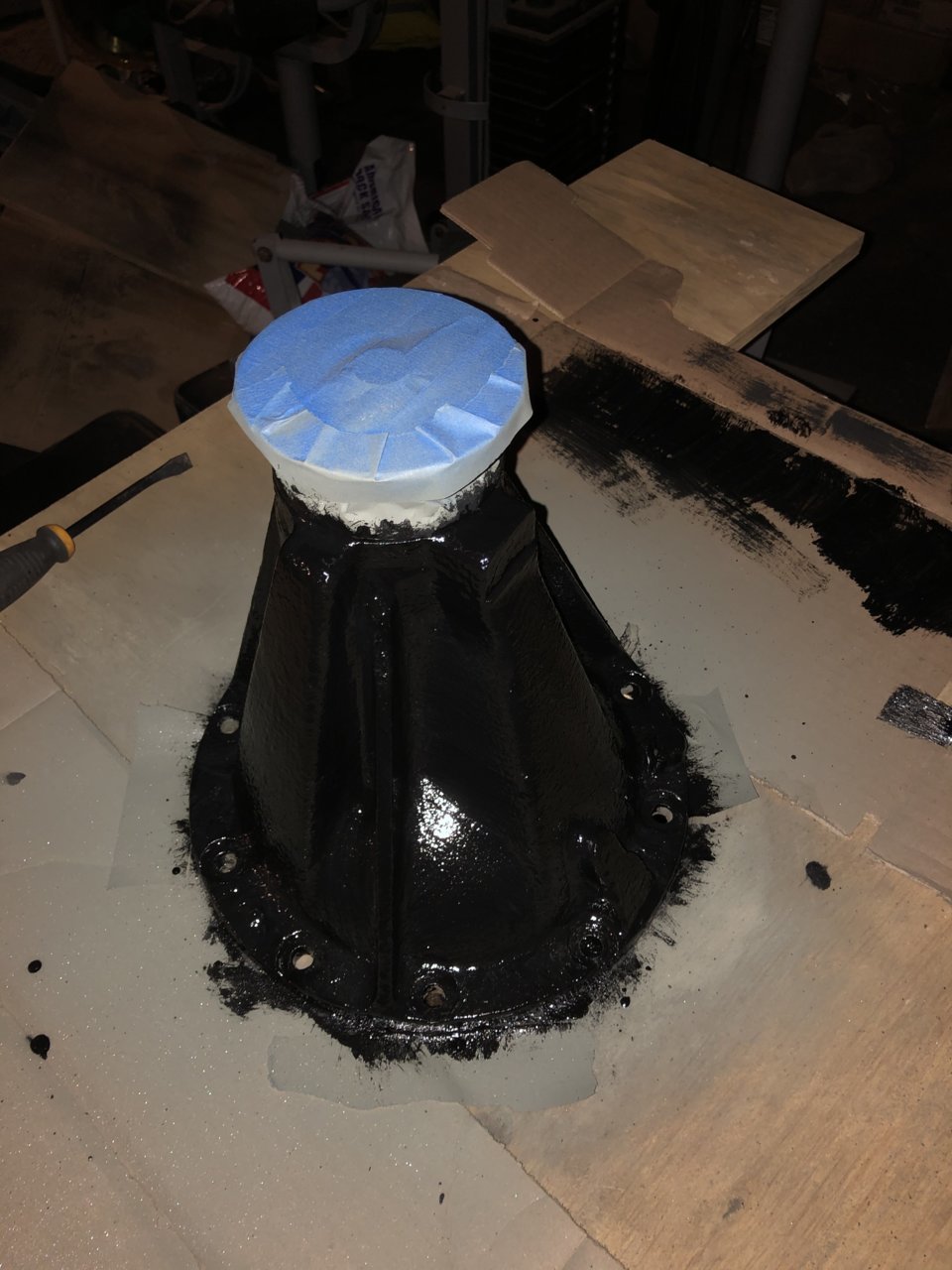

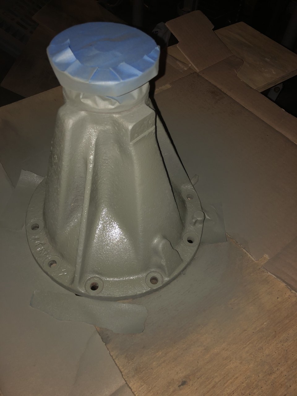

    I got both diffs cleaned up and painted

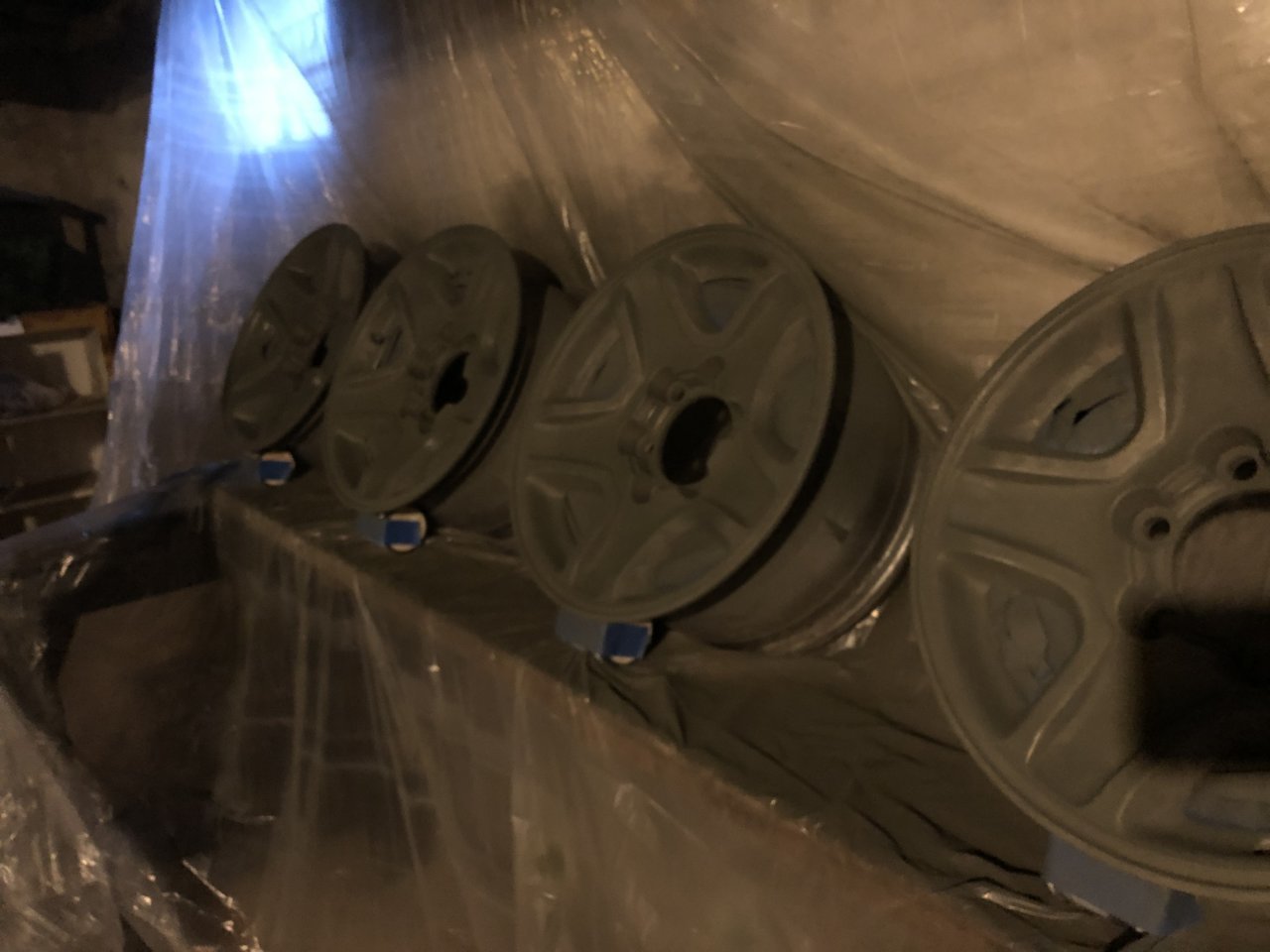

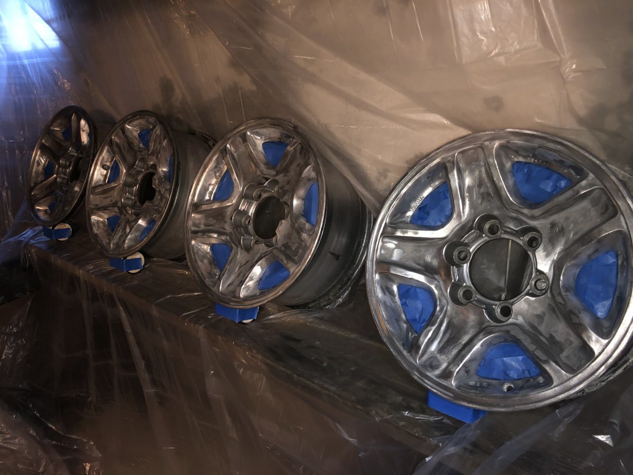

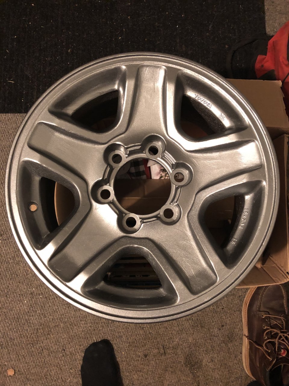

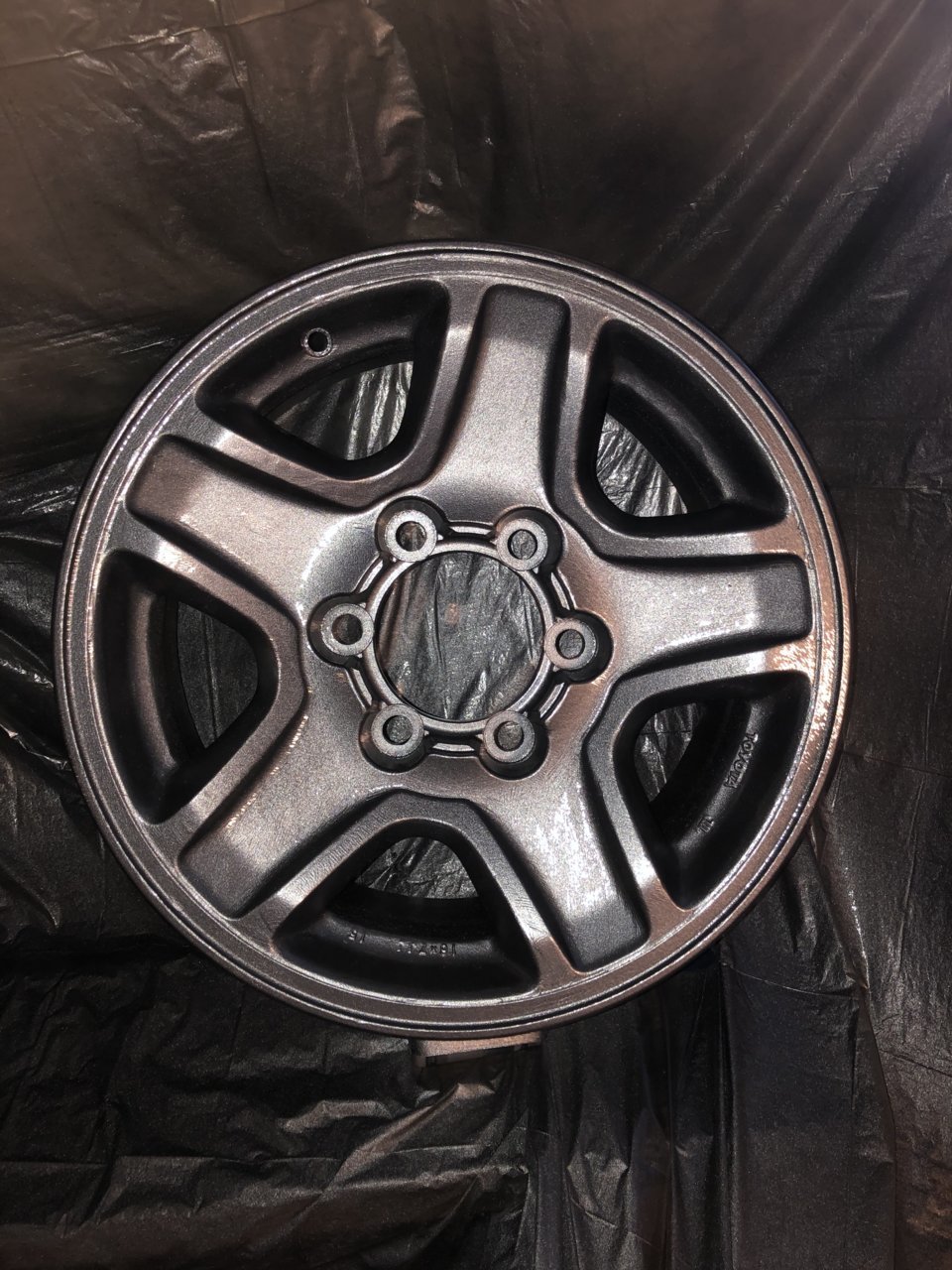

    I got the wheels prepped and painted.
    They don't look terrible for the amount of corrosion and pitting them had.
    $30 in paint and a full days of work in total and they look presentable.
    I was going to have them powdercoated but the cheapest quote i got was $550 for the set and at that point i would get a set of 2020+ trd pro wheels

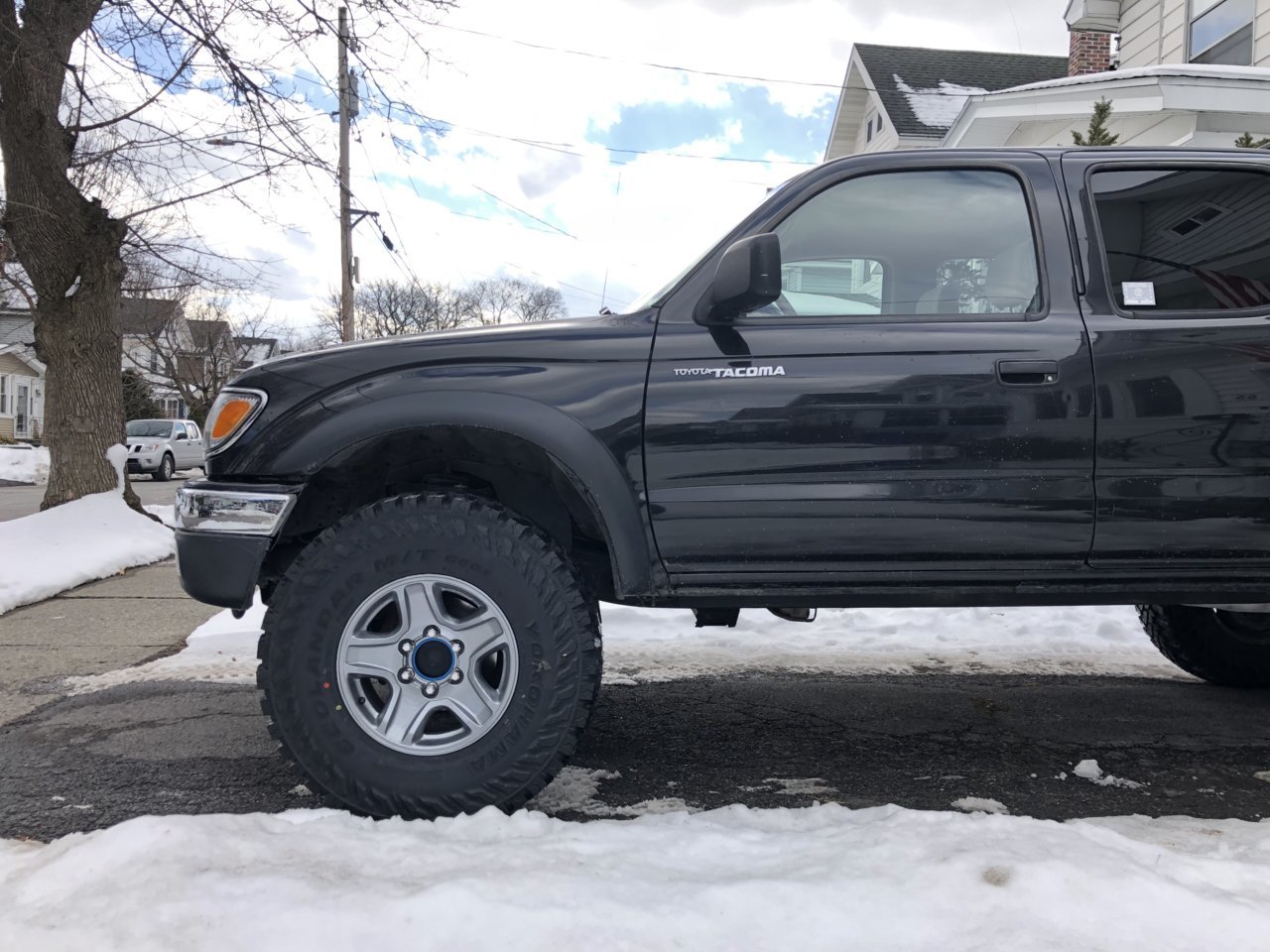

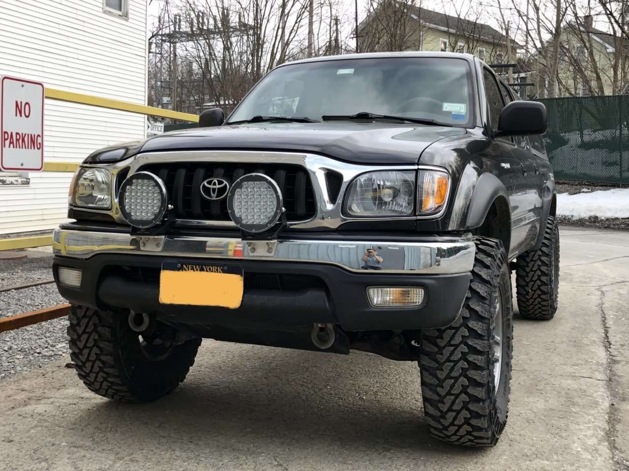

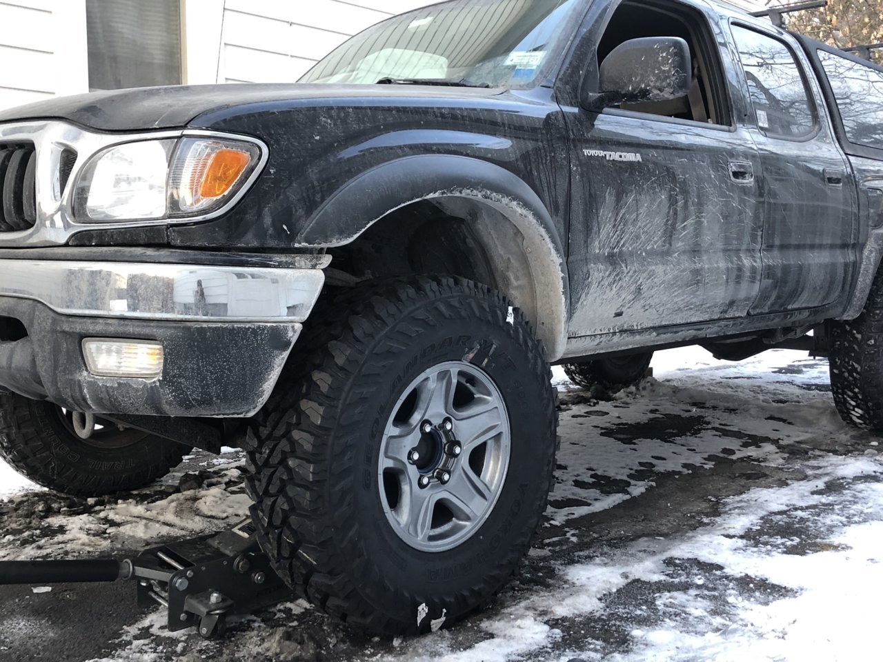

    Raised the Bilstein 6112s to 11/11 drivers side and 10/11 passenger side. Trimmed a little plastic test fit the 33s
    ordered a set of Primelux 8” LED spots 28,800 Lumens combined

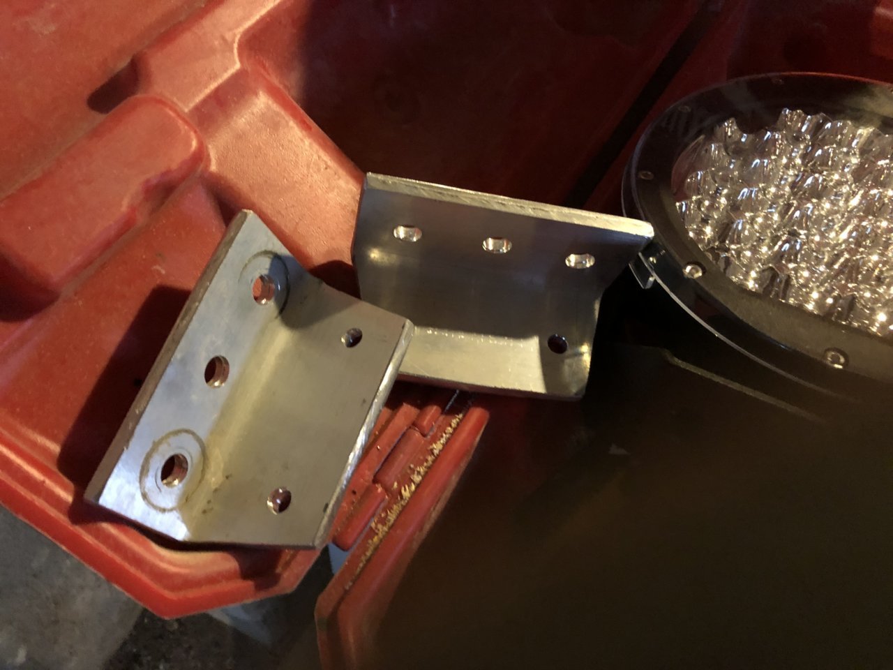

    I made some mounts and installed my primelux 8” spot LEDs. Wiring job complete with the required bloody knuckles

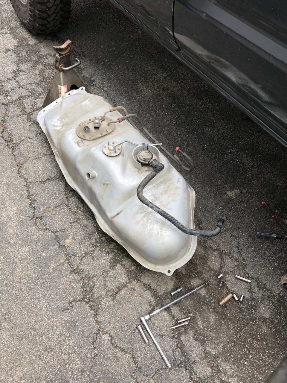

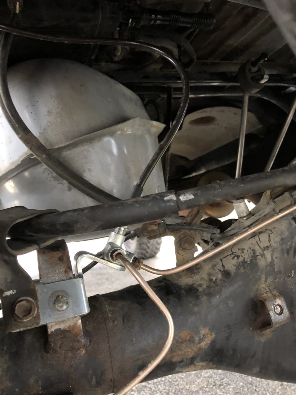

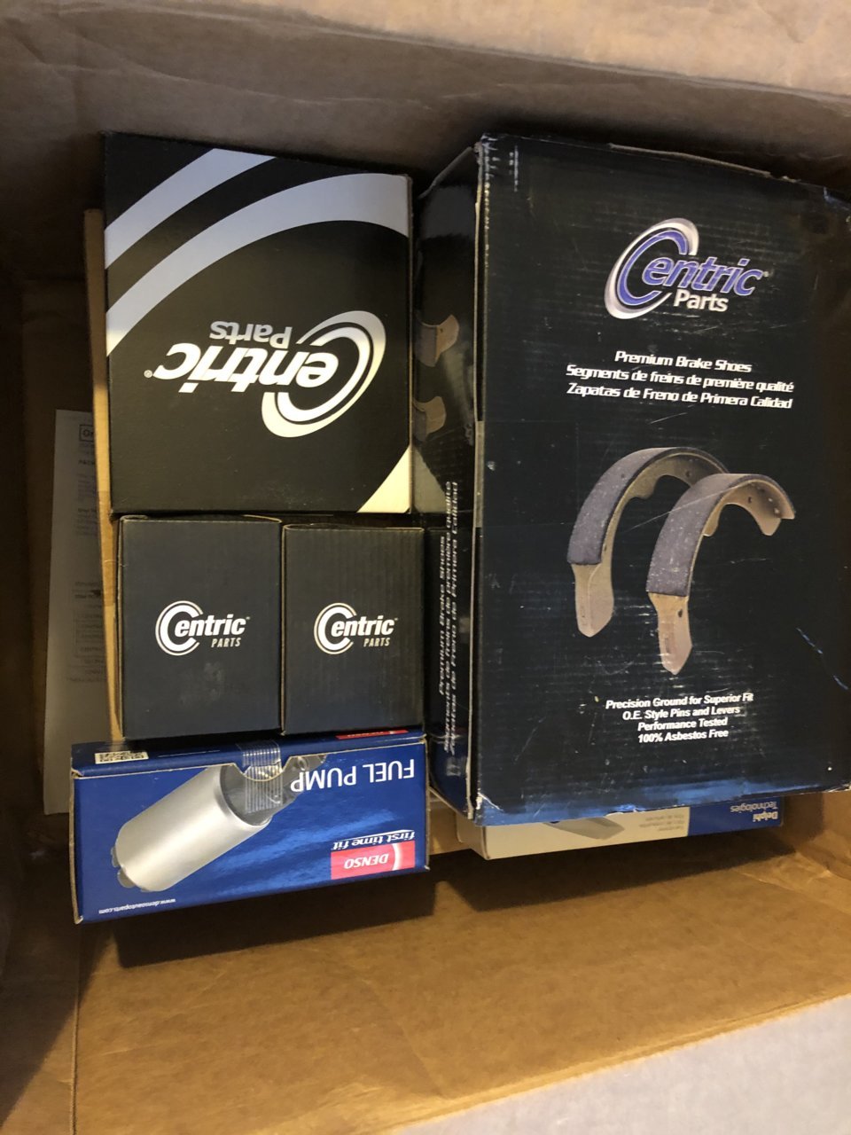

    Got the rear brake hard lines replaced, wheel cylinders, oem t-fitting and extended rear brake line changed.
    Last night I changed the fuel pump.
    Hopefully that takes care of the warm engine cranking/stumbling issue.
    A few weeks ago I got the 4.56 front diff installed. Hopefully next weekend I can do the rear diff swap
