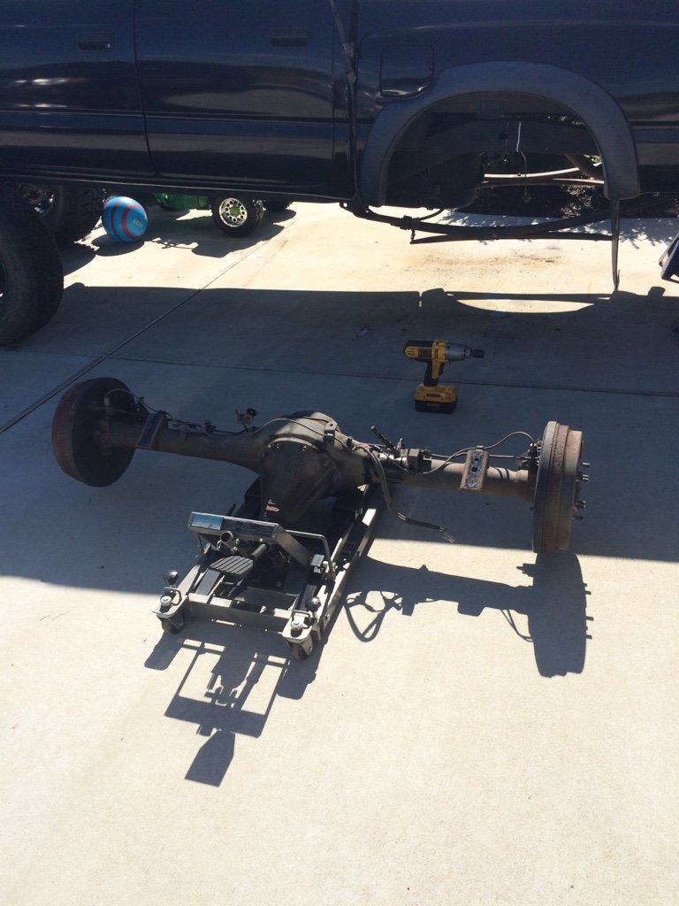

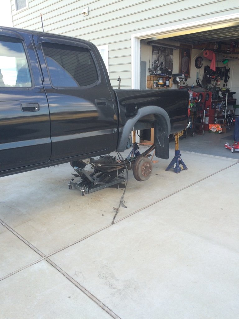

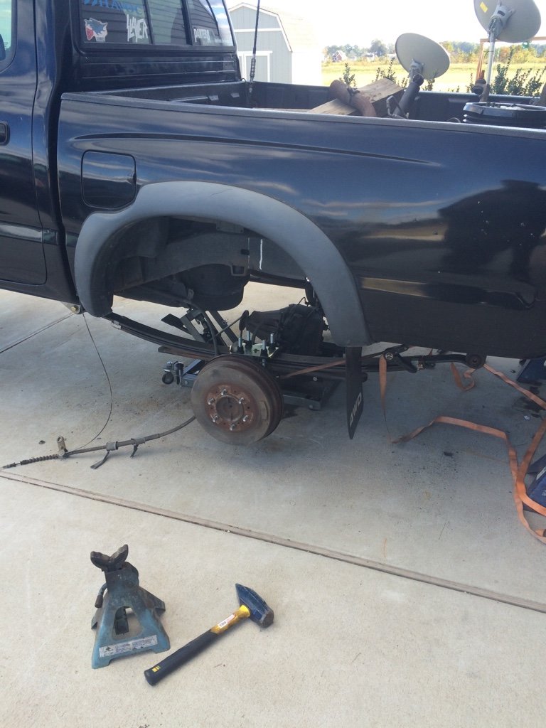

    Had some decent free time this weekend and the weather was nice. My buddy helped me get the Chevy springs in. I just have to weld the shackle mounts this week. I added my 1-1/4" spacers on the front. She's getting there not much longer. Still have to re-gear the rear and slam the t-cases in. a0557f0e6067d627183753dca2e18086_abd25e6c537cba894738e2517fed48a4cafaf236.jpg2a438d111f8f6ce4ca562e61db7da7e3_5ad6f0d2ed9ab92183d55c8071a0c3052b3e6bad.jpg808291e631f49595dc24cef0b973be66_267b5b064e22ed47866018d844144c05670895f6.jpg1c8141bd62ba80274b767704186f321b_6ba7e4350ea839ec986963371e4631700d66b982.jpg

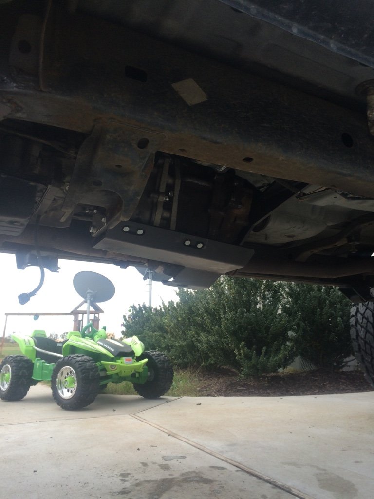

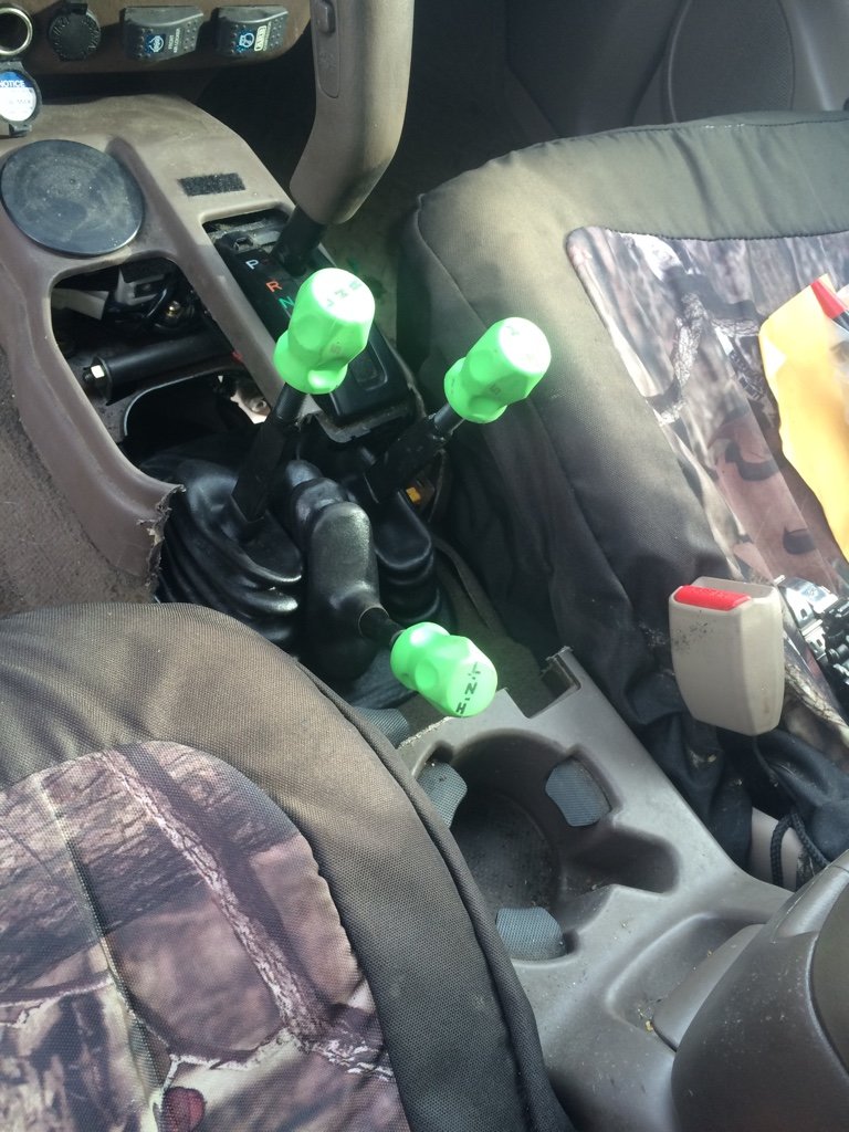

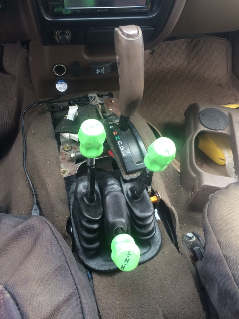

    Spent the day putting the cases in a working on some little stuff. Was hoping to put the front drive shaft in today but the flanges are a bit different. Does anyone know if the flanges from the stock case will fit onto the gear drive cases? If not I'll have to re drill them to work. 83598cb0f3256c3c2b879197a1cacf61_055eee4ee13b5cd59f16f10fabe890106012a7b5.jpg70c398ecaaa5d974588d3f5d12756e5e_f86e926dca3047fbb37fb38b6b3fd8aed77fa408.jpgb3a2325ee105077d1d7f05726e41f4ad_d4aa3132979876683bad549ac5da366d0afa0714.jpg

    Bump, did you ever get this finished up?

    Yes I did. Its been on the road for a few months now. Ive been meaning to add some new pictures. It passed state inspection and with an alignment she runs pretty good down the road.
