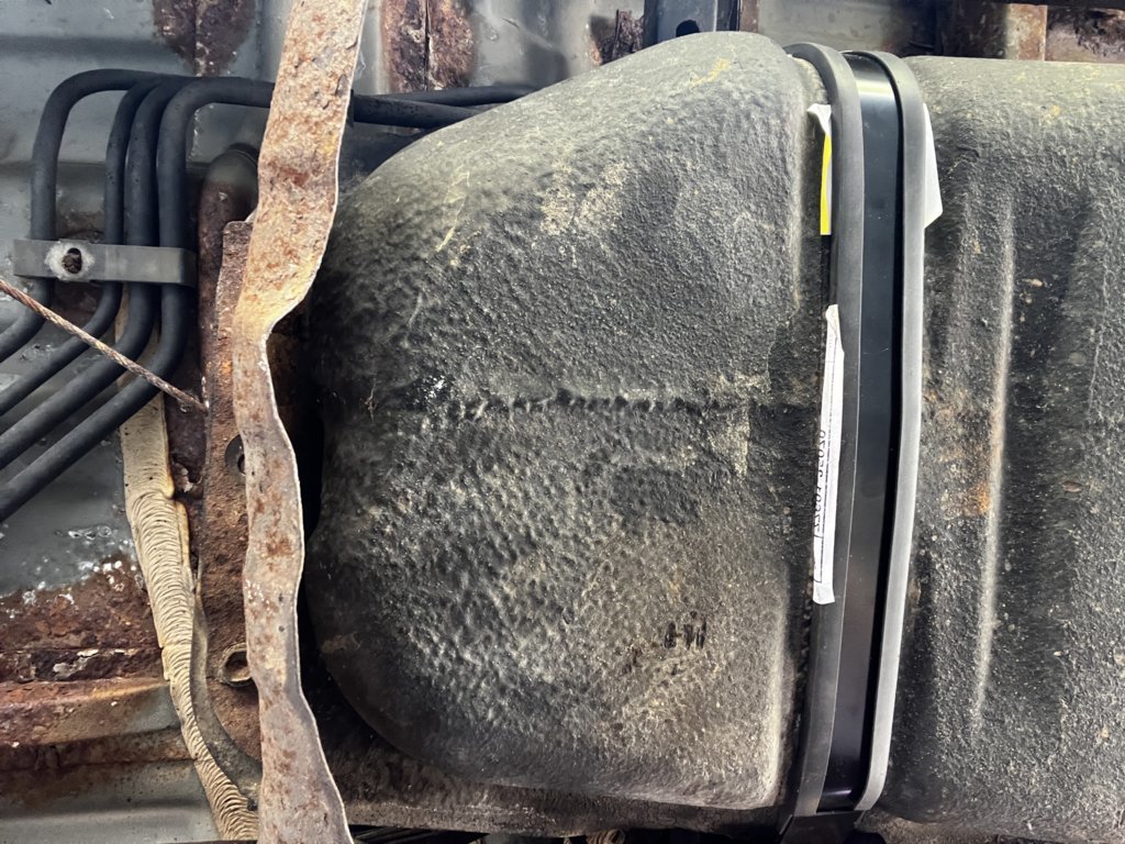

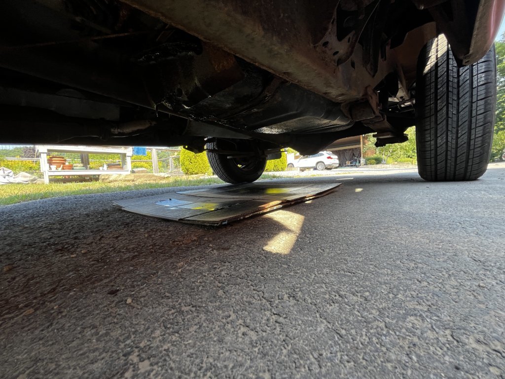

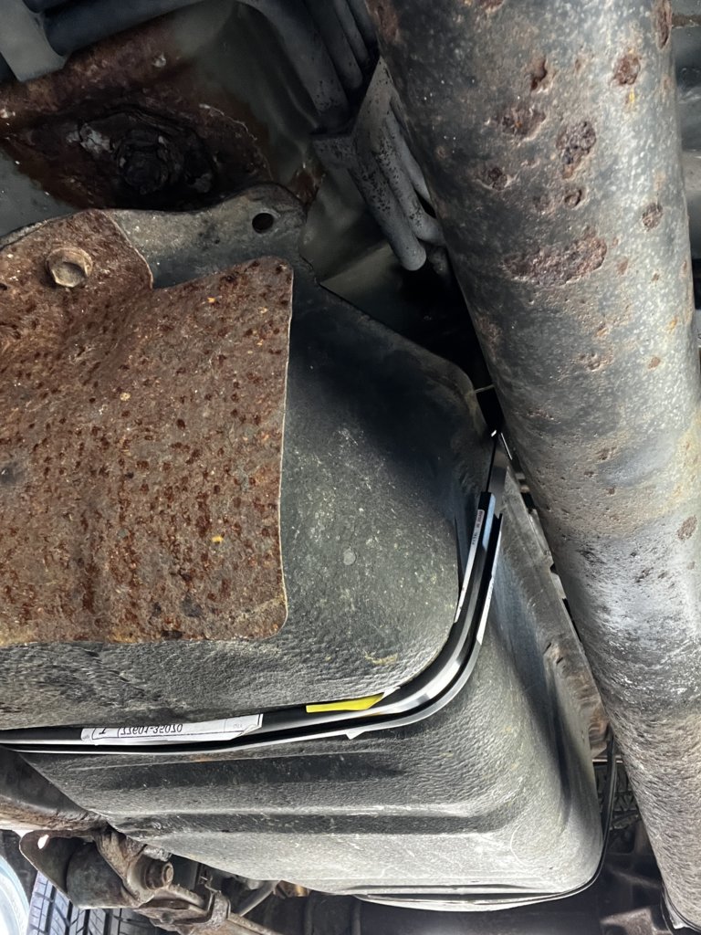

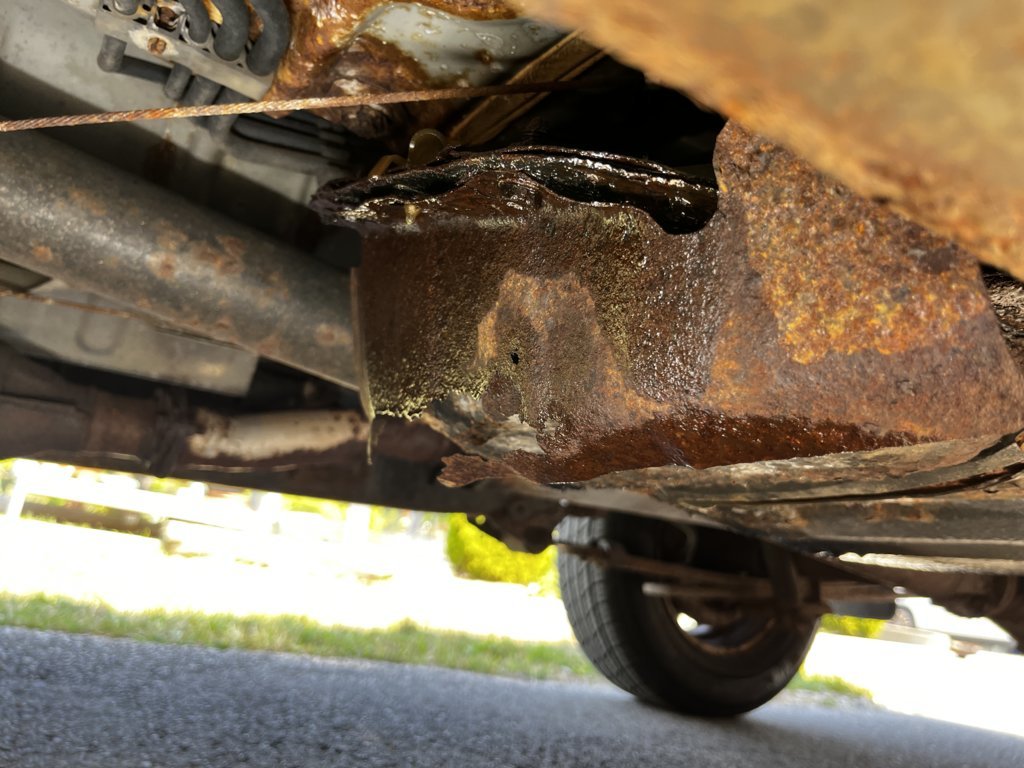

    Hi guys, new here and figured id poke around and see if i cant get some advice/suggestions on this job.
    Just got a 2004 with 120k on it this week and found out i shouldnt put more than a half tank of gas in it because its swiss cheese and will leak out all into my driveway.....
    Has anyone done this replacement before? any warnings, recs, do and dont's?
    Im not a mechanic but i can get by, im going to try looking around at some scrap yards but geez these trucks are like gold and i cant find any of them around (ohio). Worst case i was quoted the repair job at about $3200 from firestone. Im excited to start getting this truck up to snuff and this is the first major repair i have to get through.

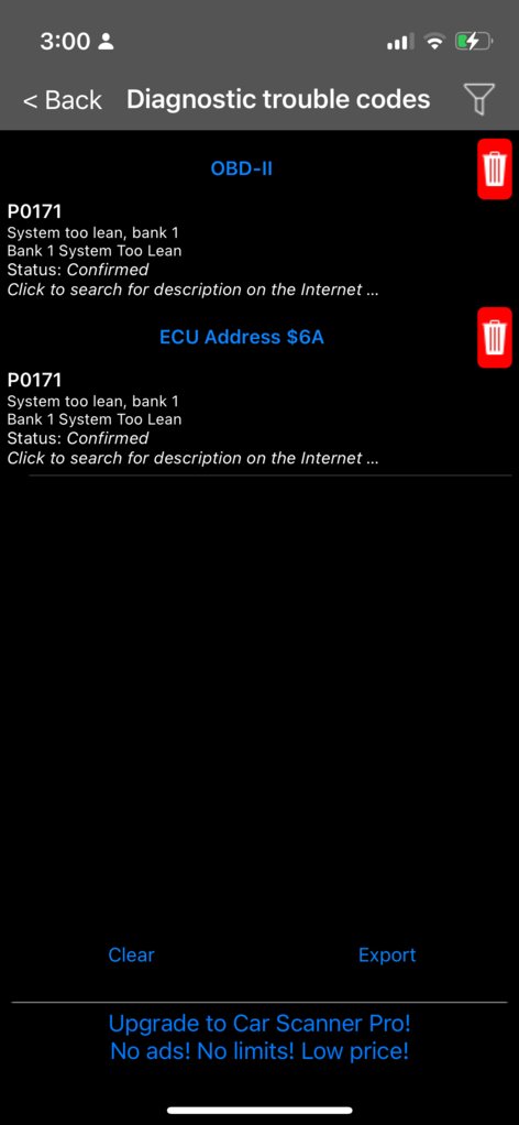

    I also suspect this to be the source of my P0171 OBD code as the fuel system is compromised.

    I figure the parts might be about $500-ish and a solid saturday/sunday worth of work, if pulling the bed isn't too hard id definitely want to go that route so i could access the hoses and everything from above.

    they're not hard to replace. but i will say be ready for potentially broken bolts. the specter aftermarket tanks arnt bad. but i would recommend painting them.

    Fuel tank at Rockauto is under 300 bucks. A rattle gun makes getting the bed mount bolts out a lot easier. Two guys can lift the bed up and over the fuel fill tube, and off the frame. The fuel pump screws will likely be in pretty sad shape and need to be cut or drilled to get the pump out. You can do it.
