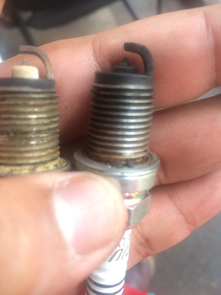

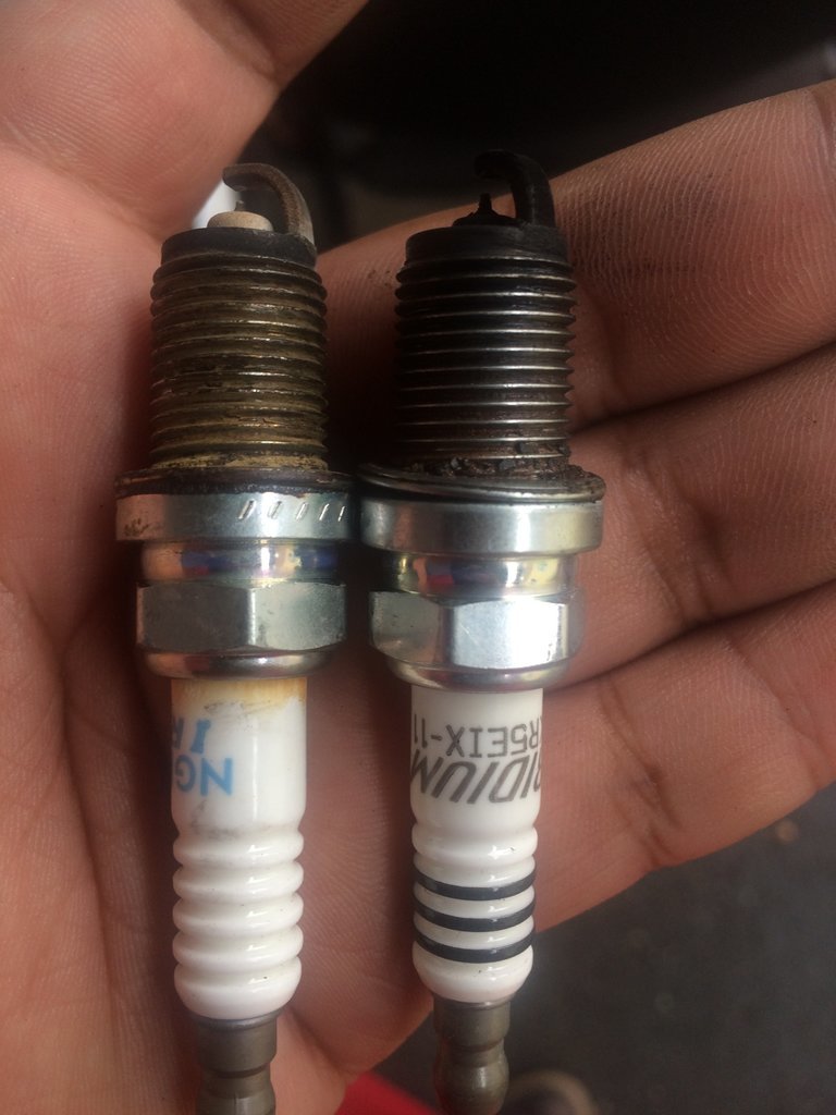

    Update:
    Alright so my dad made the trip up here for me last night and we started to look at the truck this morning. We started with what we changed first. We took the plugs out and these suckers were black! Part I guess was the anti-seize they recommended but some for sure was from something else(exhaust).They were worse then the ones that we pulled out. I checked the part from Oreilly's to see if maybe they messed up the part when they gave it to me but no, the plug they gave me were the ones that it needed. So when I pulled them out I compared to what I had in there.
    The only difference that I could see were that the ones I bought were "higher" quality and the ones I had before had a larger head(?) I'm not sure what it is called specifically but you will see in the pictures. The truck is now recovering from all that black soot whatever you want to call it but is running 100 times better. I will keep posted to see if the light comes back on.
    Oh and I forgot to mention that the black plug was worse. This was after my dad brushed some of the black stuff off to see if maybe there was something cracked or broken or something like this.

  9. Aug 13, 2017 at 5:35 PM
    #29
    ghs57
    ghs57 Well-Known Member
    Jul 27, 2010
    #40832
    1,096
    Chops
    Catskill Mts. NY
    '17 Grey TRD OR xtracab 3.5L 4WD
    Pretty much stock right now
    Hope you got it. :thumbsup:
    I put Denso plugs in mine. They were the recommended brand. It ran the same before and after, so I probably didn't need them at the time.
  10. Aug 13, 2017 at 5:39 PM
    #30
    nzbrock
    nzbrock Well-Known Member
    Jan 6, 2013
    #94572
    3,251
    Noah
    San Marcos, TX
    99 TRD Prerunner 3RZ
    SAW 2.0 Coilovers Wheeler's 5 Leaf + 3 AAL Bilstein 5100s LCE long tube header Flowmaster Delta 50 Muffler FJ Trail Team Wheels 4Runner overhead sunglass console 4Runner leather seats All LED lights Red/Clear Tail Light Tundra Brakes HID Projector Retrofits 4Runner Auto Up/Down Windows Bullet Liner Cargo tie down system E-locker axle swap w/4.56 Gears ARE MX Cap Prinsu Toprac Custom heated turn signal/puddle light mirrors Volant Intake Tube
    With all of the misfire codes you were getting, it makes me think it was the wiring. Just pulling the plugs and reconnecting the wires could have fixed it. Either way, glad you got it running right! They plugs are black because it was running rich, meaning too much fuel getting dumped into the cylinder.
