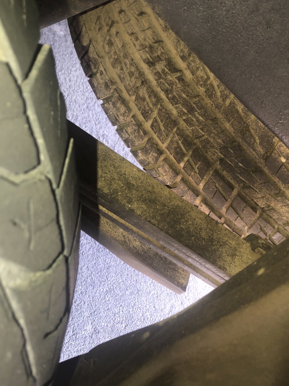

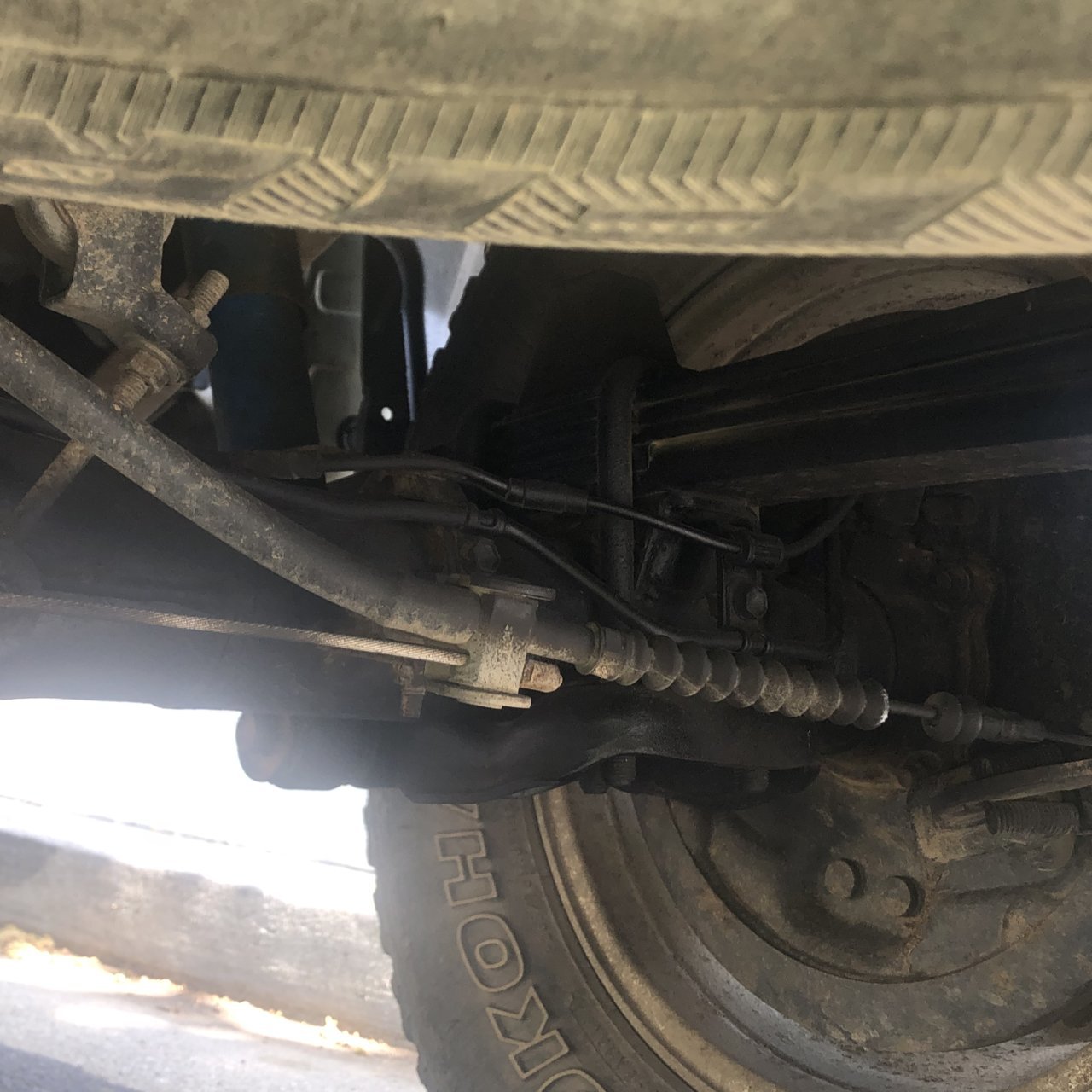

    yea i got the pictures but i am a fairly large guy so the pics arent the best
  8. Apr 23, 2021 at 1:08 PM
    #48
    Tacoma_alex
    Tacoma_alex [OP] Well-Known Member
    Apr 22, 2021
    #363595
    67
    Alex
    this is the best i got

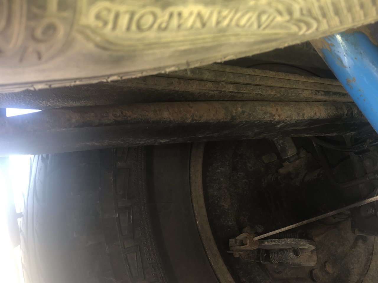

  10. Apr 23, 2021 at 1:10 PM
    #50
    Tacoma_alex
    Apr 22, 2021
    #363595
    67
    Alex
    pictures above^

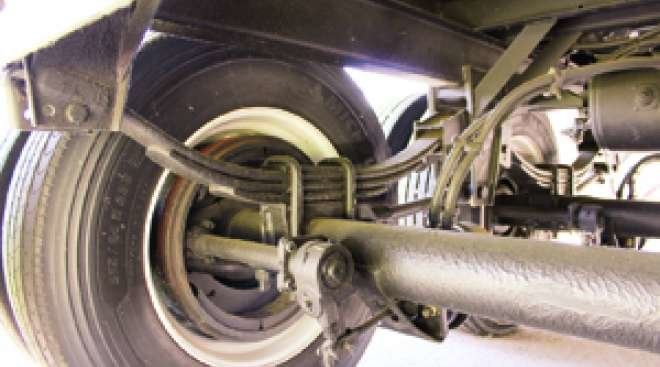

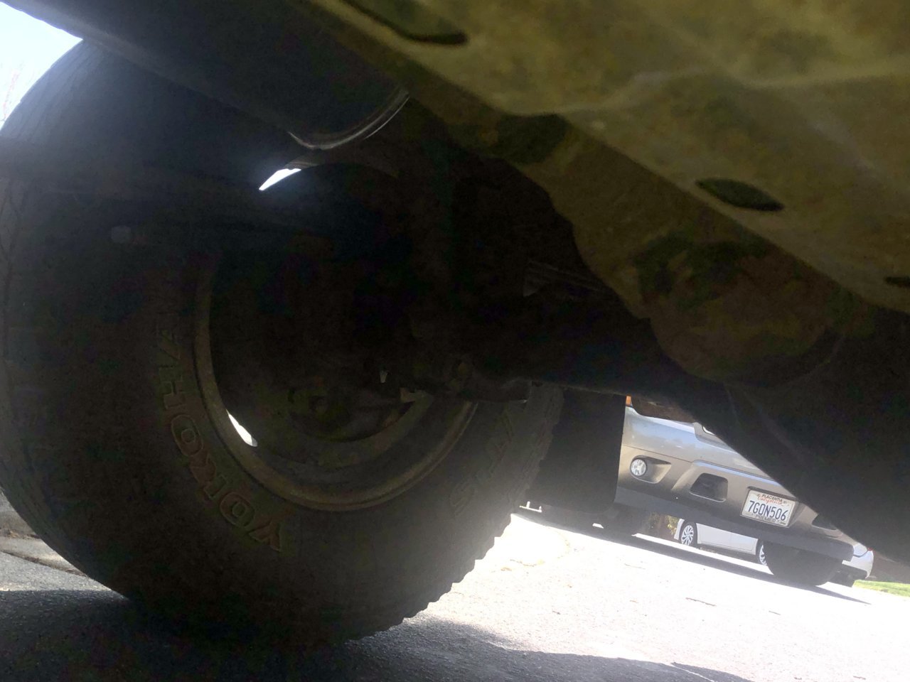

    You just need a picture, sitting level with the truck, facing the leaf pack.
    Top and bottom shots don't tell the angle at which the leaf pack sits at.
    Here's an example on a completely random vehicle -
    But really, if your truck is stock, it's safe to assume that leaf pack hasn't been replaced which means it's been long due for a new leaf pack.

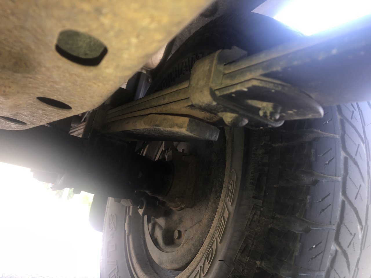

  12. Apr 23, 2021 at 1:19 PM
    #52
    Tacoma_alex
    Apr 22, 2021
    #363595
    67
    Alex
  13. Apr 23, 2021 at 1:19 PM
    #53
    Tacoma_alex
    Apr 22, 2021
    #363595
    67
    Alex
    those dont look to well huh
