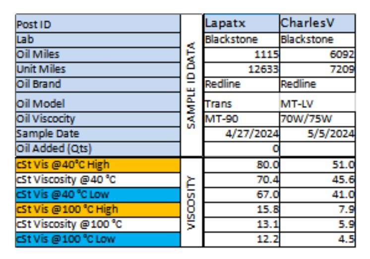

    redline MT-90 gear oil is the one u need

    I like Redline MT-LV for both the Tcase and manual transmission.

    I have not tried that one, is there a difference of smoothness between the MT90?

    What part of the country do you live in and do you tow with the truck? If you look at the temperature range of gear oils you will see that 75-90 is an all around gear oil, if you live in Vegas, I would think the 75w-140 would be a better choice.

    MT-90 is much thicker and designed more for a performance application that may cause significant heat soaking in the transmission. MT-LV would definitely be better for anyone who lives in cold climates.
