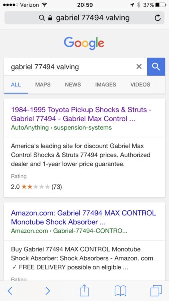

    Oddly enough, google says these have 2 stars, but when I click the link to the page, none of the reviews are there. AutoAnything must not want you to know that these suck. Guess they make a pretty healthy profit on them.
