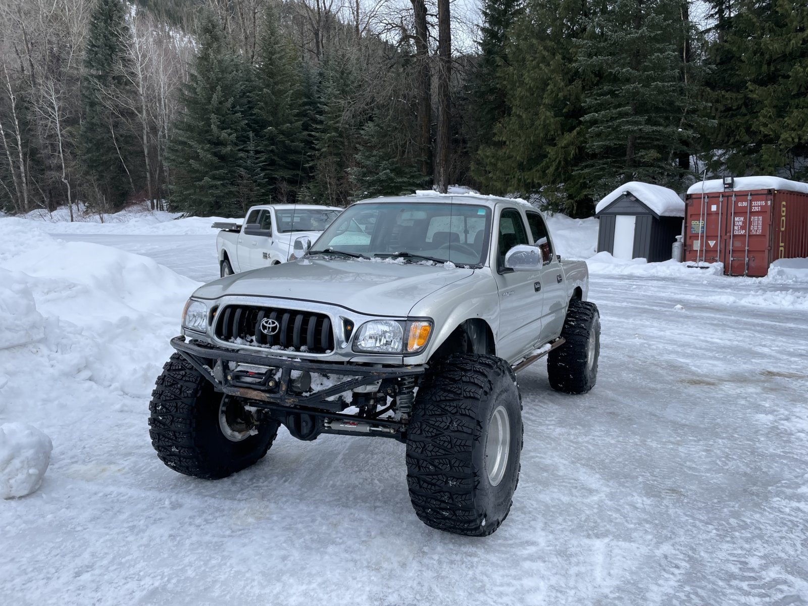

    Starting out with a bone stock 2004 Toyota Tacoma after selling my Jeep TJ on narrowed one tons/cage/atlas/doubler on 40” stickies. Searched for a while and originally wanted an extra cab truck, but came across a pretty clean double cab that I couldn’t pass up on.
    This one is going to be more mild compared to what I just got rid of. I plan to use it as a summer wheeler on 37s and snow wheeler on 38s. Using a Toyota solid front axle, a 90s rear non e locker 8” and dual gear drive transfer cases. Rear is getting Chevy 63 springs and a back half, and the front is getting a 3 link and 14” Fox coilovers. Trying to keep it low from the beginning

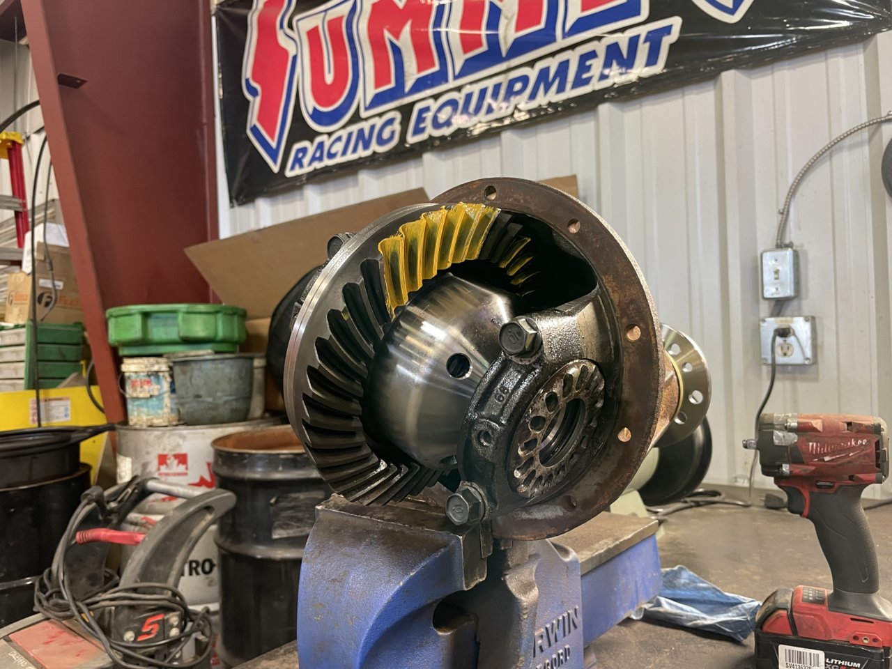

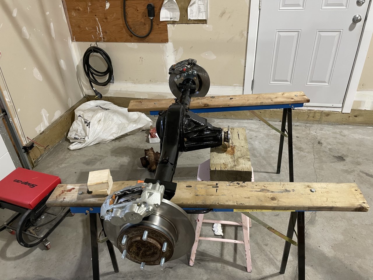

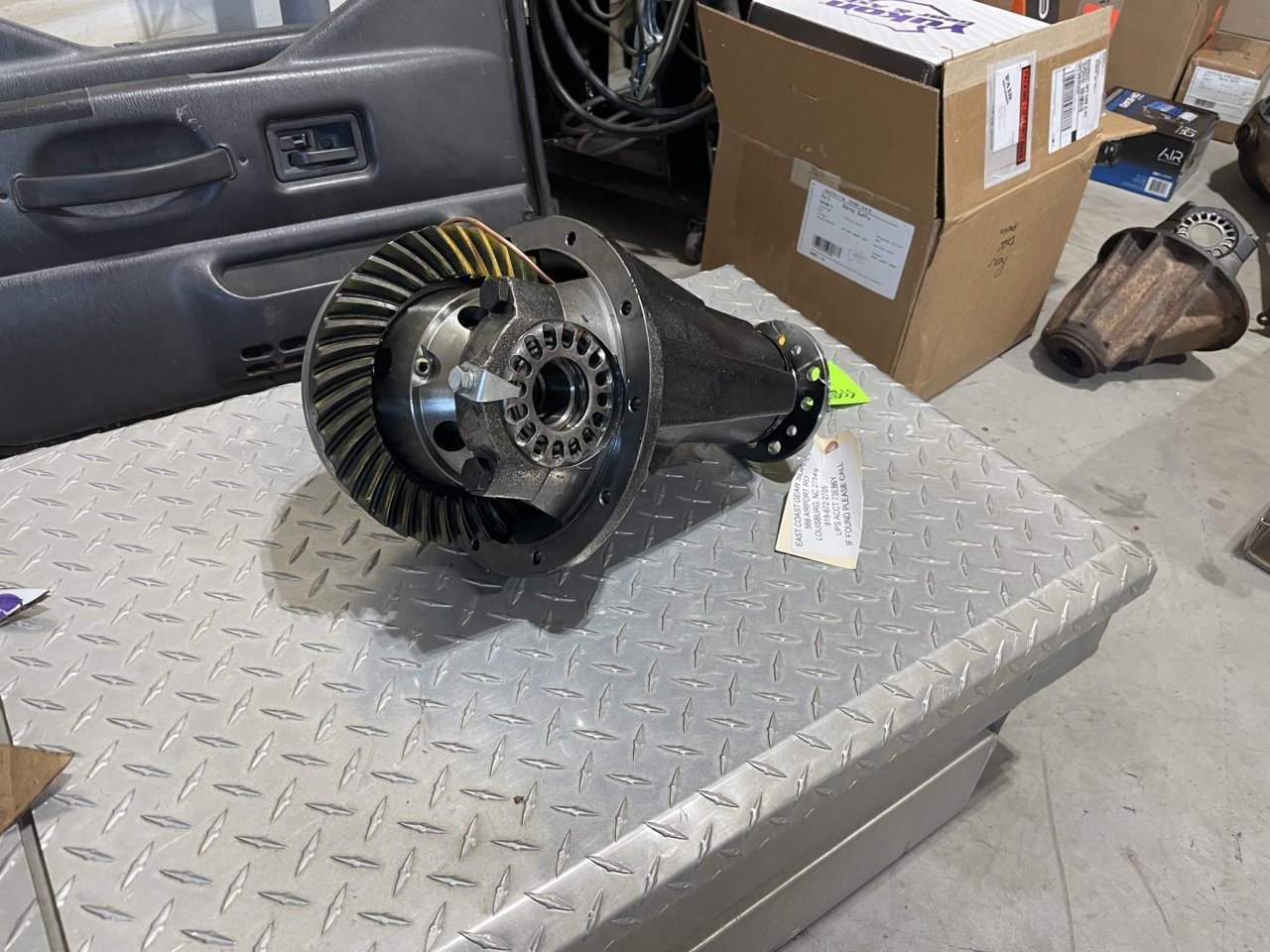

    Built a 4.88 with grizzly rear
    Ecgs HP8 front with arb

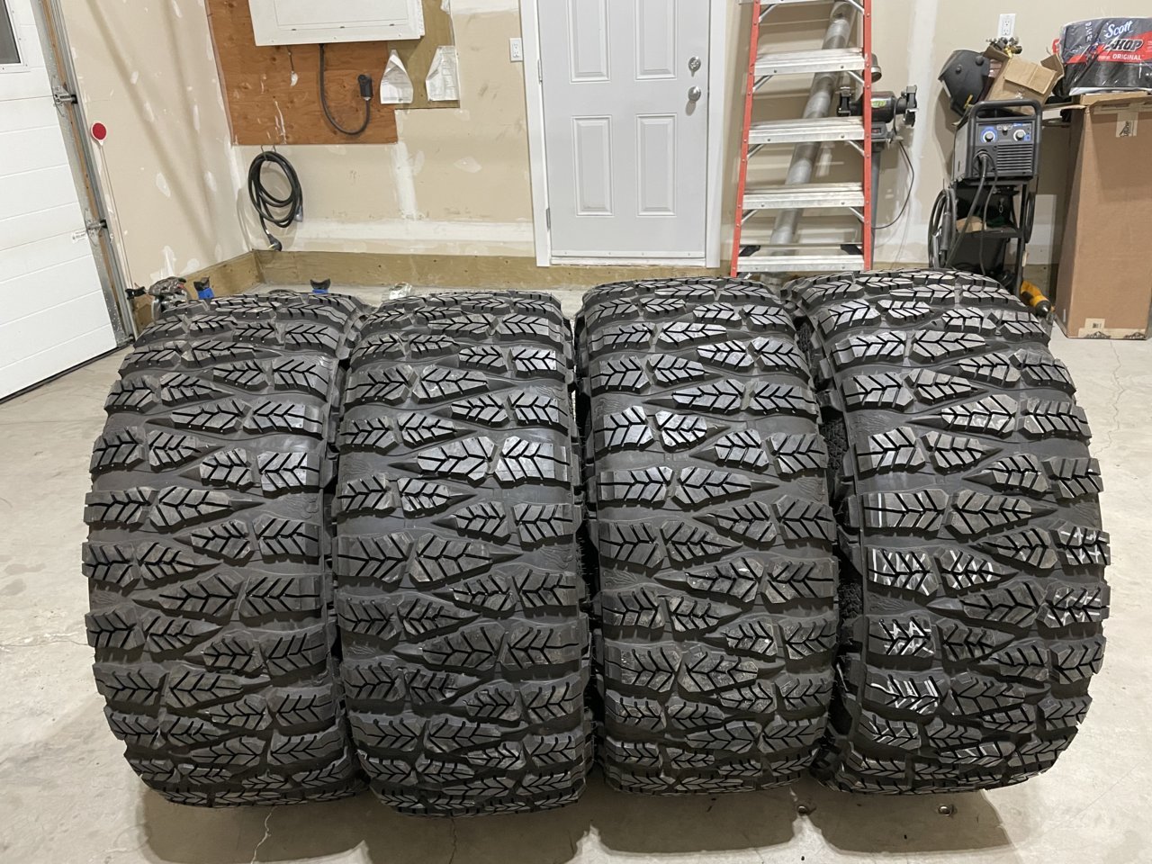

    grooved my winter tires
    rear built, still needs anti wrap brackets welded on
    Front Toyota solid axle housing widened 3”. Will use ifs hubs to get me to the 61” wms that the fabricated housings come. RCV makes axles for this width.

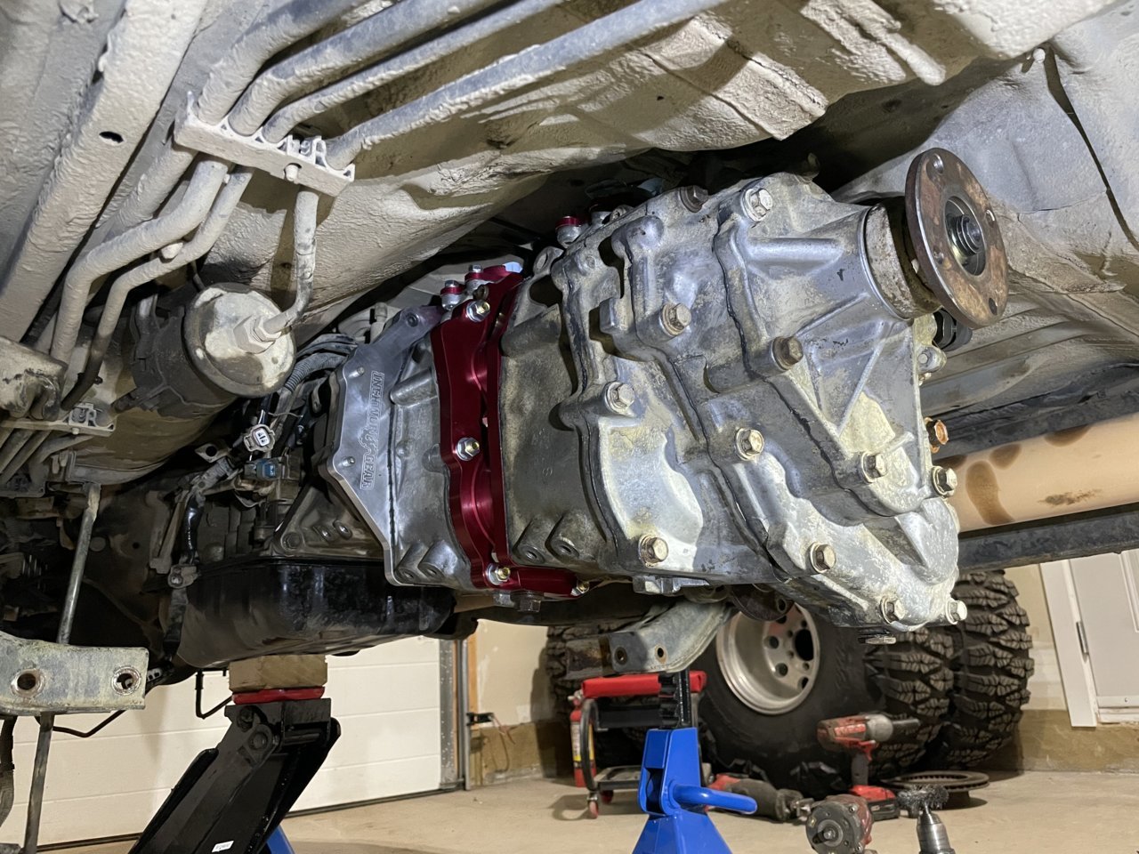

    Dual cases with all Marlin goods. 23 spline comp input, comp 4.7s, adapter to the a340

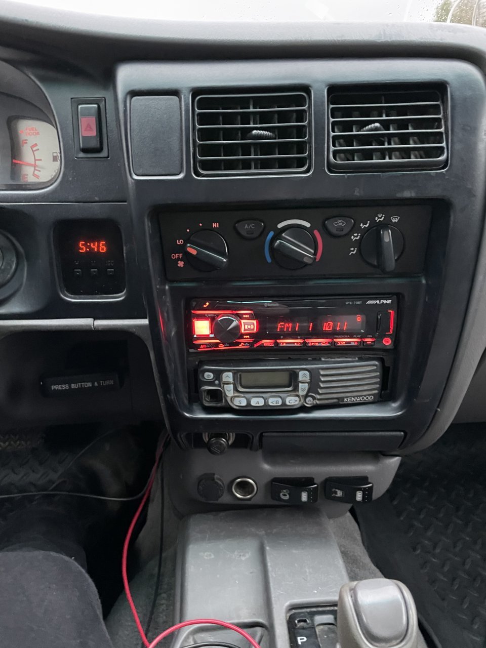

    Installed a 2 way radio under the stereo and the arb switches in the cut outs under.

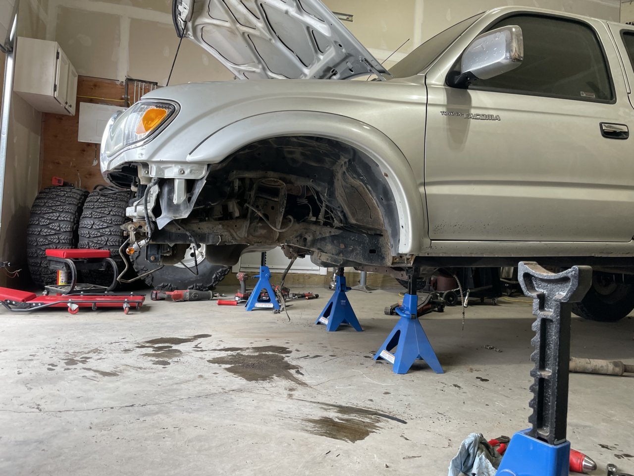

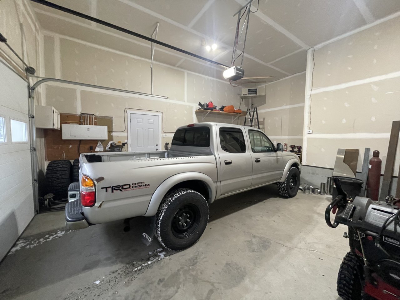

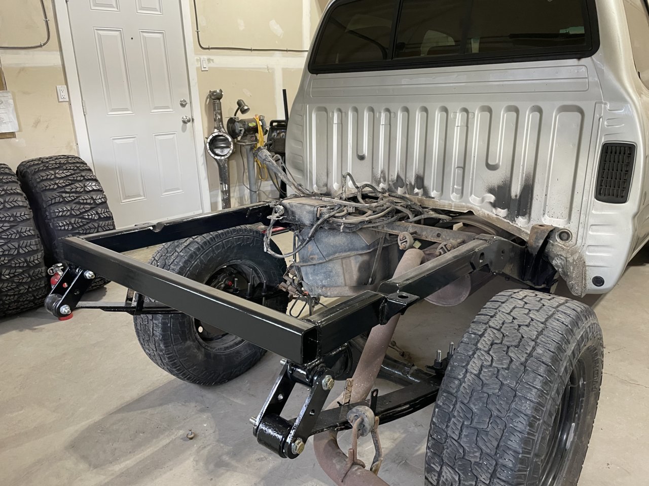

    Pulled the truck into the garage December 17 and started on the rear as it’s easier and I figured I would get it done pretty fast
    Got right to cutting.
    New rear frame section.

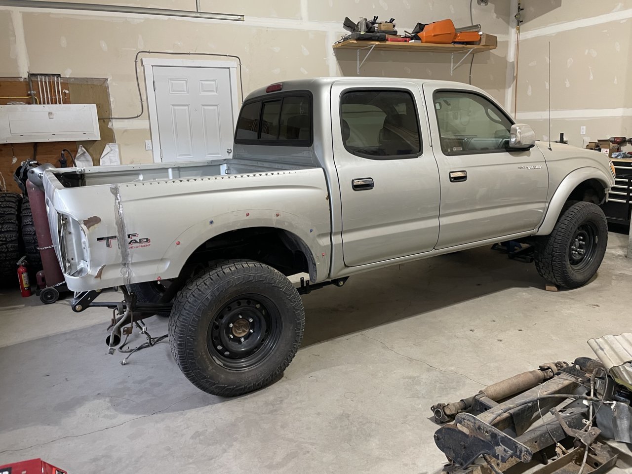

    Bobbed the box 9”
    Onto the front

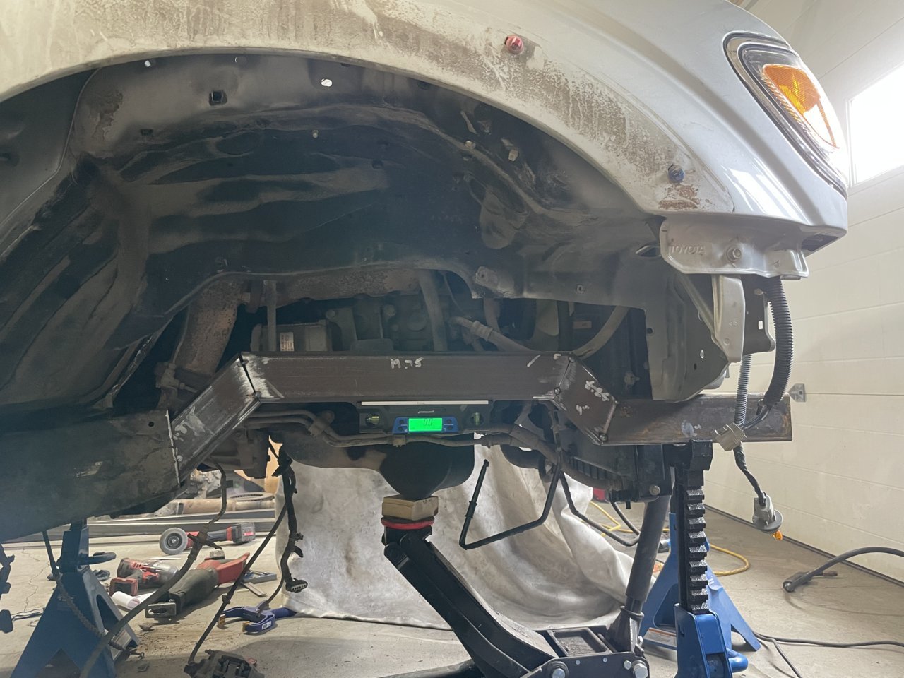

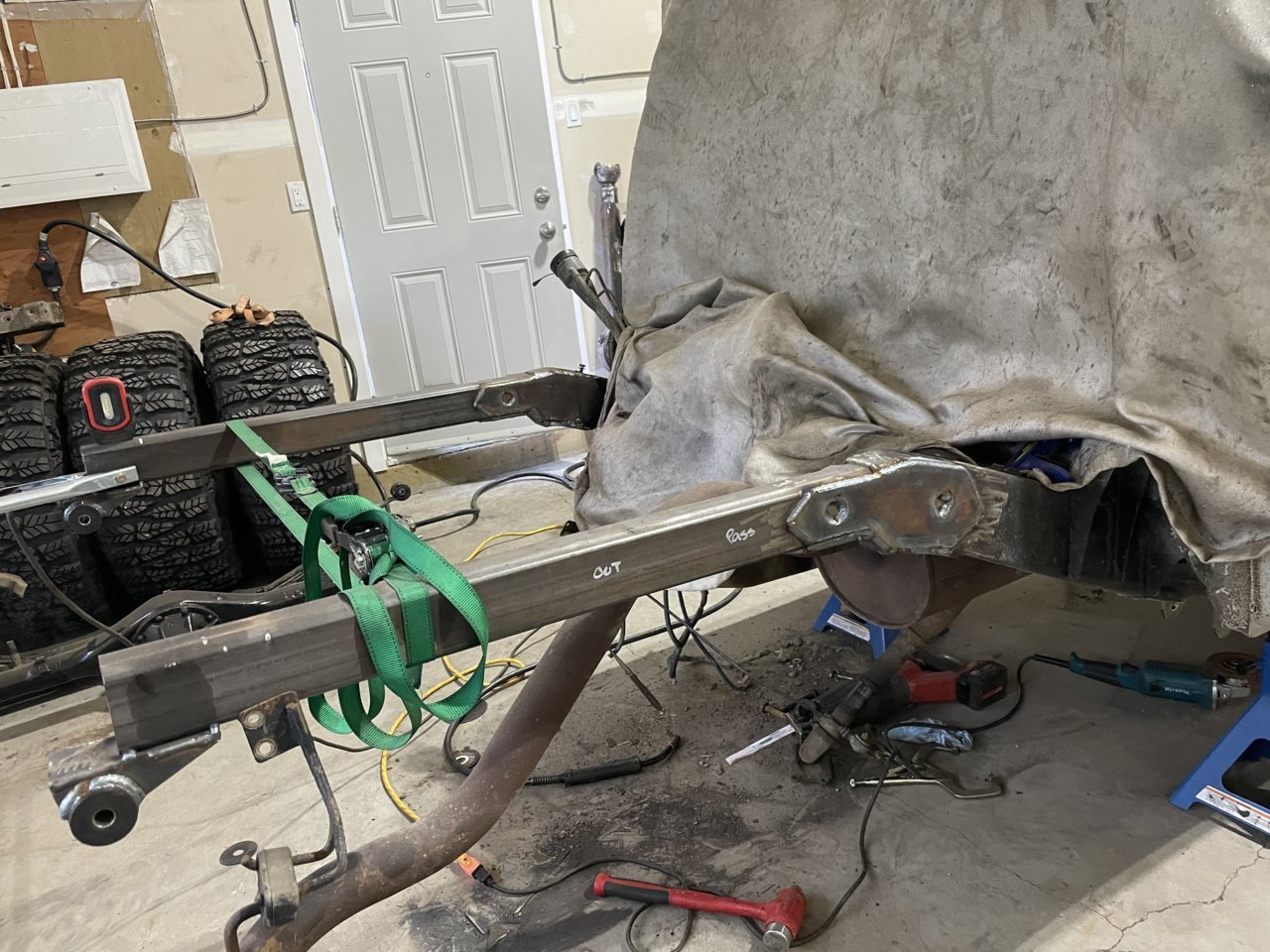

    This is where I finished at today. Cut everything out, but have not decided if I’m going to rebuild the front section with 2x3 or just raise the factory frame on the passenger side to clear. Have to swap out the oil pan before the front goes under for mock up.
  3. Jan 2, 2023 at 6:25 PM
    Yota X
    Yota X Some say dresser, I say dryer.
    Jul 11, 2019
    #298961
    5,268
    NW New Jersey
    1st gen
    ls turbo, tons, 40's and a partidge in a pear tree
    Easier to do in 2x3. Dont 45 them down under core support til you get the steering gear done.

    Cut the front frame off and raise the motor and frame, you will be glad you did. You can get a few more inches of uptravel out of it

    That’s the plan now. Trying to get it as low as I can, makes more sense.

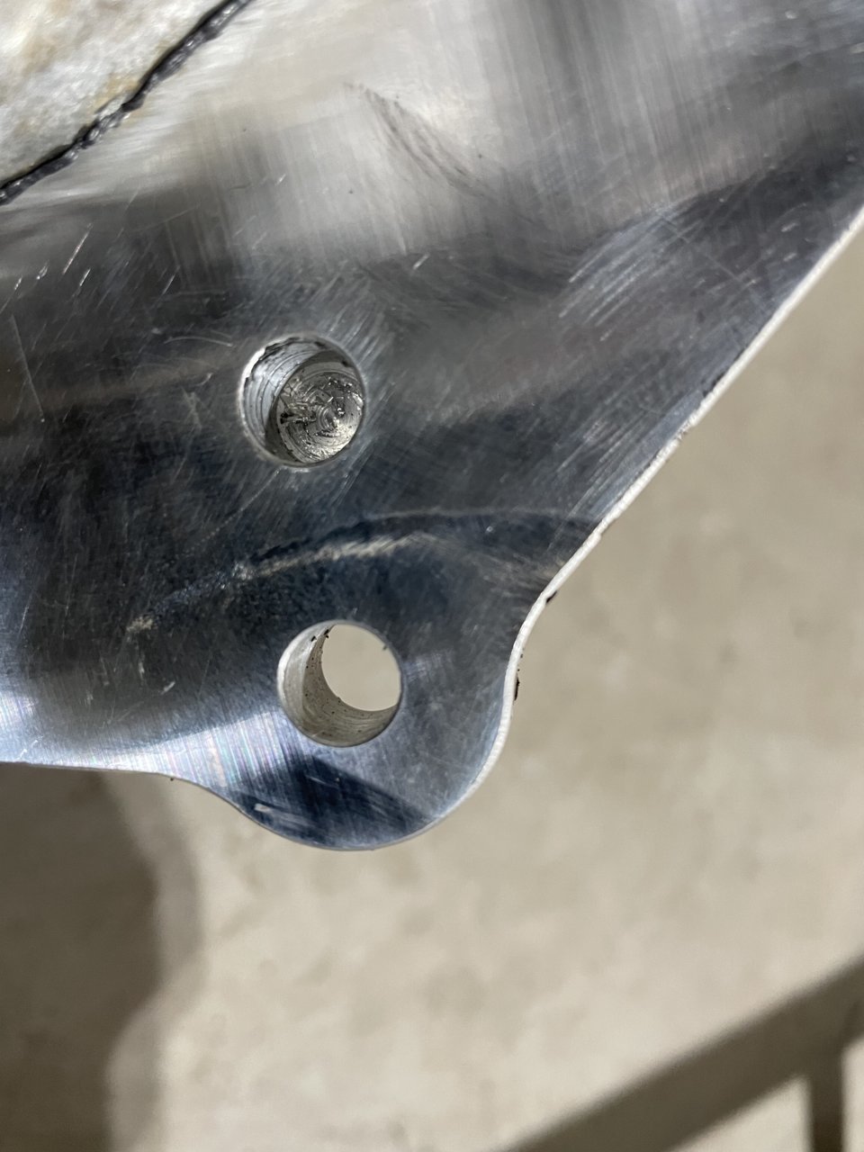

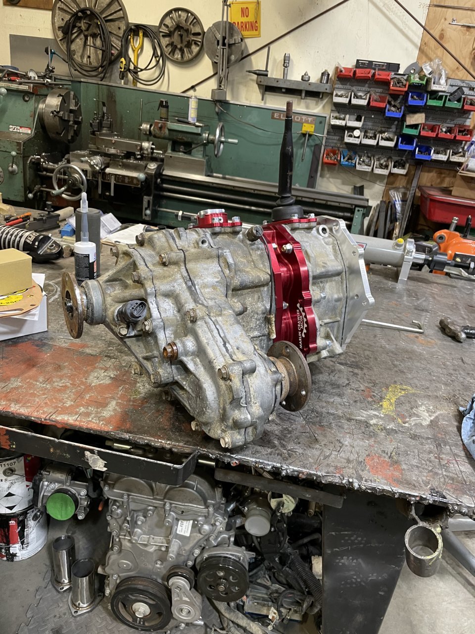

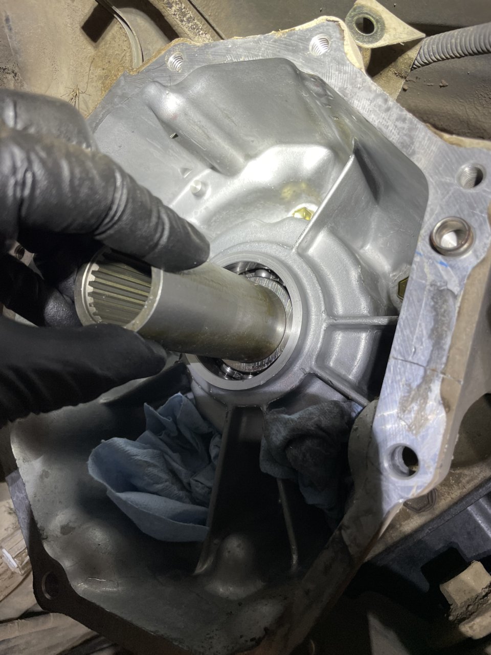

    Swapped out the transfer case for my dual case setup. Marlins instructions are pretty trash and inchworm instructions don’t exist, had to delete the bearing from the extension housing on the back of the a340 to get the coupler and extended seal housing to fit. Man handled the cases in to find that one of the bolt holes in the adapter wasn’t fully drilled. Pulled back out, redrilled, cleaned silicone and back in. Also found none of the supplied hardware worked and only half of the factory hardware worked to bolt the adapter to the trans. Ended up running to work and getting allen head cap screw bolts for the top holes and a few flanged bolts for the others. I’ll order a bunch of the proper lengths to make everything match.
    Need to do some research and see what I can do to make the 4wd light in the cluster work.

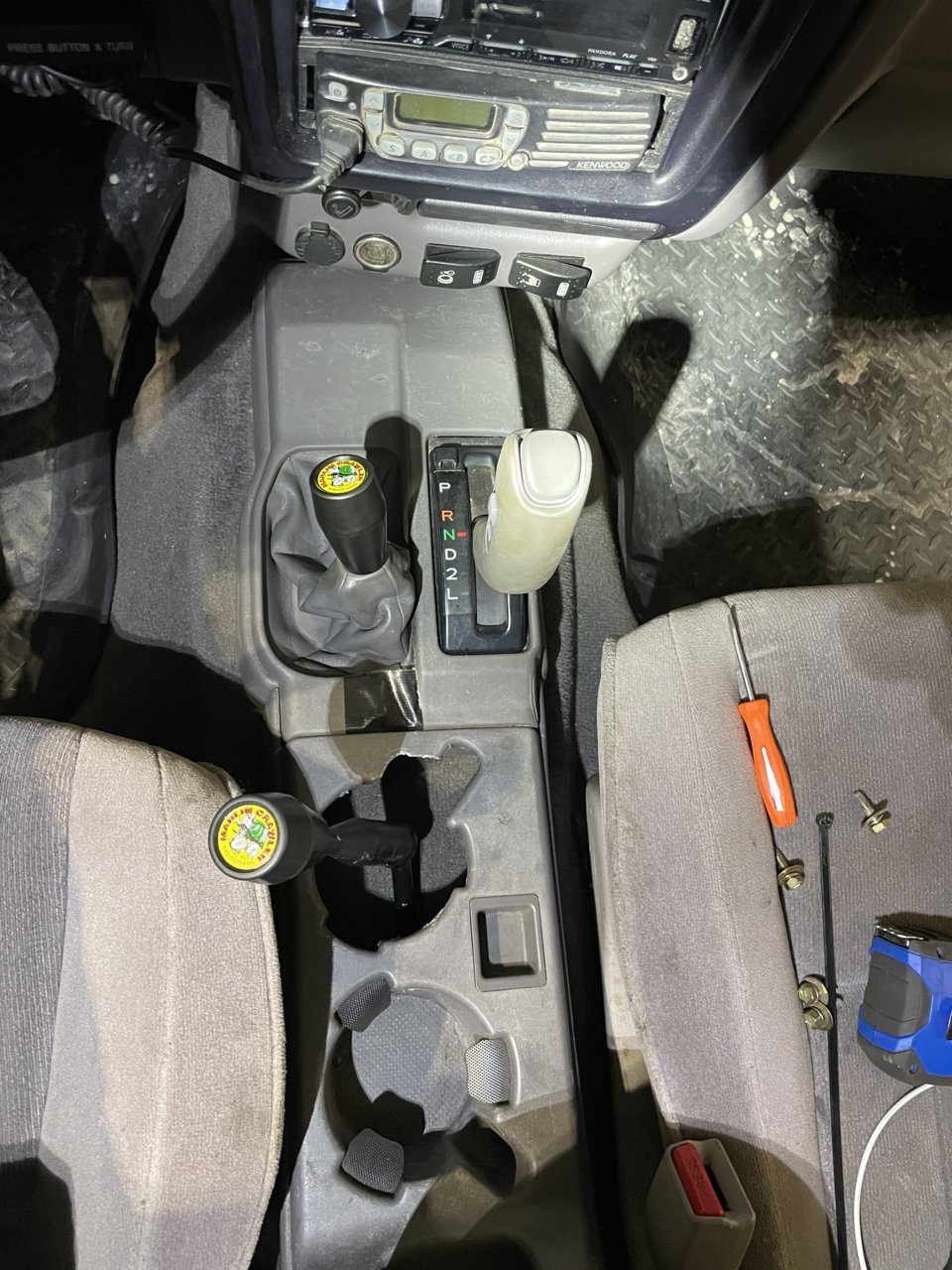

    Been waiting on some steel for the front frame and the oil pan so not much has got done this week. Got the shifters in where I wanted them. Had to modify both of them, but was able to save one cup holder and reuse the factory location, just need to round up some boots for the floor seal and shifter handle. Thinking I’ll order one of the bh3dprinting dual cup holders. Front frame gets cut out tomorrow, then assemble the front axle temporarily so I can start mock up.

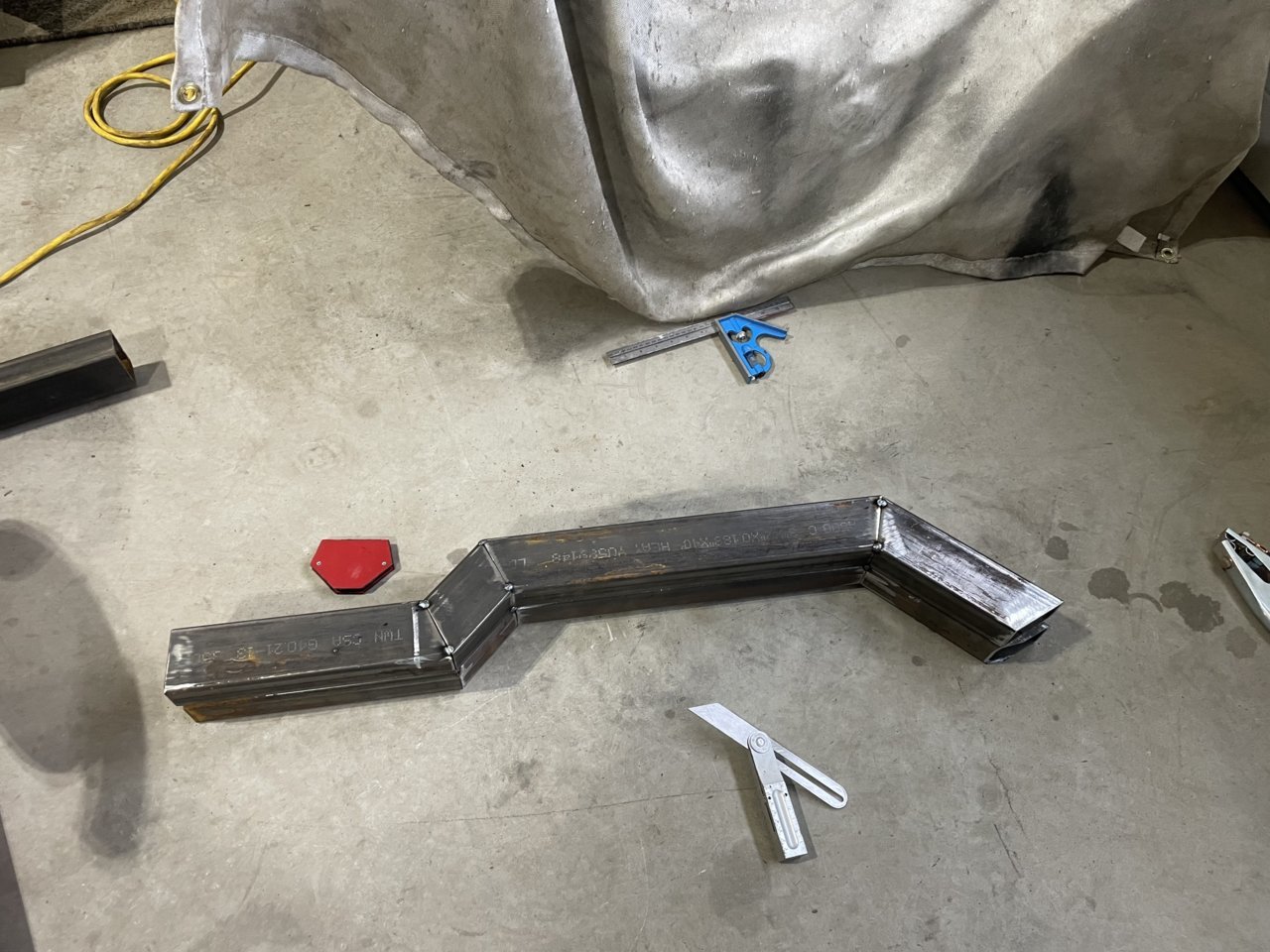

    Been pretty down with a cold this week so haven’t accomplished much in the garage. Got the front frame sections built, need to weld and fishplate them before installing. Oil pan will be here Tuesday and then axle goes under for mock-up.

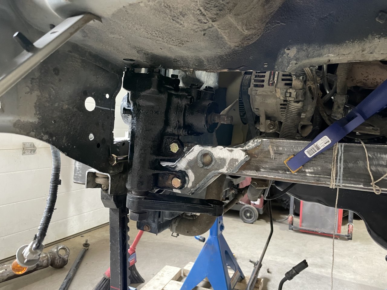

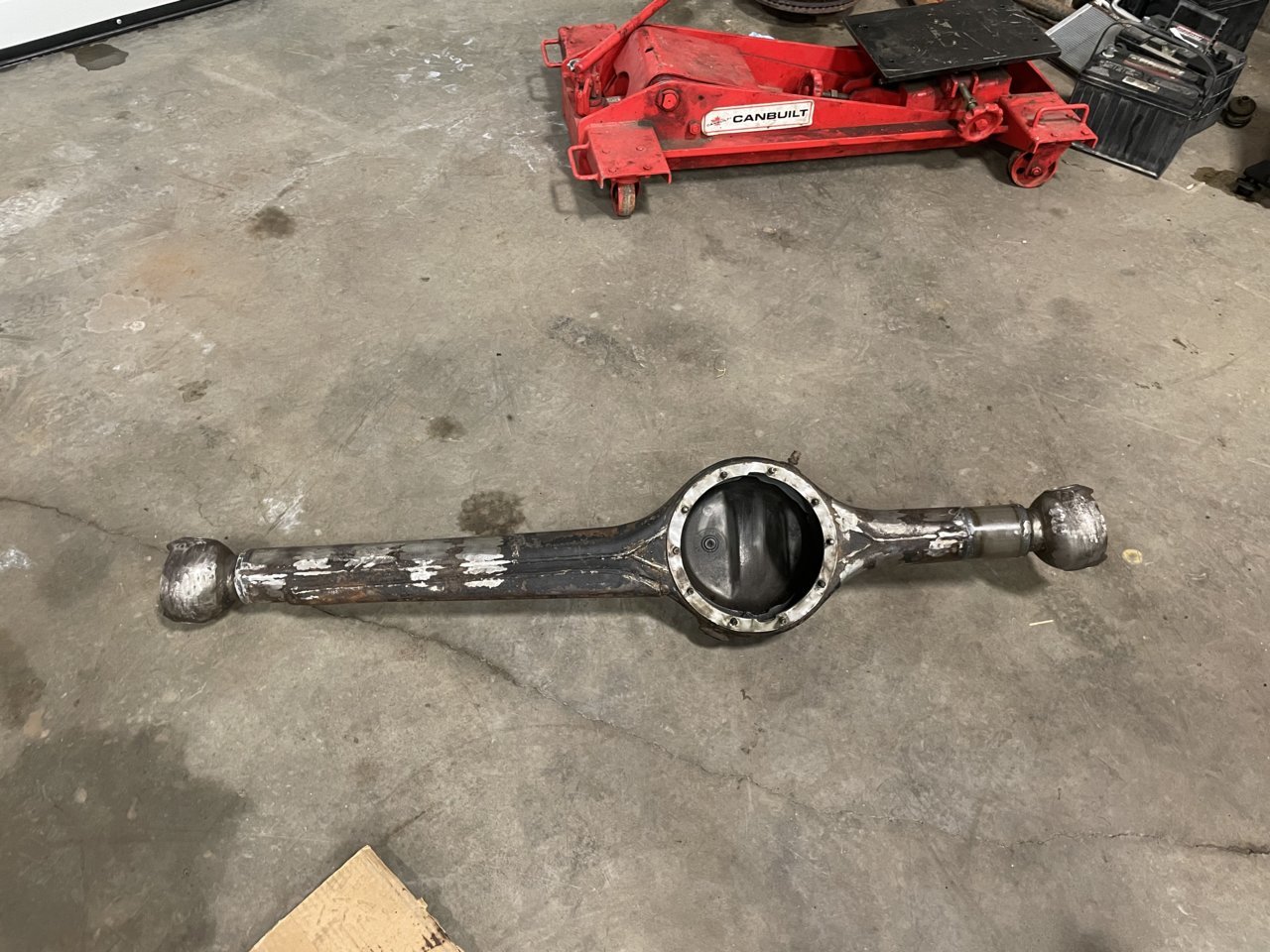

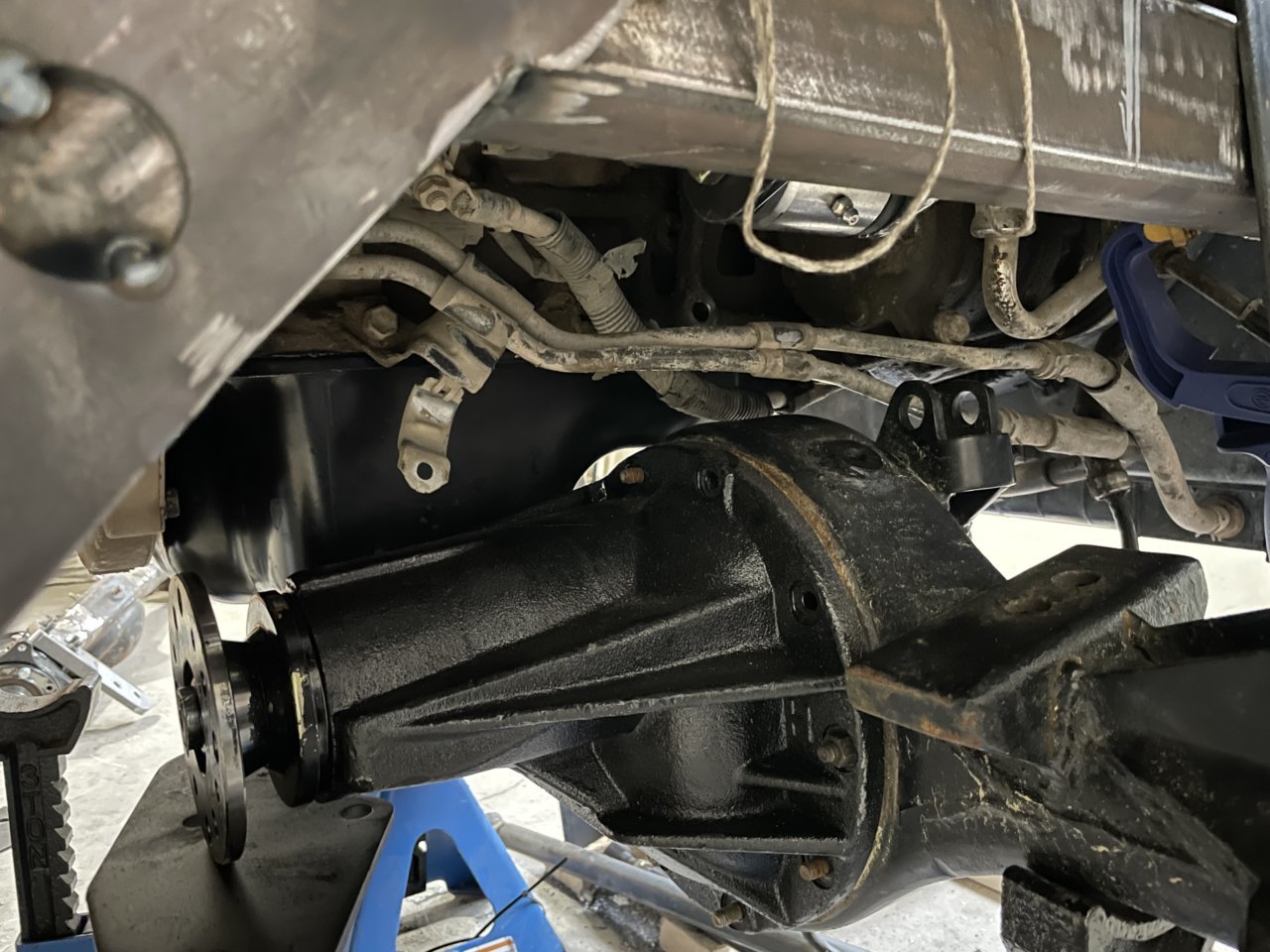

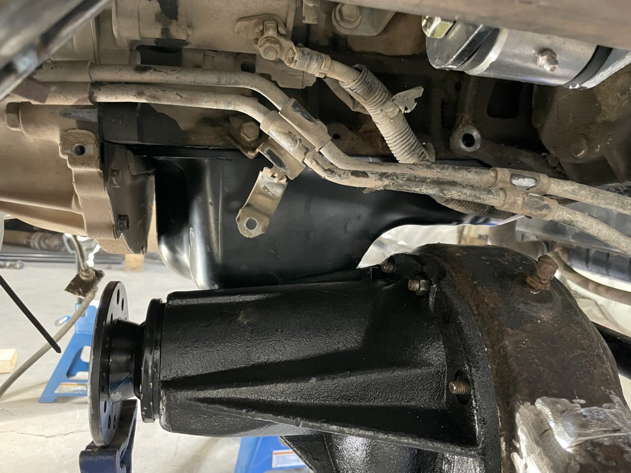

    Been a while since I updated. Was hoping to have a lot more accomplished but I’ve been trying to figure out how to get more uptravel. Raised the engine, trimmed the a/c tensioner bracket/raised pulley and I still wasn’t happy with the amount of uptravel I had. The third was getting too far into the oil pan so I was planning to modify the pan but it was going to make my front driveline impossible to keep out of the trans pan/bellhousing. I ended up grabbing a stock solid axle housing instead of the +3” wide one I had and it seems like it’s going to work way better, I’ll just have to run wheel spacers to achieve my desired width.
    On the plus side I’ve got the steering box in place. Tomorrow I will cut off the leaf spring mounts and get this housing ready for link mounts.
    Widened housing at full bump, too far into the oil pan
    stock housing has 2” more uptravel since the third is 1.5” closer to the passenger side
    steering box in place. Still need to cap the bottom of the frame and clean it up
