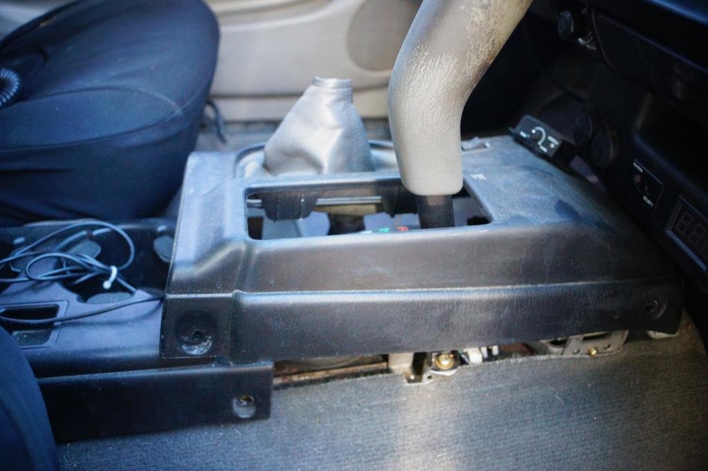

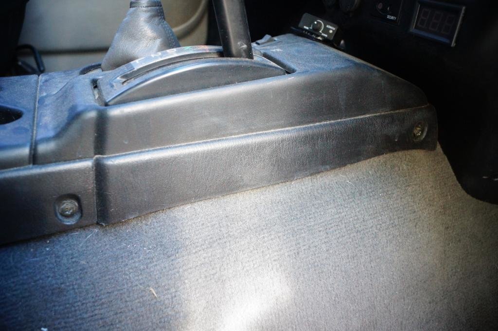

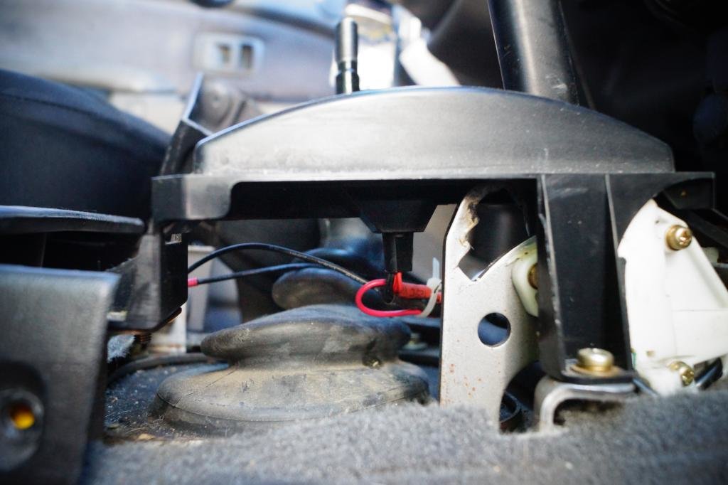

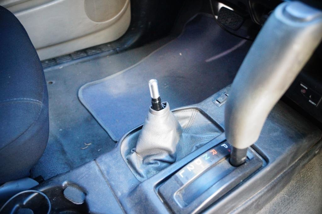

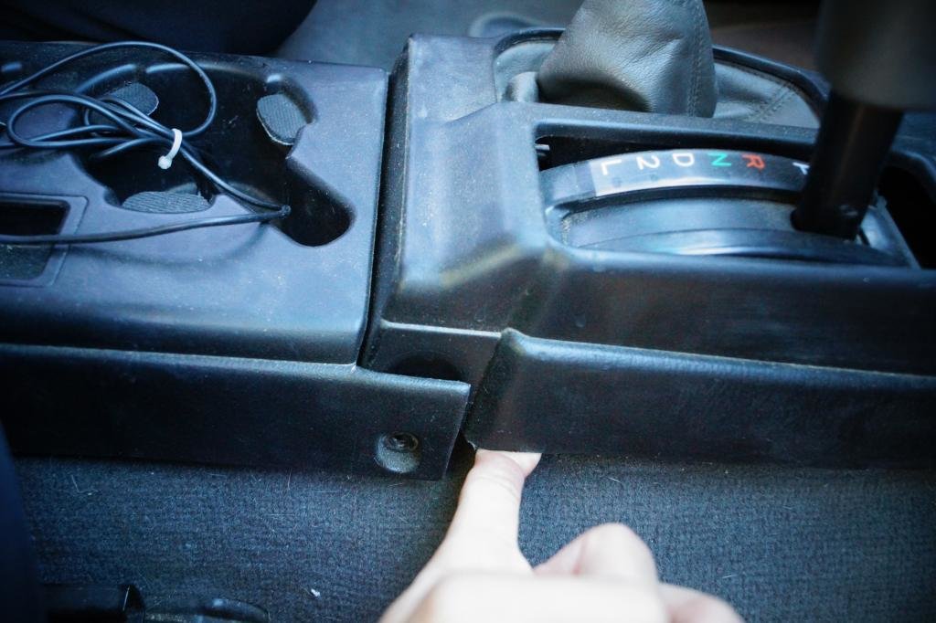

    You can remove the shifter console without taking the cup holder/center console out. First take off the shifter knob, if you have 4wd.DSC01703_e60c3ff491f52ac78cce6d1e96da640a93ec003c.jpg Then undo the 4screws, 2 on each side.DSC01704_6de02ccb1d237be3ca944697f8c58d08111570d7.jpg
    Lift up from the bottom of the console and pull the back end out.DSC01705_aa3ab00bb10f0affa111c4715c4eef5279552598.jpg
    Then you can remove the console.DSC01706_6b3324b0ffda57ec384954bc492f1a477746b5fd.jpg
    You should see the bulb, just twist it out.DSC01707_e51e1900bf79fc07cce67d8bc4a695aa84d3b2d4.jpg

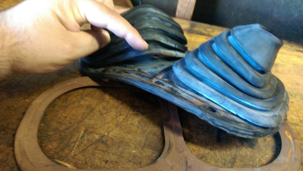

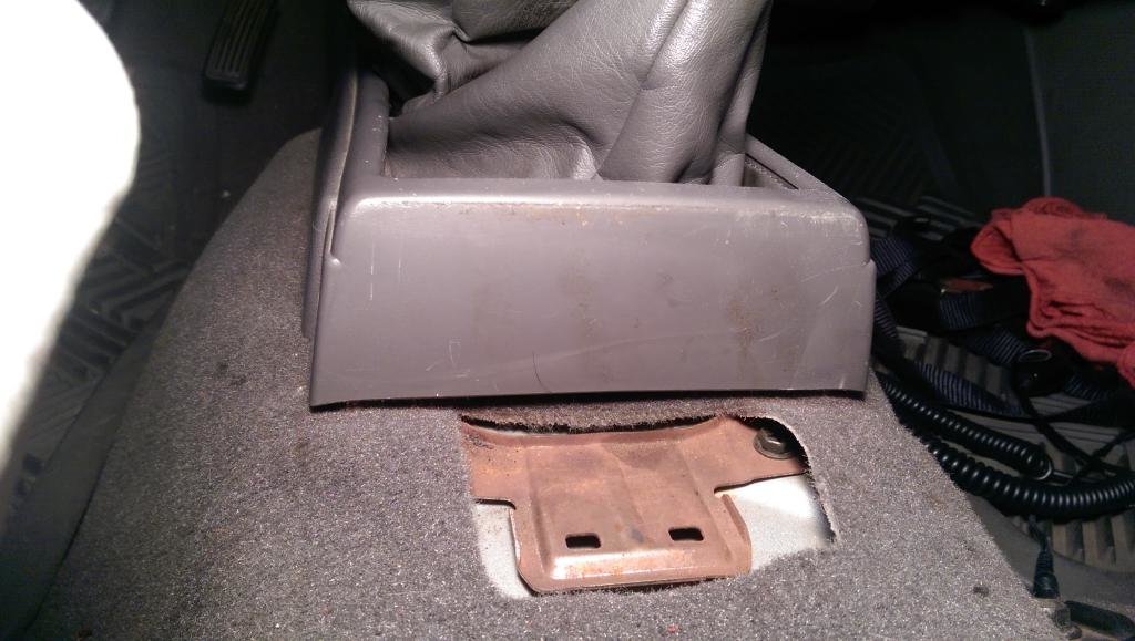

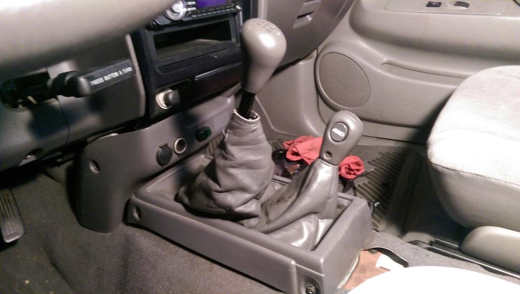

    Hey since we're on this subject... I have a 5spd and have my center console removed. So I just got the plastic attached below the shift knob. Anyways, after mytruck runs for a good while I got hot air coming into the cab from the gap right below the shifter. I'm thinking I must be missing some sorta boot or kind of insulation pieceto keep the air coming in. Can anyone snap some pics of ur manny shifter dissected like what camptaco did? So I can compare. Thanks!

    It'd be easier to take a pic of your set up to see if you're missing anything.
    You should have rubber boots under the fake leather shifter boots.
    Like these guys:

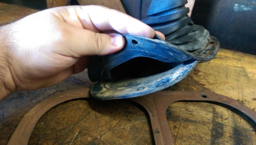

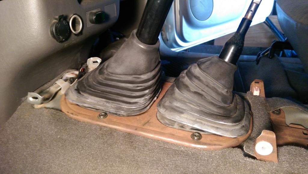

    There should be a solid metal plate with boots that mount to the truck body. The pleather assy goes over that.

    Anybody see anything wrong that would be allowing all the hot air to enter the cab? I ended up taking it all apart as you can see in the pictures. and ended up leaving it without the pleather(like how Madjik Man has it). I screwed down the 4 metal plate crews really really tight to see if hopefully that fixes the issue.
