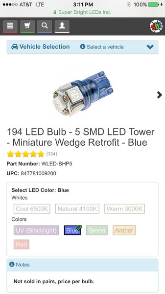

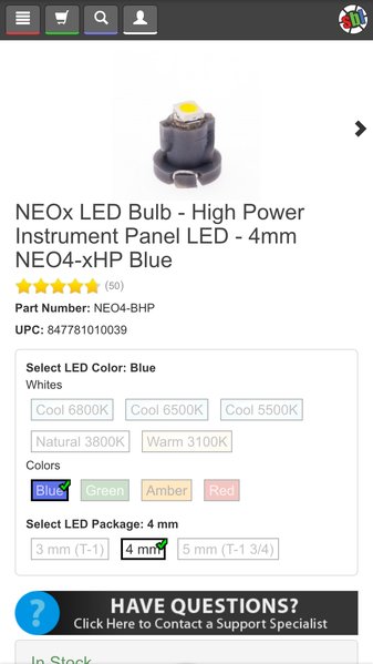

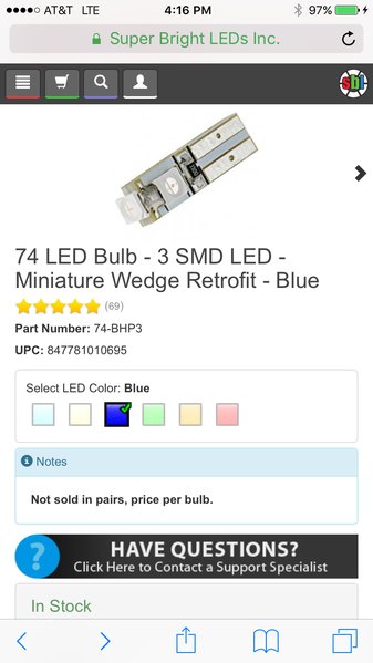

    01 - 04 Tacoma LED bulbs as follows: Instrument Panel 4 - #194's. HVAC Area 3 - Neox Wedge 4mm. Glove box, auto gear shift letters, ashtray, 3-4 #74 LED. All blue. It says instrument panel on the Neo Wedge LED's but it's not, on the 01-04 Tacomas. Maybe on an earlier year, not sure. I have an 04 Tacoma and these all worked in the areas I said for my truck

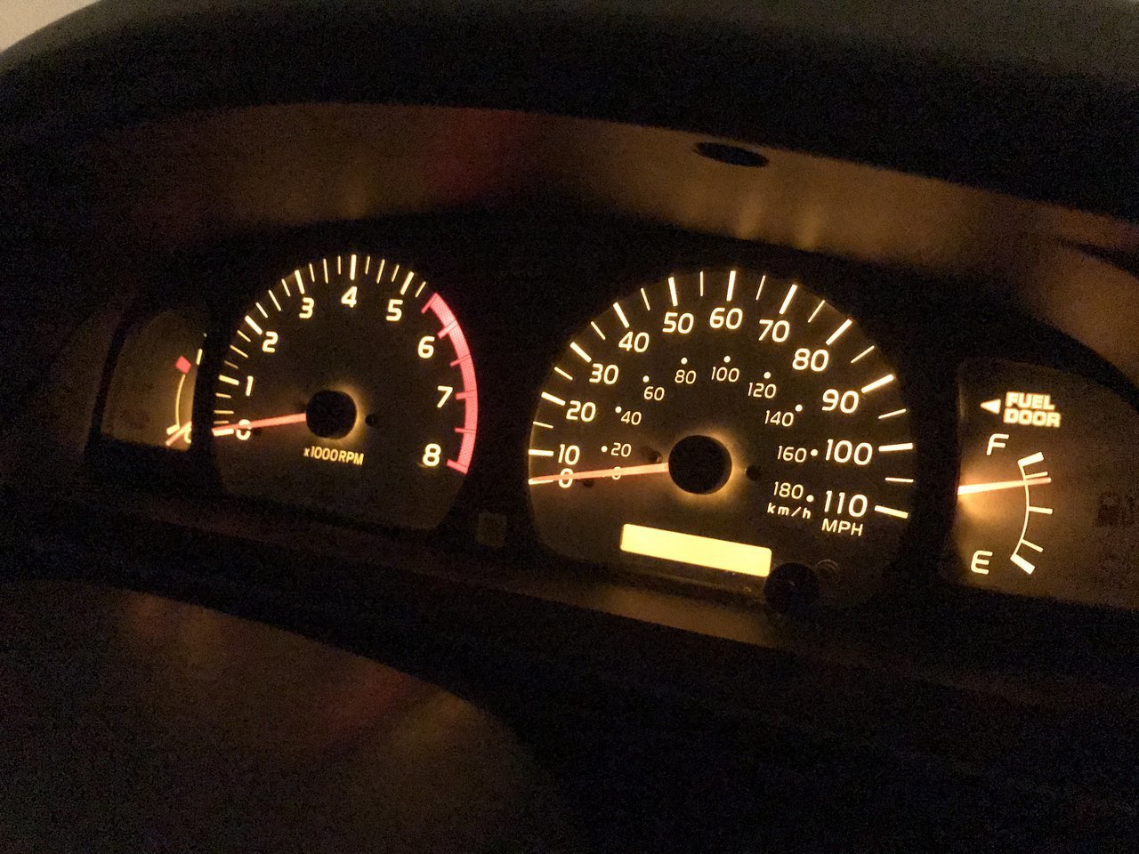

    I just did the Superbright LED in cool blue on the 4 main bulbs in the cluster and the low fuel bulb.
    Now the Cruise, ECT and low fuel don't illuminate. Is it possible that the one bulb for the low fuel is incompatible with the ECT, Cruise, and thus makes none of them work? They all worked before. I have a nice cool blue lit dash now and wanted to leave the other bulbs stock for better warning capability.

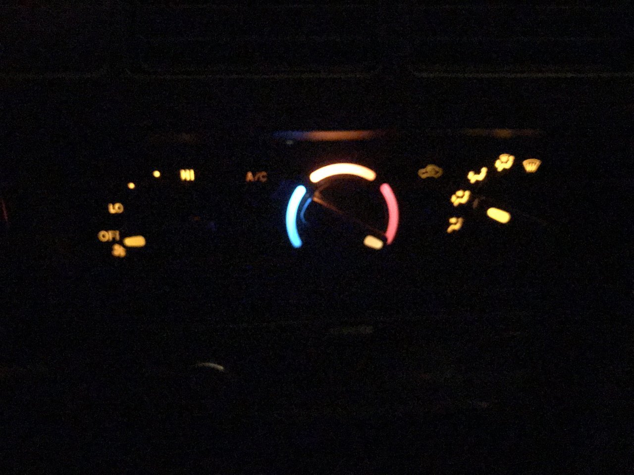

    2. If you are doing your air control knobs get one white NEOx 4mm even if you change the color of the rest or stick with orange. The colors for the air temp are a plastic blue, orange and red. The white will keep the colors

    When I changed my HVAC bulbs, I had to get a HVAC Unit out of a 3rd gen 4Runner since the Tacoma faceplate has that orange film behind it which blocks the other colored LED's from shining through. You won't get a true blue or white color shining through if the orange film is blocking it.
