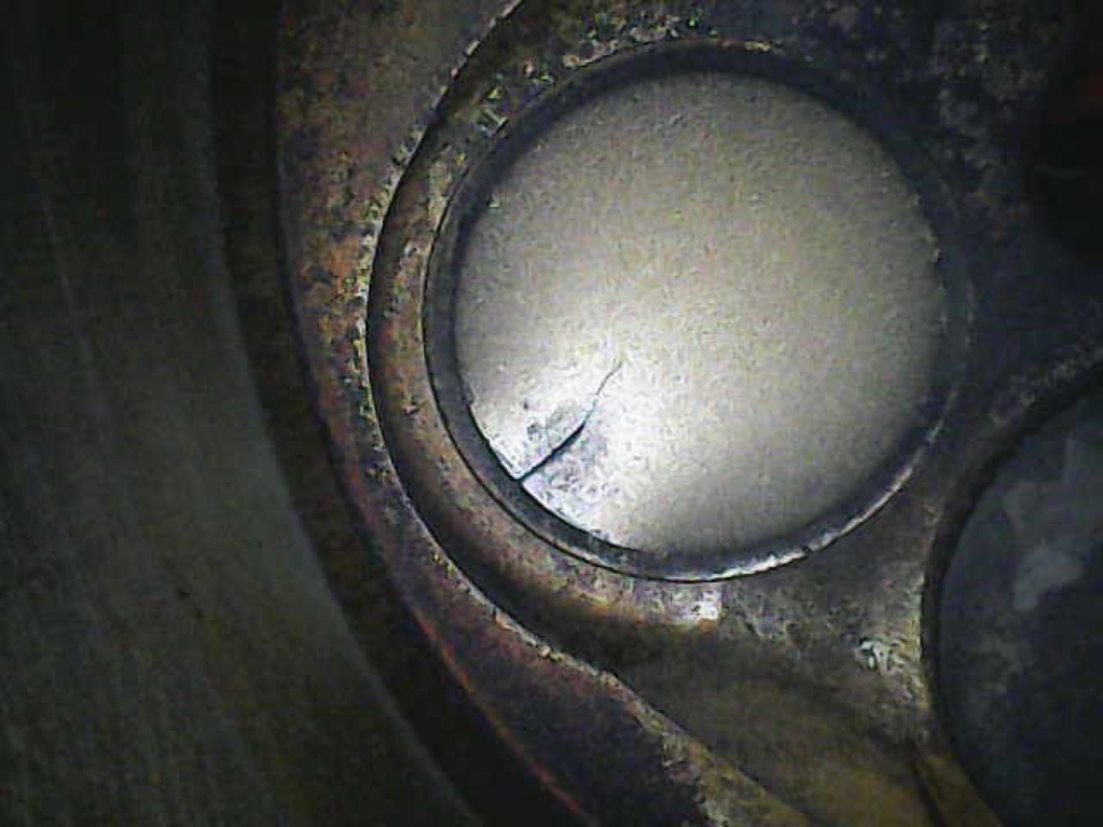

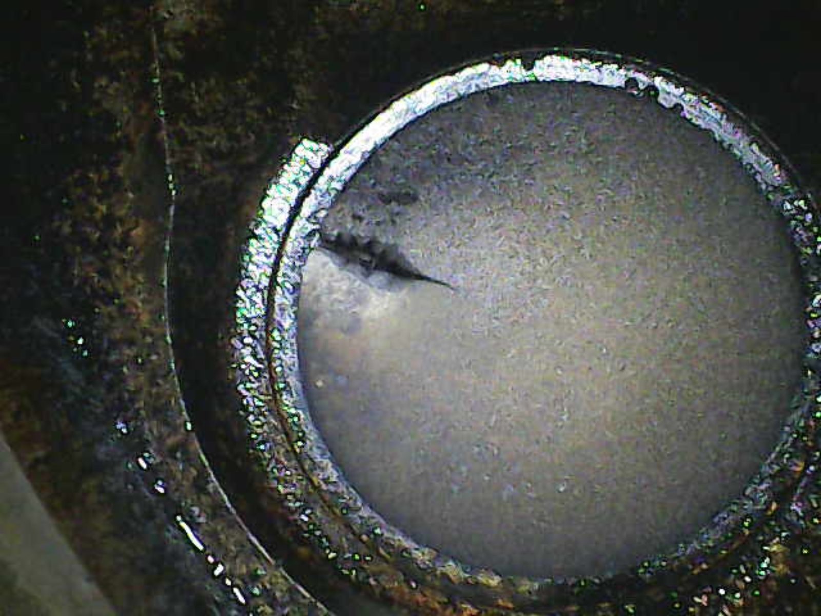

    Bringing this thread back to life as I was going through a similar situation. I was lucky to avoid the removal of my heads to view the valves though by using this guys borescope trick:
    https://youtu.be/KLyy8ZCNYv4?si=kLBDgXSzdDzqk8XG
    I just pulled the spark plugs from my problem cylinders (#5 and #4) put in the borescope and got these pictures. A lot quicker and easier than pulling heads! Now I have to figure out what to do with my cracked exhaust valves…
