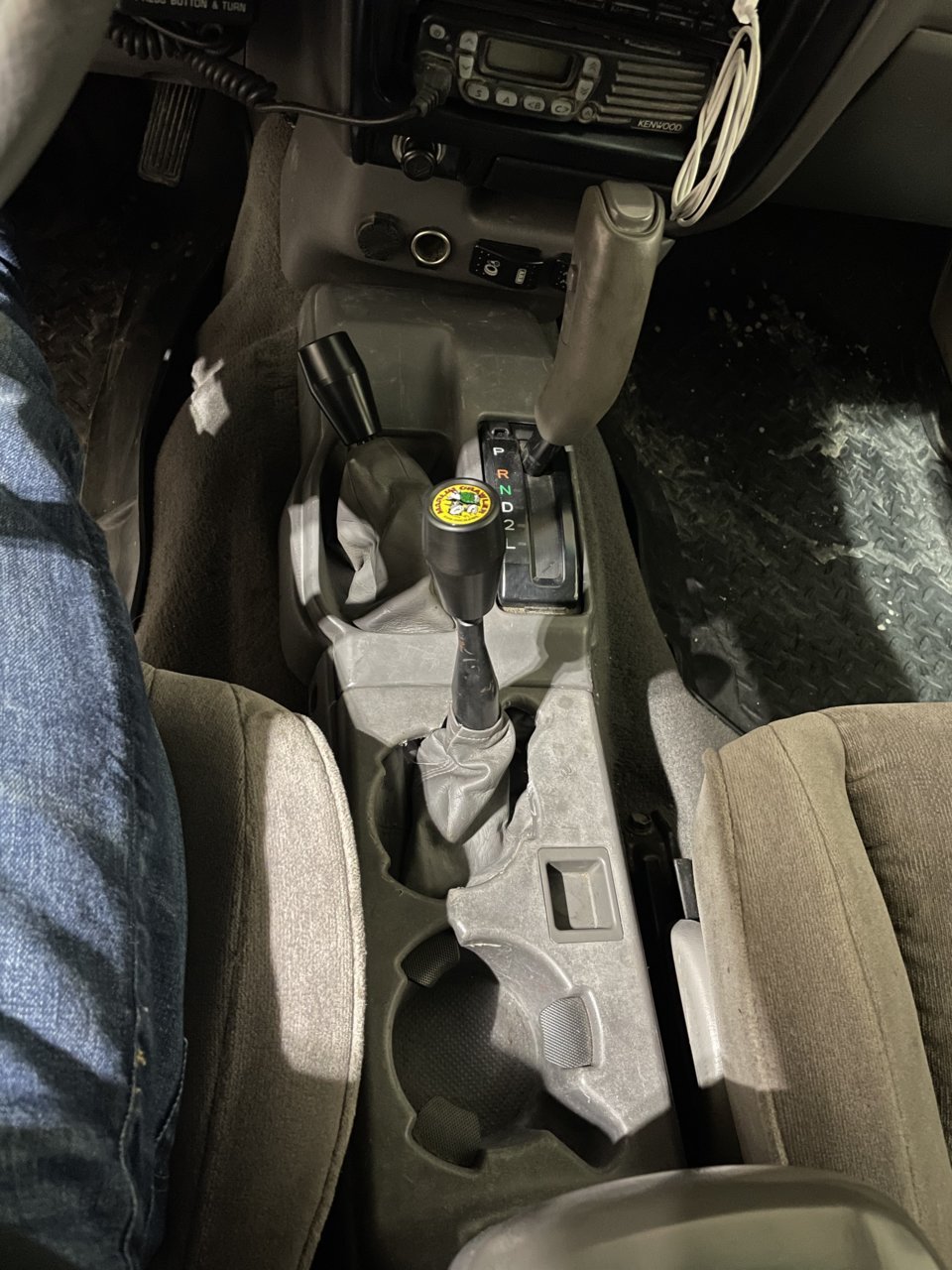

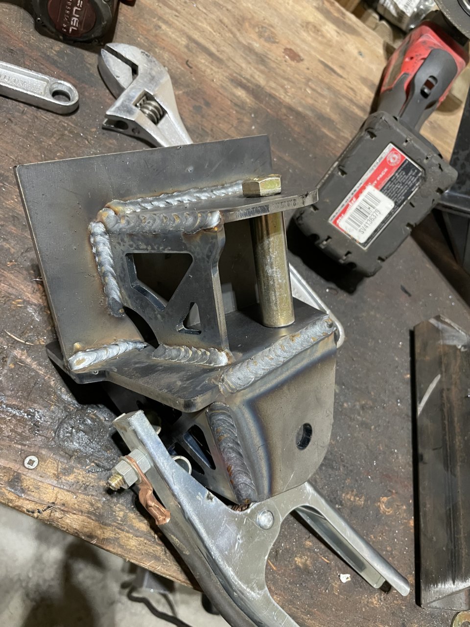

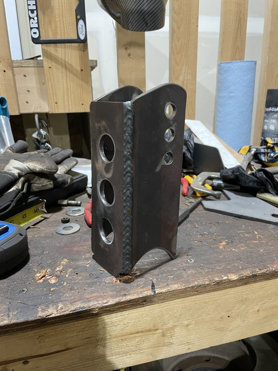

    Wasn’t happy with any of the upper axle link mounts I was finding online (size and height options, also in Canada so $$ to get one shipped up here alone) so I opted to build my own. Also got the interior sorted out, shifters are sealed and booted. Pretty happy with how it turned out. Used another stock shifter boot for the rear shifter, remolded it and glued/screwed to the bottom of the original cup holder.
    Also have a psc power steering pump from my tj I’m going to try to use. Should fit good from what I understand.

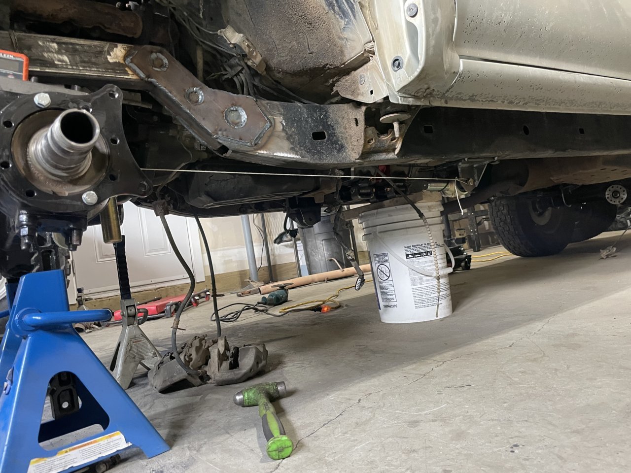

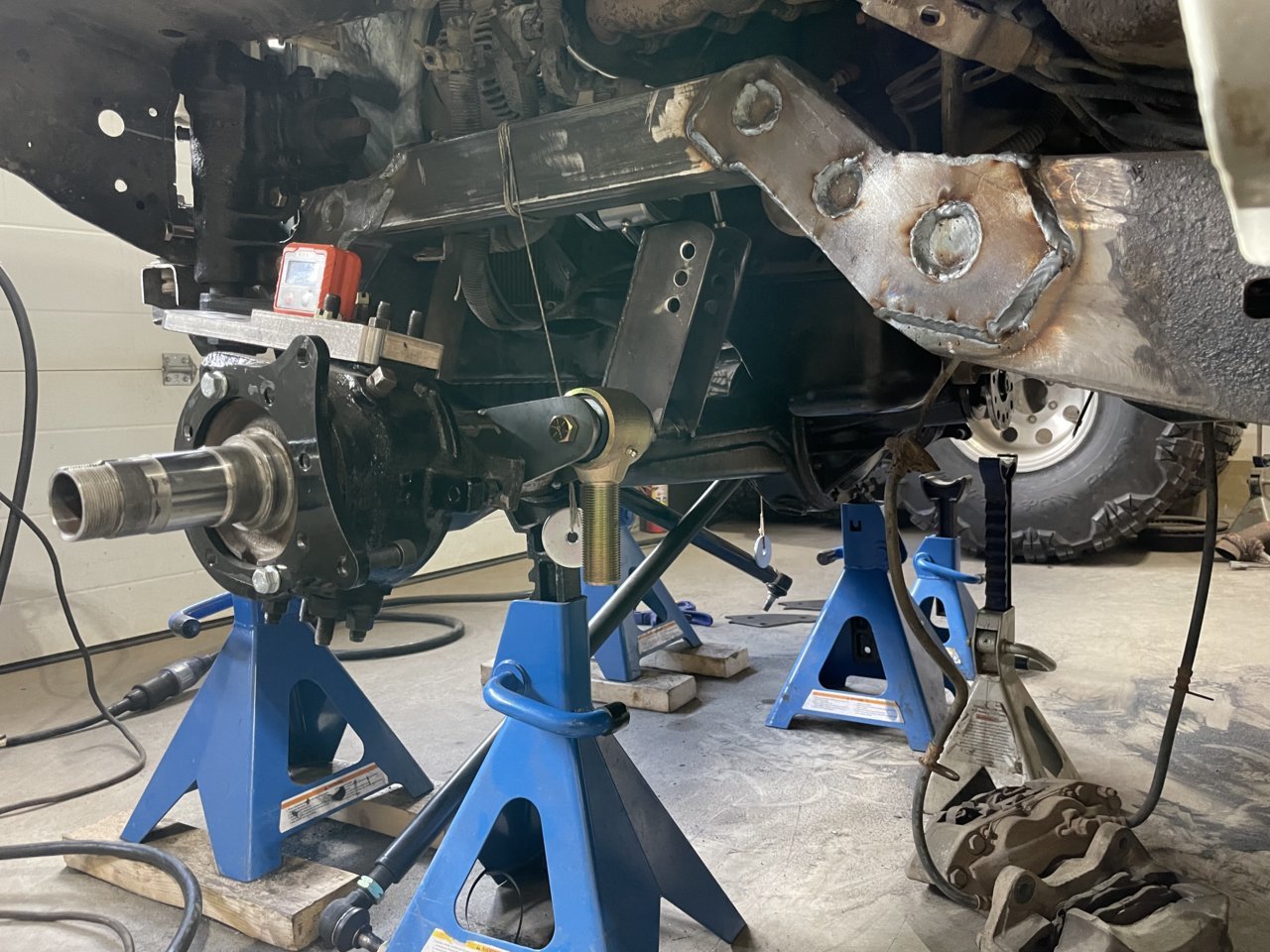

    Welded all my brackets out, cut off the factory crossmember and tacked the link brackets in. Plugged the numbers into the calculator to see how it looks, overall pretty happy. Not much I could really change if I wanted to though without buying all new brackets.
    Looks like the lower link is going to get into the frame at full bump so I’ll decide what to do once I start cycling it. Exactly 1 inch from string line to frame, so I can likely make it clear 06FCBDE0-7FF6-475D-B4CC-978A107558D3.jpg

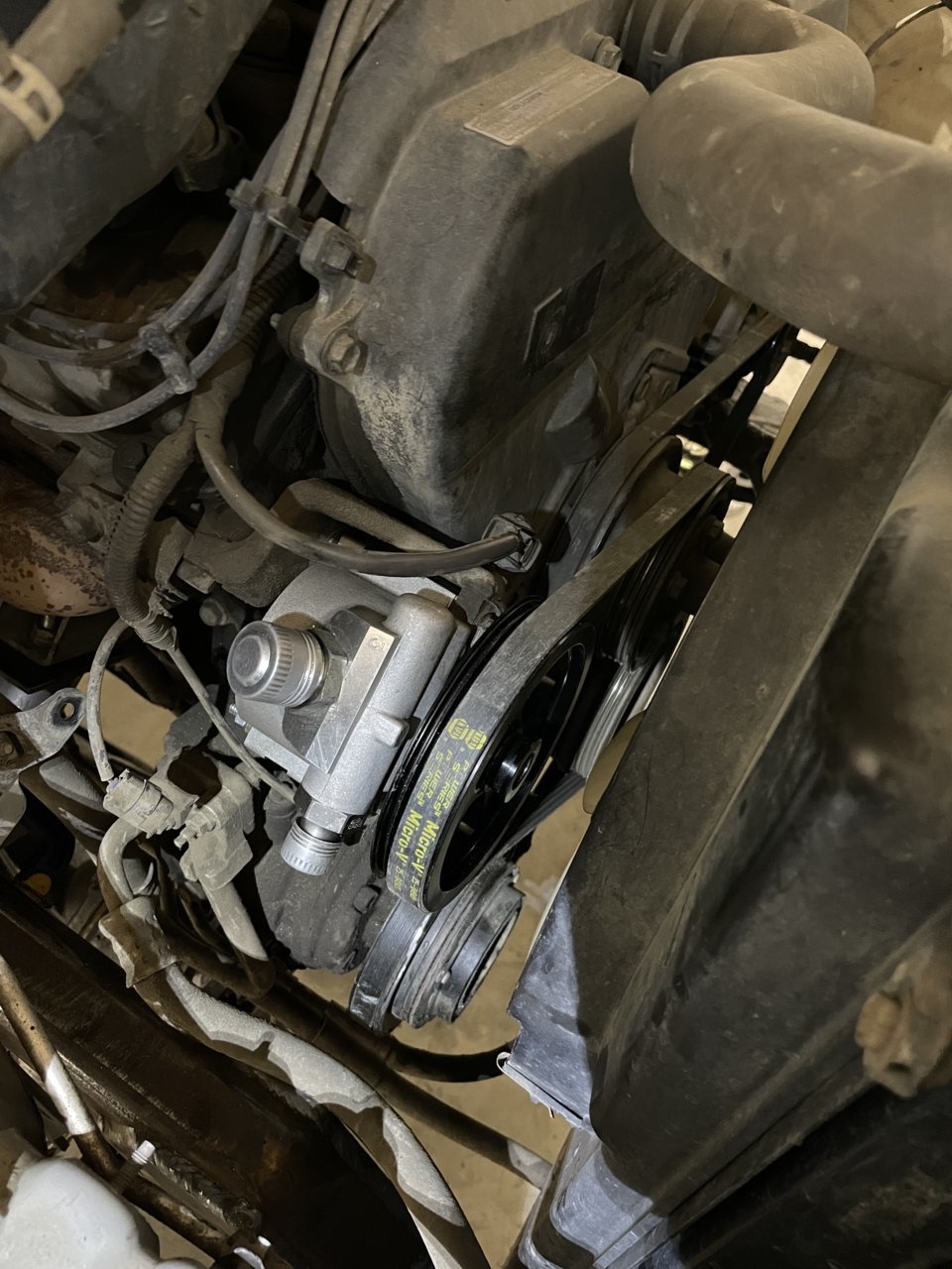

    Also got my spare tj pump in. Almost bolt in, just a spacer had to be put in behind it. Will need to swap pulleys yet but I’ll wait until I see how the steering feels with this pump. Found a couple reservoirs but I think I’m going to use the Chase bays baffled reservoir. Seems like the best bang for my buck.

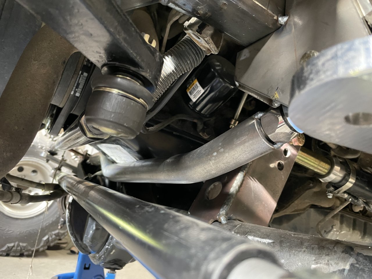

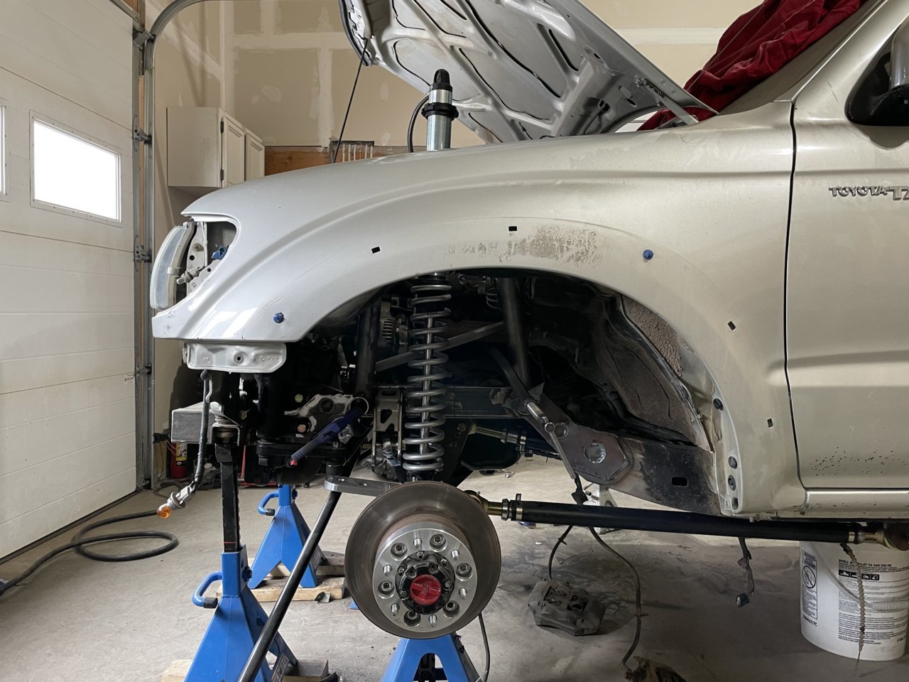

    Got some mock up links in, panhard in place, coilover mounts and shock hoops tacked in. Need to make some inserts to change my tie rod to under the knuckle, then I can cycle everything and adjust.
    Once everything clears I can move on to frenching in the air bumps into the frame. Hoping by the end of next weekend it should be a roller and then just need to order drivelines, paint the bed and trim fenders.
