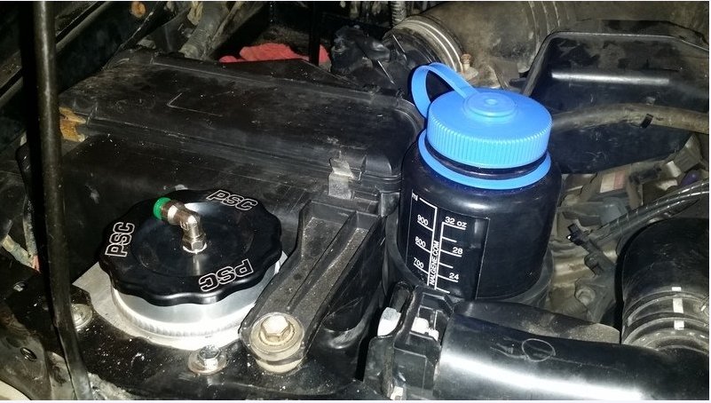

    anyone have any washer bottle recommendations? Things are tight in the engine bay. Not looking to drop $150cad on a scarab bottle and mount. Tried a smaller dorman one but it’s still too big

    Nalgene bottle, basically indestructible and decent capacity.
    https://www.tacomaworld.com/threads/project-dbl-blk-◇-by-toyryd.357381/page-4#post-10400435
    (2) Quick fist mounts on the air box
    (1) Nalgene bottle
    Drill Hole for oem washer pump
    Re-use grommet and pump, all wiring will already reach as well.

    Visit your local home improvement. I made a washer bottle a few years ago out of 2.5"OD PVC pipe that is 12" in length with a 45° elbow and placed it by the intake/radiator. Worked fine and sold out with the truck. Cost me maybe 20 buck for glue, pvc, enclosed cap, and a threaded end with cap.

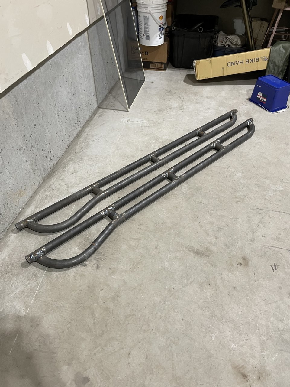

    After being a bit burnt out from building and taking a pretty good break I got back at it and started building some rock sliders yesterday. Always tricky to get back into tube bending after taking a break

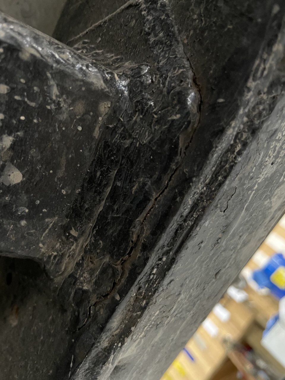

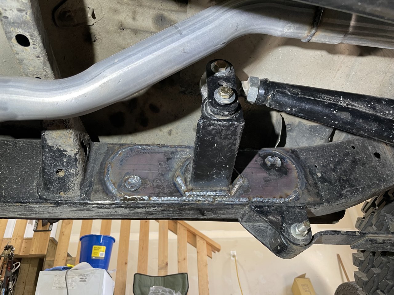

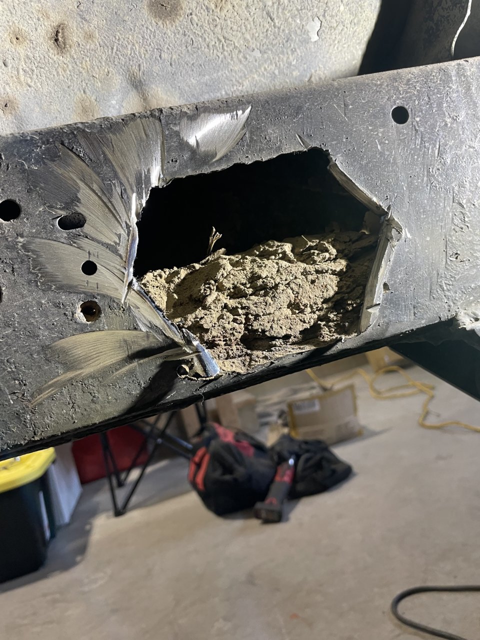

    Well I had my first failure. Noticed I’ve been getting quite a bit of torque steer. Forgot I was working with a thin Toyota frame, should have made this plate a lot bigger to distribute the load of the anti wrap better. So now is a good time to down the truck and get the sliders installed, and maybe do the inner fender work/battery relocation and air box delete to get the uptravel I worked so hard for in the front, tired of riding bumps all the time.
    Borrowed a buddies tube notcher to finish these sliders. Quite enjoyable when you’re not grinding to notch every piece of tube.

    Repaired the cracked part of the frame this morning. Cut it out, put a patch plate in and then did a fish plate with 4 holes for rosette welds.
    And people wonder why toyota frames rust, I can’t believe the amount of dirt I’ve pulled out of this frame so far. May cut open the driver side to empty it out too. IMG_2387.jpgIMG_2397.jpg

    For additional strength you could tie that connection point into the crossmember in front of it. That's typically how I've seen traction bars mounted on these trucks
    dzuf[OP] likes this.

    That’s my plan as there’s no real better way to brace it to counteract the torque it’s seeing without building a new crossmember or something.
