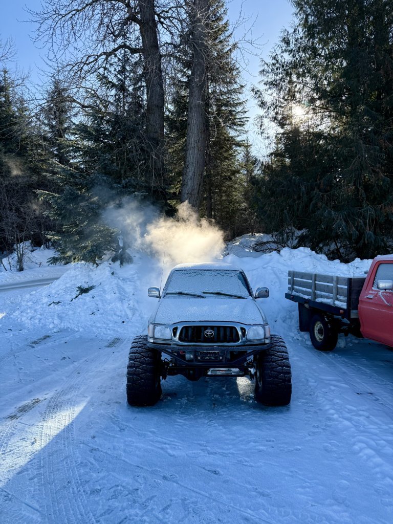

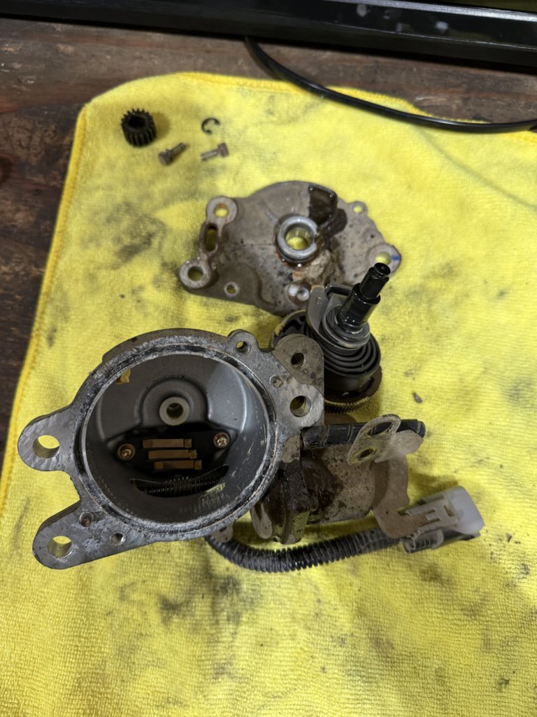

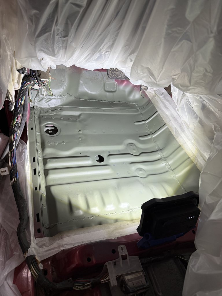

    Busy couple of weeks lately. New floor board and cleaned/retimed/grey wire modded the e locker the new Tacoma, back half/63s on my brothers Tacoma, arb compressor install for a friend, and a quick fire in some snow!
    My new red Tacoma will be getting a rear frame section next to address some rust. And while the interior is fully out anyways, I’ll do some sound deadening. I took the carpet to the car wash and got it looking much better!IMG_7727.jpgIMG_7604.jpg

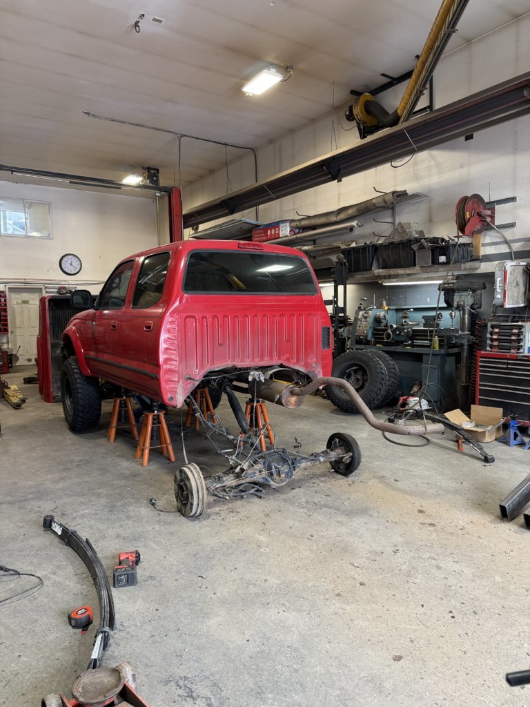

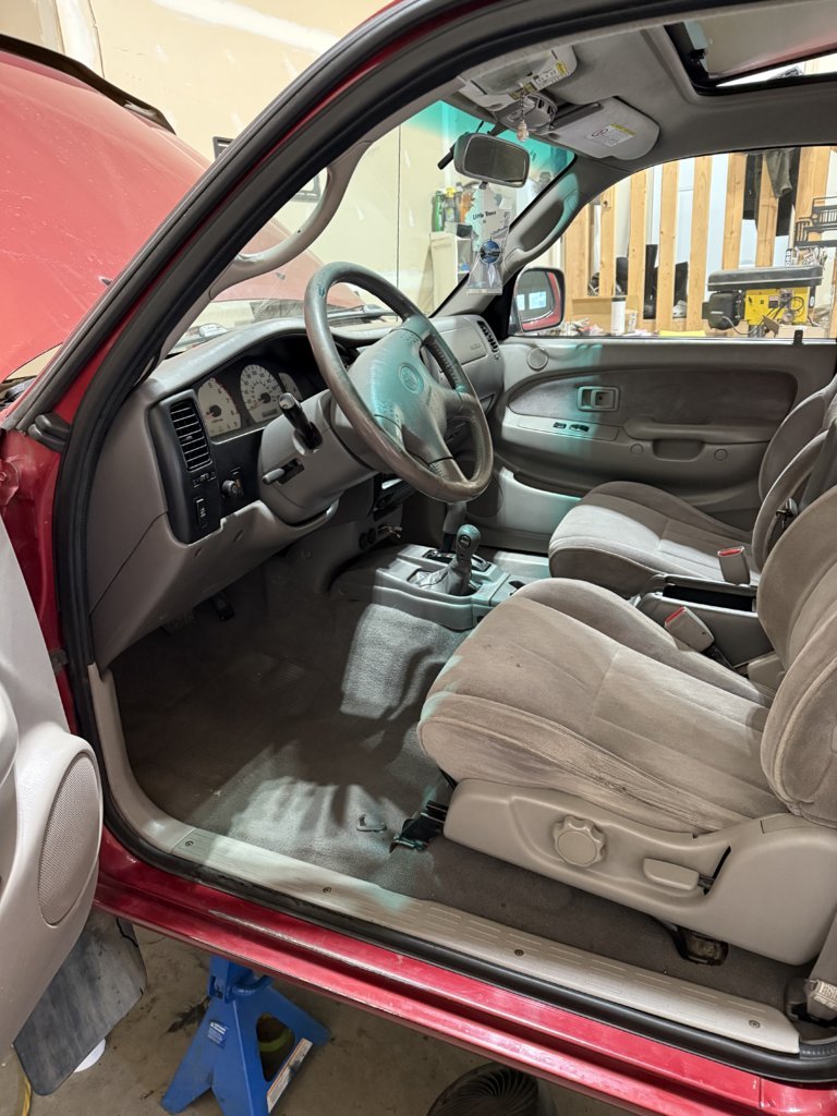

    I should probably make a thread for just the “rebuild” of this truck, but this is easier. Floor is done, interior is back together and bed is off for frame work!IMG_7821.jpg IMG_7842.jpg

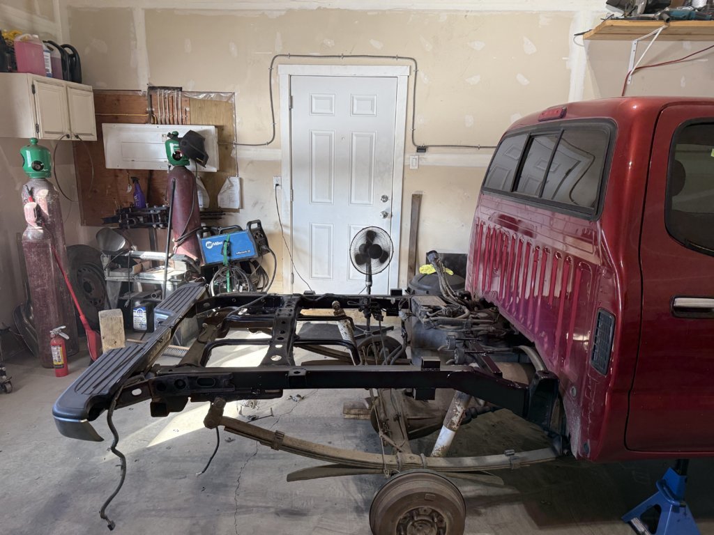

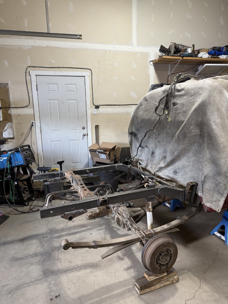

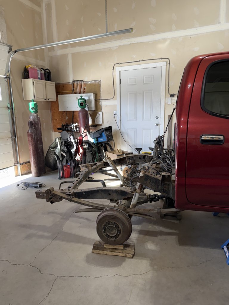

    Sawzall blew up 98% through the first frame rail so I was at a stand still. IMG_7852.jpg

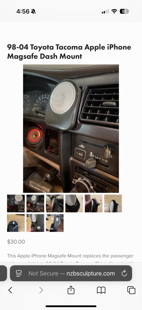

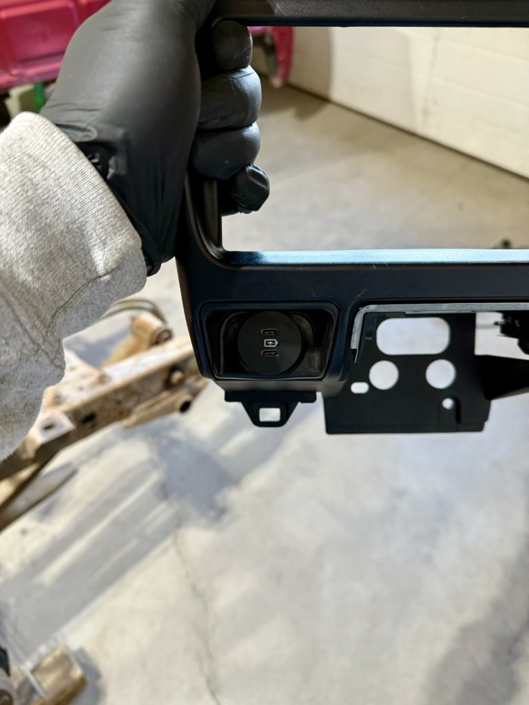

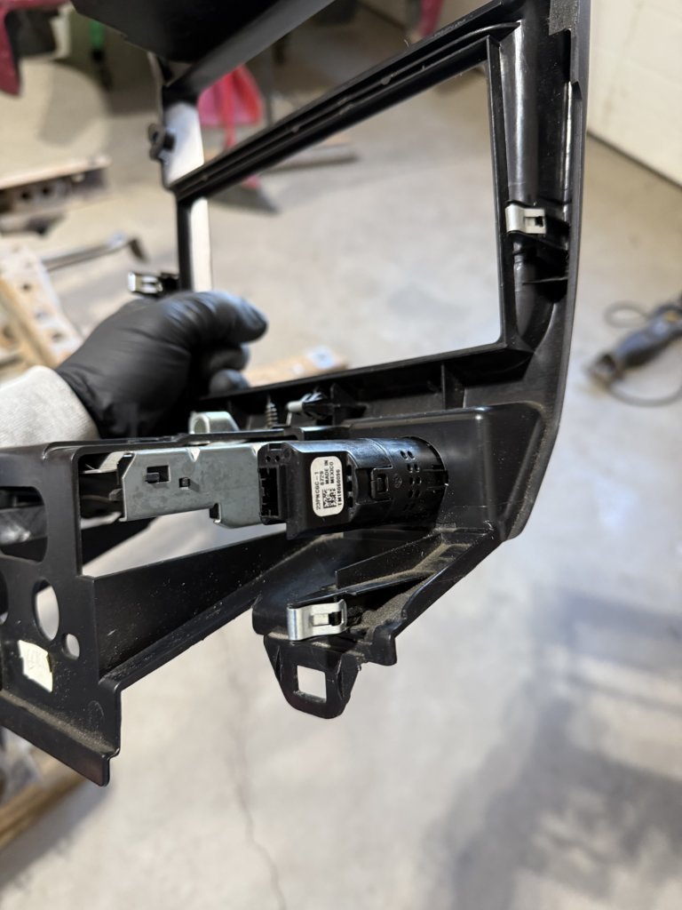

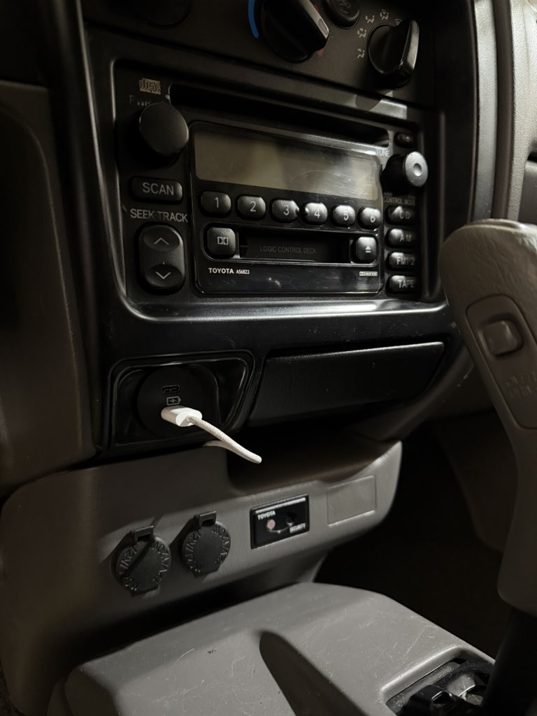

    Ordered a couple of these mag safe charger mounts (one for each truck). Still waiting for them to get here so I ran the mag safe and put in a USB-C power supply.
    New superduties have these dual USB outlets in them, which just so happen to fit almost perfectly in the original cigarette lighter hole, then wired it to the cig lighter wiring. I’m a big fan of clean accessory installs, especially when they look like they’re meant to be there. Super happy with this one. It’s the little things!IMG_7854.jpgIMG_7855.jpg

    You have a P/N for that Super Duty dual USB? Can't quite make out the text on the photo.
  14. Jan 30, 2025 at 7:53 AM
    #174
    dzuf
    dzuf [OP] Well-Known Member
    Sep 12, 2022
    #405644
    145
    Darcy
    British Columbia, Canada
    PU5T-19J211-BA for the usb plug
    WPT-1822 For the pigtail

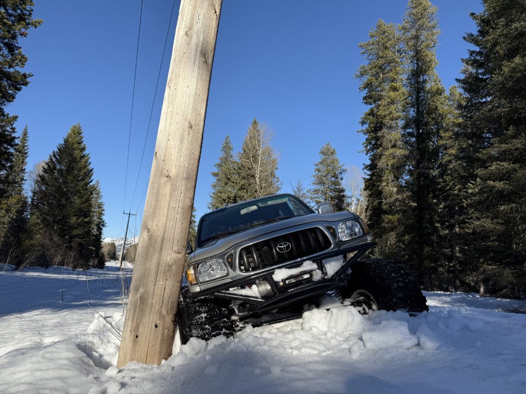

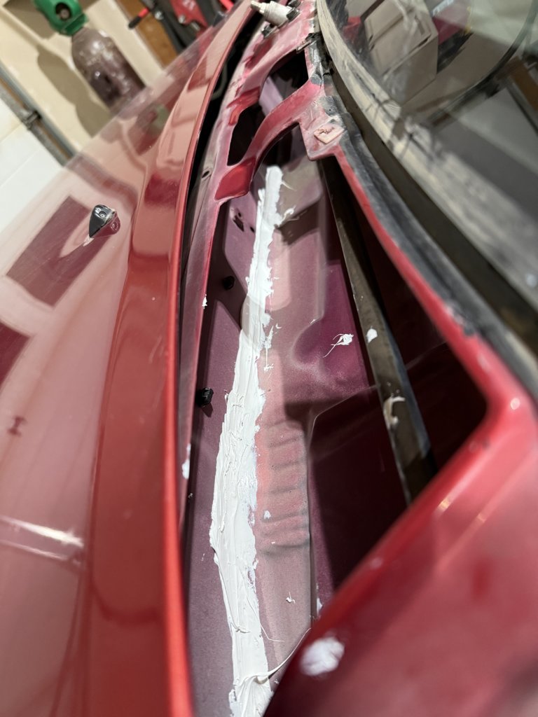

    Solid days off! Finished up the red truck completely with some steering rack bushings and then found the carpet soaked after a good rain. Turns out there was a TSB for water leaks through the firewall. Did some seam sealer inside the wiper cowl and that sorted that out.
    Took the silver truck out wheeling a couple days. Came a little too close to a telephone pole while cruising out and the soft snow pulled me off the trail, luckily the front wheel stopped me before I hit body!
