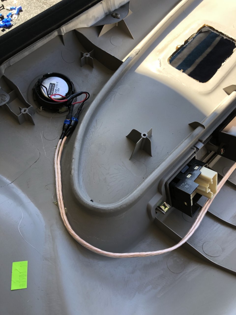

    X2. I used some Infinity 6822cf speakers http://www.crutchfield.com/p_1086822CF/Infinity-Reference-6822cf.html?search=6822cf&ssi=0&tp=92 They are discontinued now, but they have a replacement pair that are basically the same. I put them in all four doors. Like mwild, I just had to do some cutting on the spacer (the black plastic thing that goes between the speaker and the metal on the door). It was a bit of cutting but a Dremel or a jigsaw can take care of it. The magnets on the Infinities were much larger than stock and that is why cutting is needed (it is only plastic that needs to be cut).
    Front driver's door
    At a later date, I put some mass loader on (pictured) and then put some sound absorbing material over that (not pictured). Sealing up those large access holes really helps bring out the mid bass. Rear door.
