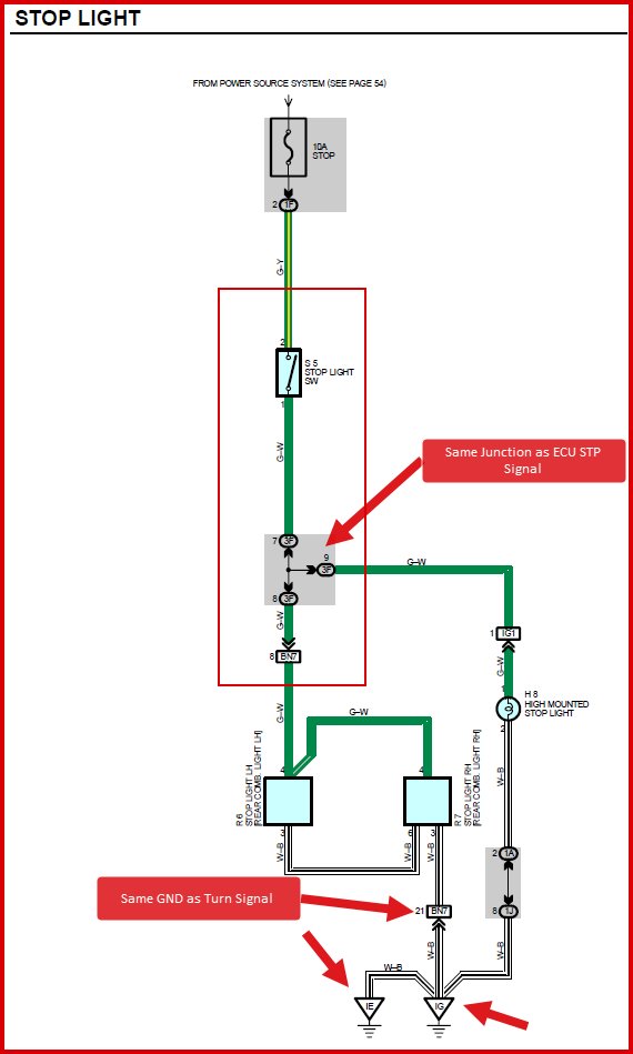

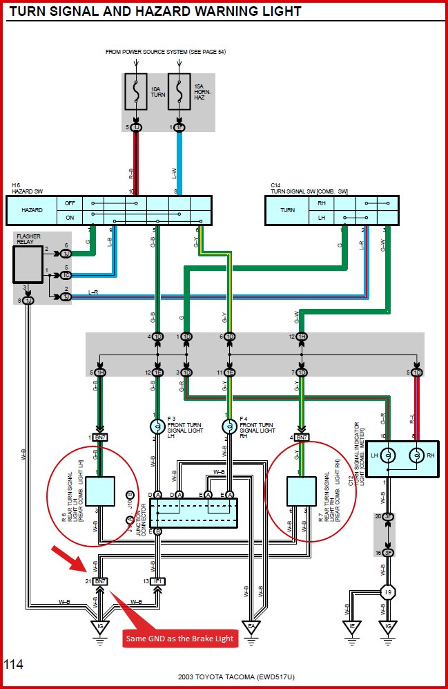

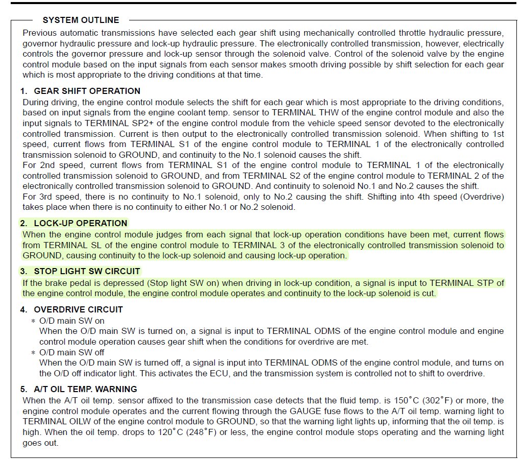

    I may have a lead here. This is from the Wiring Diagrams in the FSM regarding the 4th gear shift (aka lockup, aka overdrive). I've highlighted the sections that I think are key:
    This is my current theory: The turn signal wiring is not grounded properly or shorting. The stop switch circuit has a residual voltage. This voltage is causing the transmission to be "tricked" into thinking the brake is being applied, and thus takes the transmission out of overdrive, causing the fluctuating with every turn signal flash. This short could be explained by faulty trailer harness wiring or shorting, as the trailer harness typically taps off the rear light housings.
    I think with this info, I will be checking the grounds, stop switch, and perhaps poke around with a multimeter to see if I can find the stray voltage. I've added some relevant wiring diagrams if anyone cares to follow:

    See my post above. If the truck is "tricked into thinking" the brakes are being applied, it would cancel cruise control.

    Definitely did not update like I said I would. Here's what happened:
