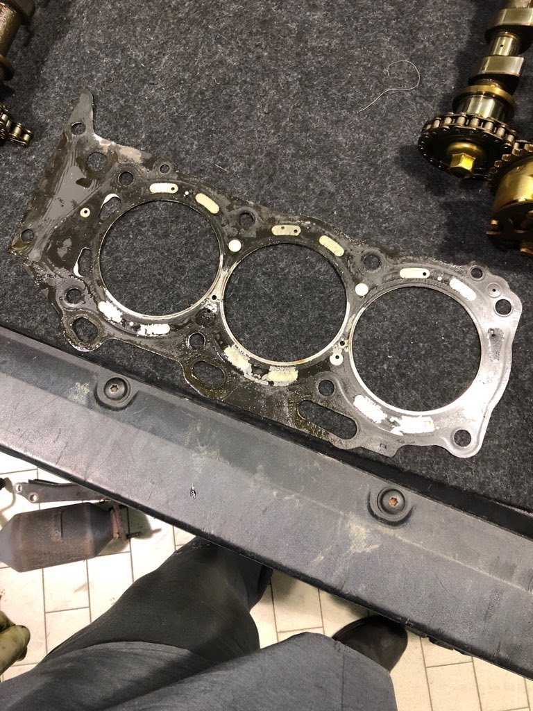

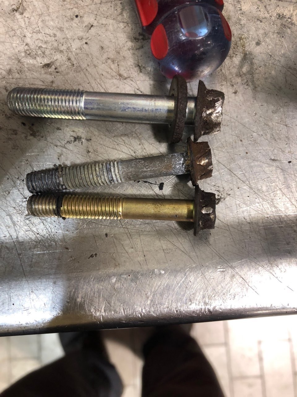

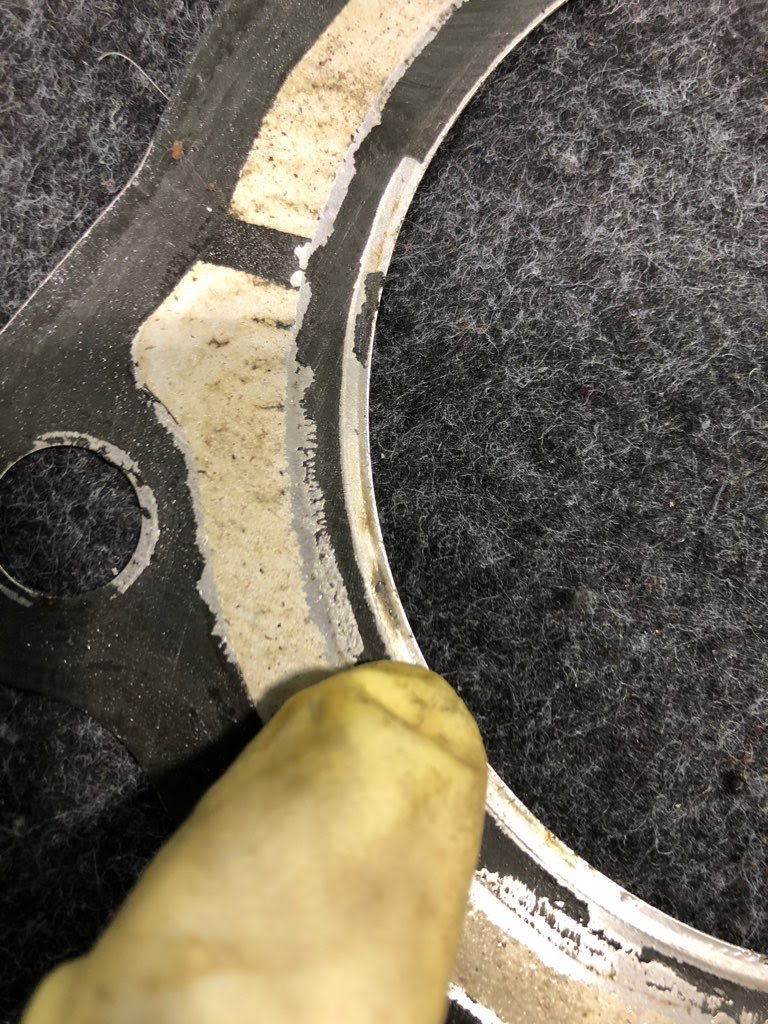

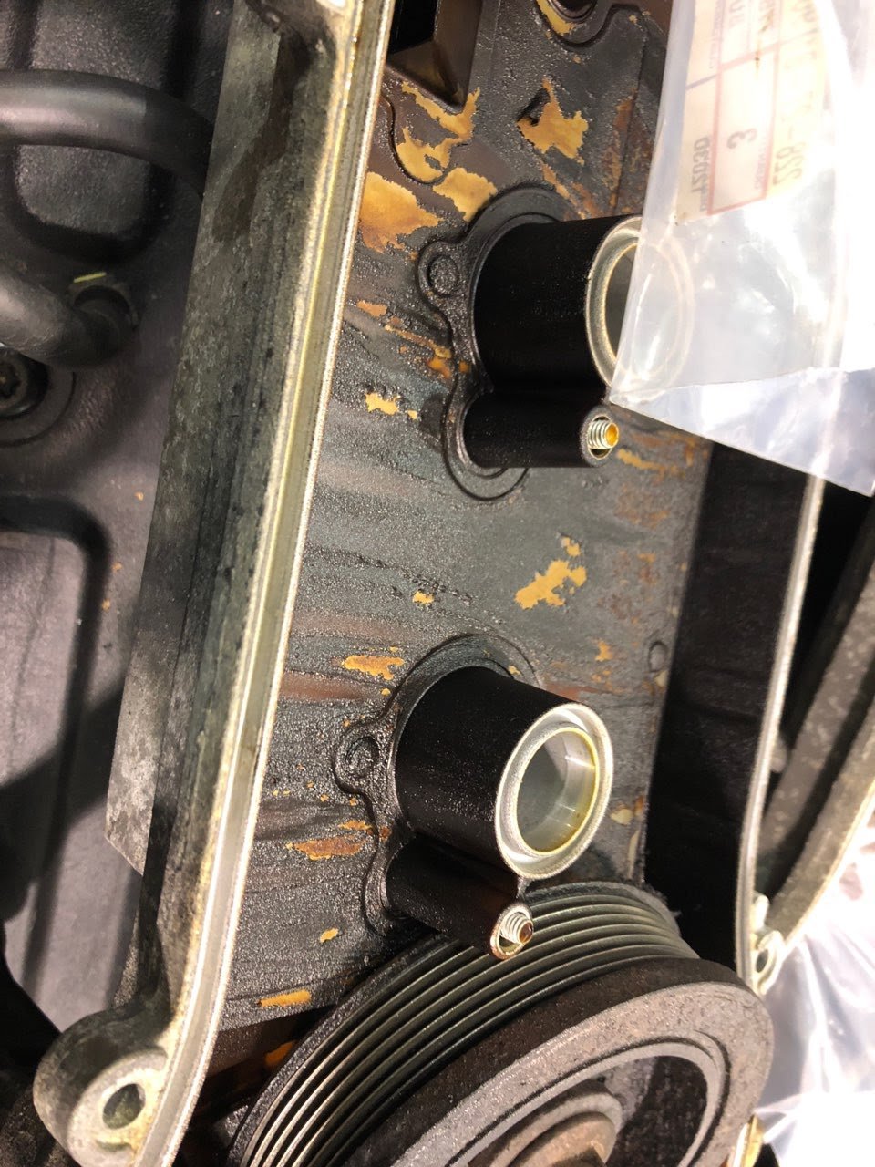

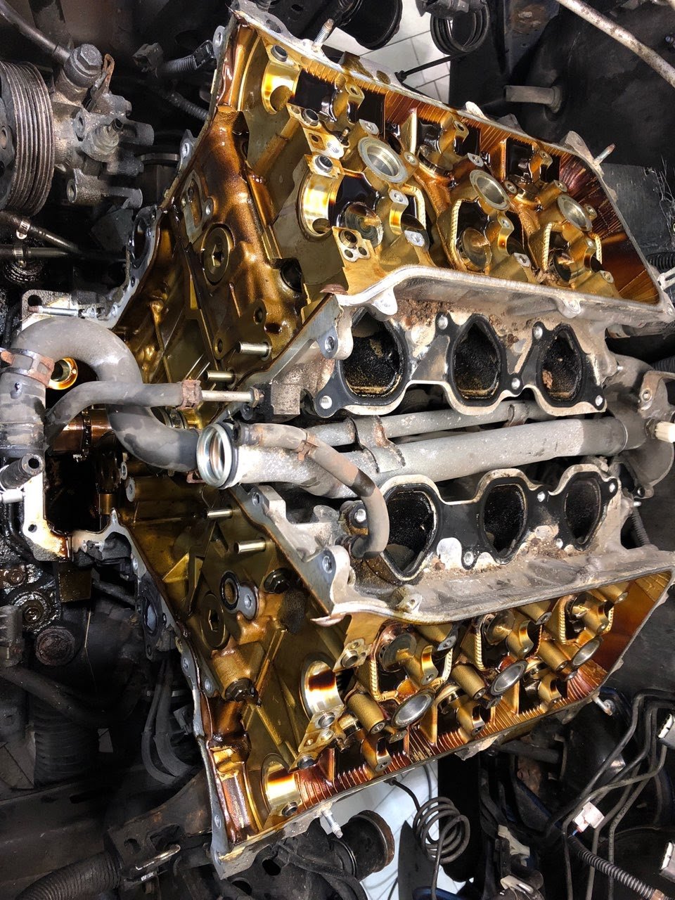

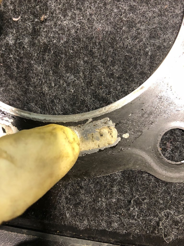

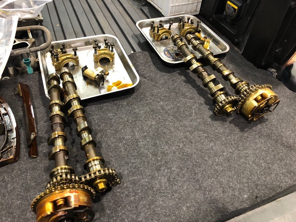

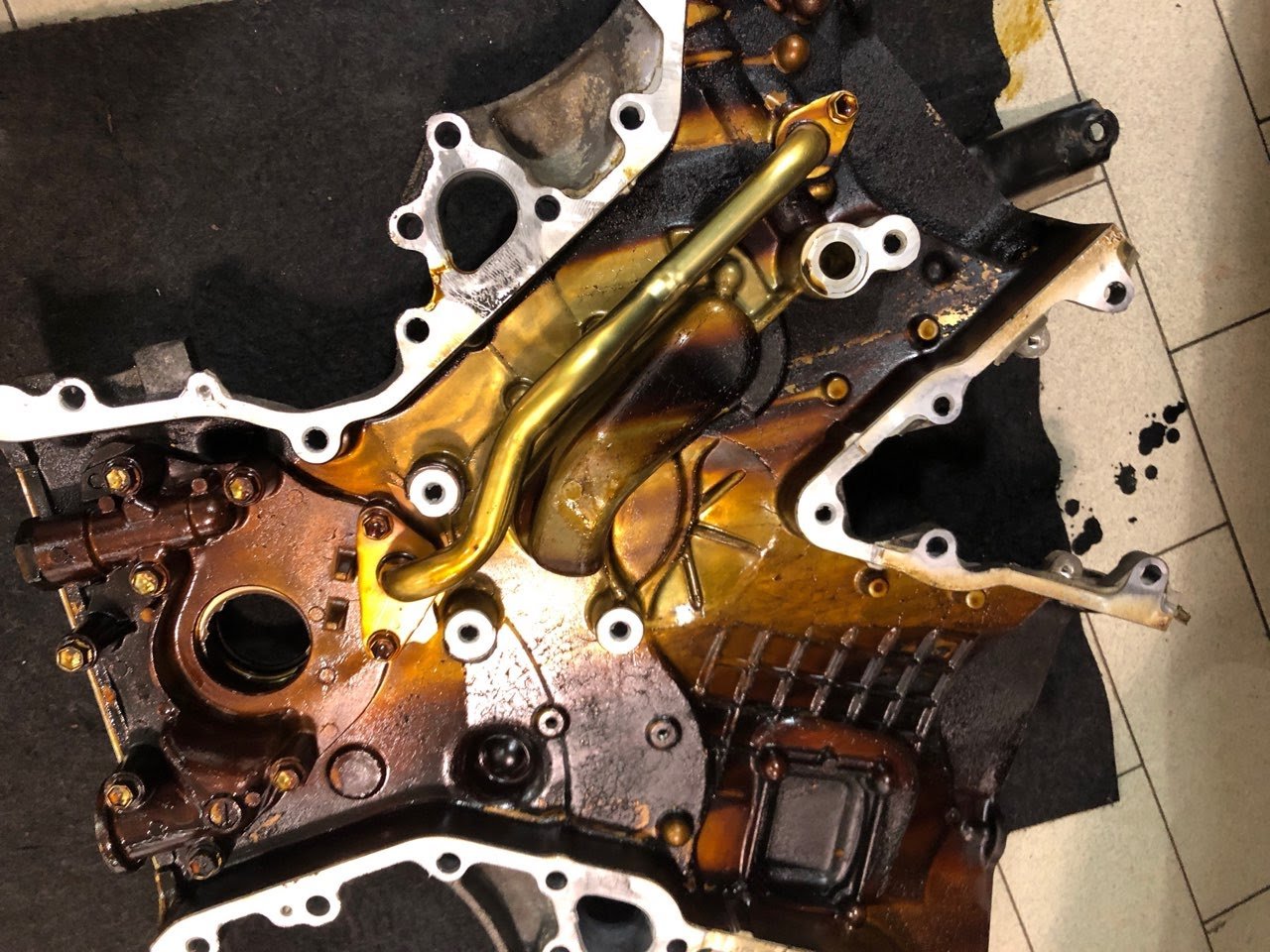

    Got some pics from inside the OR today from the techs. 134,000 miles. Will be ready for pickup today. You can see where the head gasket blew. Last pic is stripped alt bolts. Had them do that as well, no additional charge. Gave them the alt from a 2015 Taco with 35k miles to swap, since it had to come off anyways.

    Congrats @Benny123 !! You made the right decision esp
    w the lifetime warranty and ‘official’ fix now logged in the Toyota system. If you wouldn’t mind, could you post the the out the door price was for everything?

    Technically, the only things to deal with, on a '12+ going into an '11-, is swapping the valve covers and headers from the original engine.
  20. Jan 4, 2019 at 1:30 PM
    #40
    Torspd
    Torspd Tor-nication
    Sep 18, 2009
    #22958
    26,452
    Tor
    The Great America!
    MMVI 4.4L 4x4 Access Cab
    Torspd Custom Turbo kit [] Borg Warner 9180EFR Turbo [] Haltech Elite 2500 [] TiAL Q BOV [] TiAL V44 Wastegate @ 15psi [] CP Pistons [] CP Carrillo Rods [] ARP Head studs [] ARP Main Studs [] ARP Header - Head Studs [] Ported Heads w/ 1mm oversized valves intake/exhaust [] Brian Crower Forged Stroker Crank [] Darton M.I.D. Sleeved Block [] Kelford Camshafts [] Torspd 160* T-stat mod [] APR Large Fuel Rail [] Walbro 460 LPH E85 Fuel Pump [] FueLab FPR [] APR T56 Conversion Kit [] KP RACING Built T56 [] McLeod Racing Custom Twin Disk Clutch [] One Piece Aluminum Driveshaft [] MGW Shifter [] Custom lowering kit [] Ohlins Front Coilovers [] QA1rear shocks [] Custom Ron Davis Radiator [] Dual SPAL Electric Fans []
    Glad you have it all sorted out!
    Judging by those crusty layers, the previous owner went far too long on service intervals. The oil broke down and hardened up.
    Maintain a good OCI, while keeping track of that level, and your engine will last you a long time.
