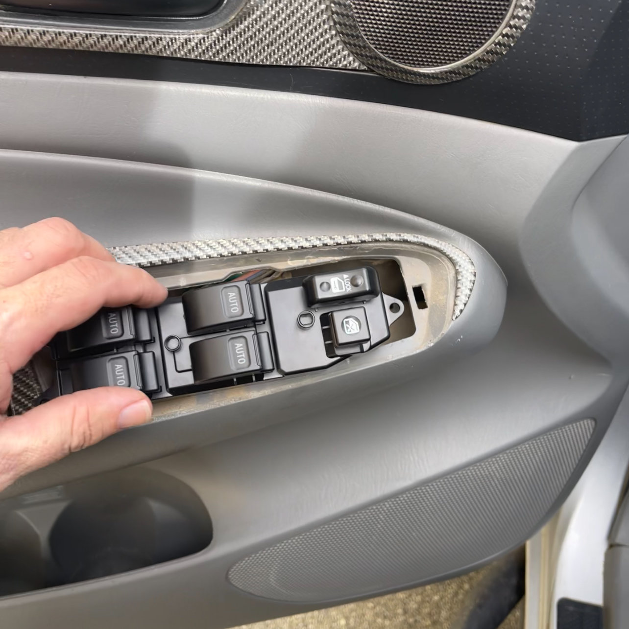

    Will do. Should function the same. Only thing that won’t is the lock button does not light up. Makes it easier for earlier ones that would rather not retrofit the newer version.

    Nothing exciting yet. Just tested a second one but not fully working.
    Preview of the switch though.
