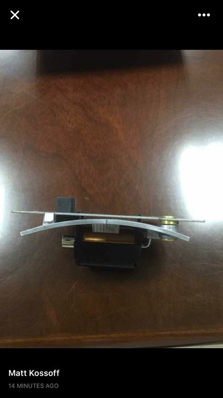

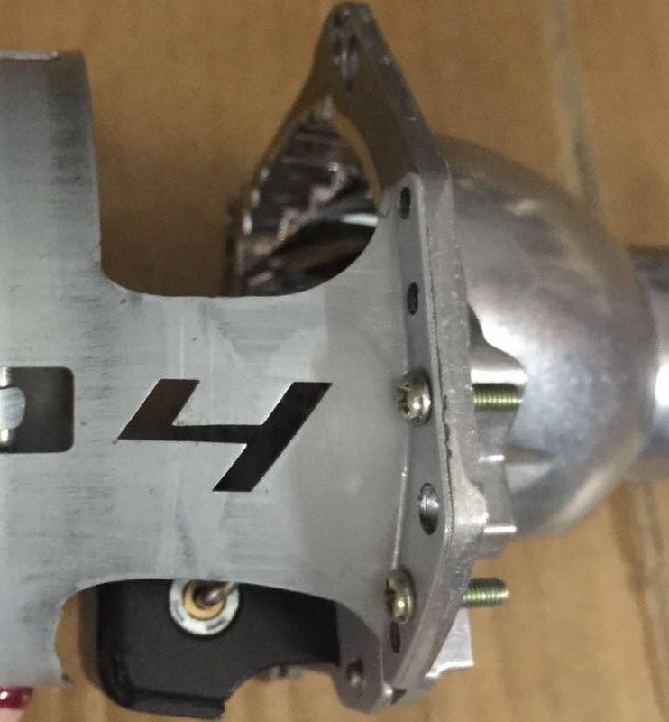

    The biggest change IMO is the curved shield vs the straight one before. Of course other little tweaks also such as
    -rear facing solenoid connector
    -front half is gonna change a bit
    - and other things.
    13083319_10107433901748225_1141481370183_9d2bb222c97adb7643c741ffcedfaf1b29210823.jpg
    A little different eh?
    Biscuits likes this.

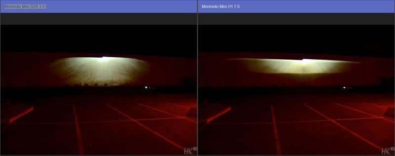

    No worries. I'll make it even easier to understand
    On the left is Mini D2S 3.0 with straight cutoff shield. On the right you have Mini H1 7.0 with curved shield. The width on the Mini H1 is definitely wider because of it's cutoff shield being curved. However, Mini D2S does have a bigger hotspot, so that means the distance is better vs the Mini H1. Both are great projectors still.
    So if you keep that intensity of Mini D2S 3.0 but add the curved shield of the mini h1 7.0, you get Mini D2S 4.0. :thumbsup:
