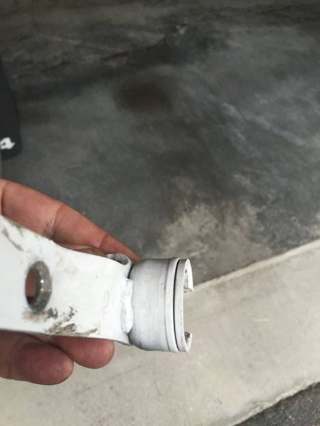

    Mine appeared to be a broken o-ring also, but if you look closely, it is a thin rubber tube that is cut and placed in the groove, held on by that flaking glue.
    After just fitting the rubber tube back in the groove and using lube before installation, the o-rings slid right on the hinge cup without dislocating.

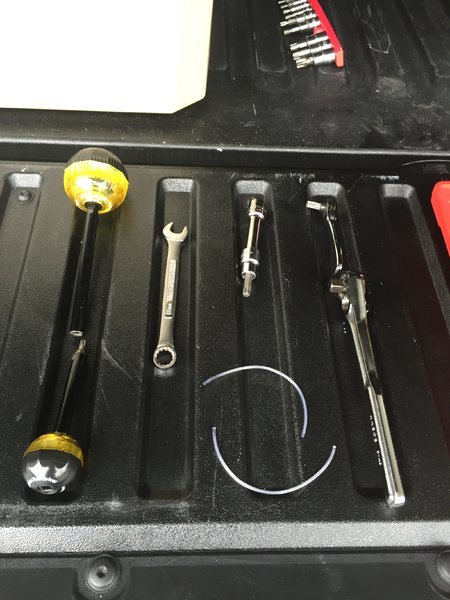

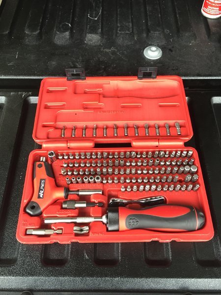

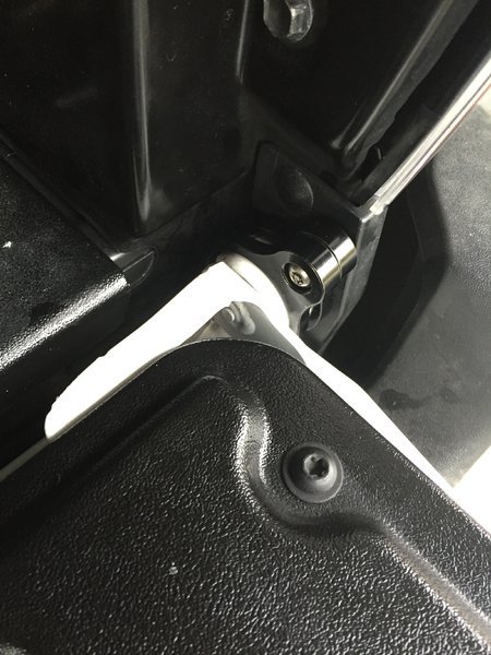

    Here are the tools used for to install....
    I can say this it is a pain in the ass but can be done as I did in 20 minutes...
    1- The inner rubber rings came off right away
    2- I removed the whole hinge cup or bracket whatever you wanna call it
    3- I then set ring in place with rubber rings not installed
    4- I then reinstalled screws loose to fit
    5- Attacked lower bolt from under truck by bumper opening
    6- I then tightened remaining screws
    7- I did install it with the screw facing in if I have to remove it for ease of removal
    7- Done
    Should at least give the ones trying to snag it enough trouble to move on to the next one or vandalize my truck since they can't get it.

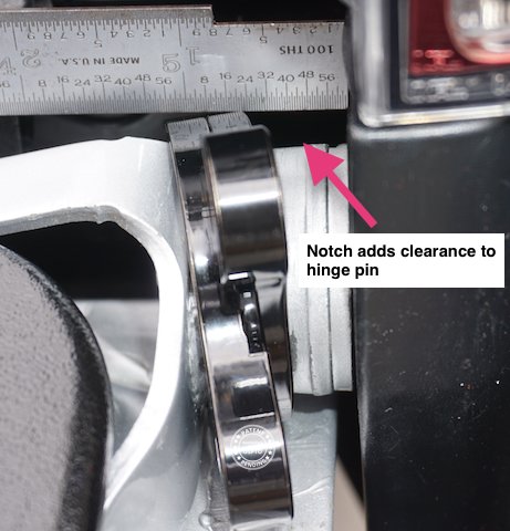

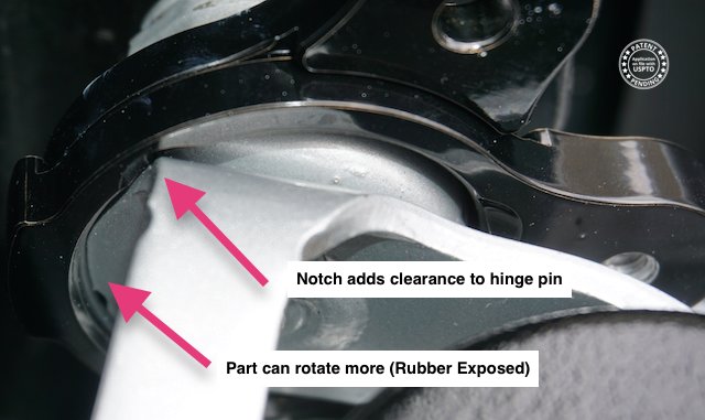

    Here is the first picture of version 2.0 with the mods in my previous post.
    Product updates:
    1. The grooves are deeper preventing the rubber from popping out.
    2. The inner diameter was reworked to have more clearance for easier installation over the hinge cup.
    3. The small notch a the top allow the part to clear the hinge pin
    4. The weld relief to the right accounts for not so optimal robot welds
    I have a few in stock, with more being machined in the shop.
    Hope this addresses everyones concerns.
    Version 2.0

    Having a hard time visualizing this, but shouldn't that top notch be on the outer ring instead of the inner ring, since the outer ring is the part that has to clear the hinge pin?
  12. May 15, 2016 at 12:14 PM
    #212
    scleaf
    scleaf [OP] Well-Known Member
    Jan 6, 2014
    #120062
    1,019
    Torrance, California. USA
    2013 Silver Tacoma TRD 4x4
    SaBellCo's Tailgate Lock :), Cable mod
    Actually, putting the notch on the outer side makes it less secure. Once installed and fastened the outer piece is what prevents the tailgate from being removed. The inner piece combined with the interlocking feature allows the part to get narrow enough to fit through the hinge. The notch on the inside allows the part to go farther to the left when facing the front of the truck and at a greater angle which adds the clearance for the hinge pin. Once the part is fastened the notch is no longer used.
