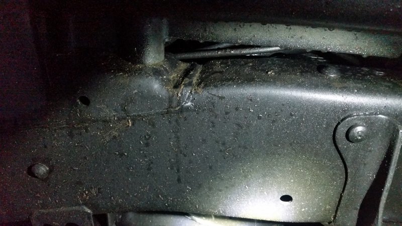

    Still throwing it back and forth between adjustable and fixed uppers. But I think the adjustable will be the best, 1 size fits a wide range of options.
    Here is a question to you owners. The anomaly across the cab and bed length options is the Double Cab short bed. It has a bed support nub on the driver side that I want to have owners trim so the upper mount has best possible support from frame.
    Are you guys OK with cutting some of it away down to the frame? It should be easy compared to cutting stock shock buckets off

    IMO, if you're cutting and welding to do a shock relocate, what's a little more cutting?
    As long as everything is still structurally sound, who cares?
