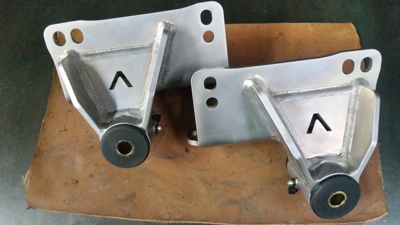

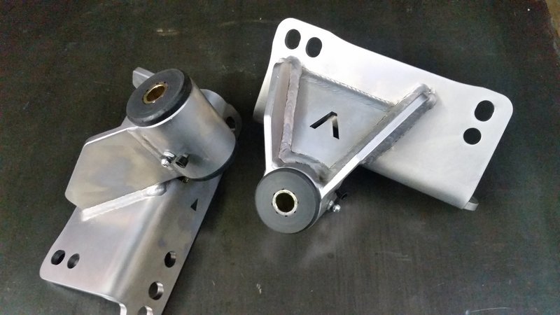

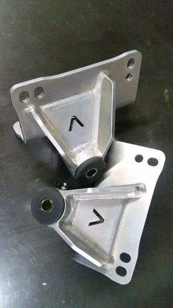

    Is that what the new set looks like that's about to ship out?

    Yes sir
