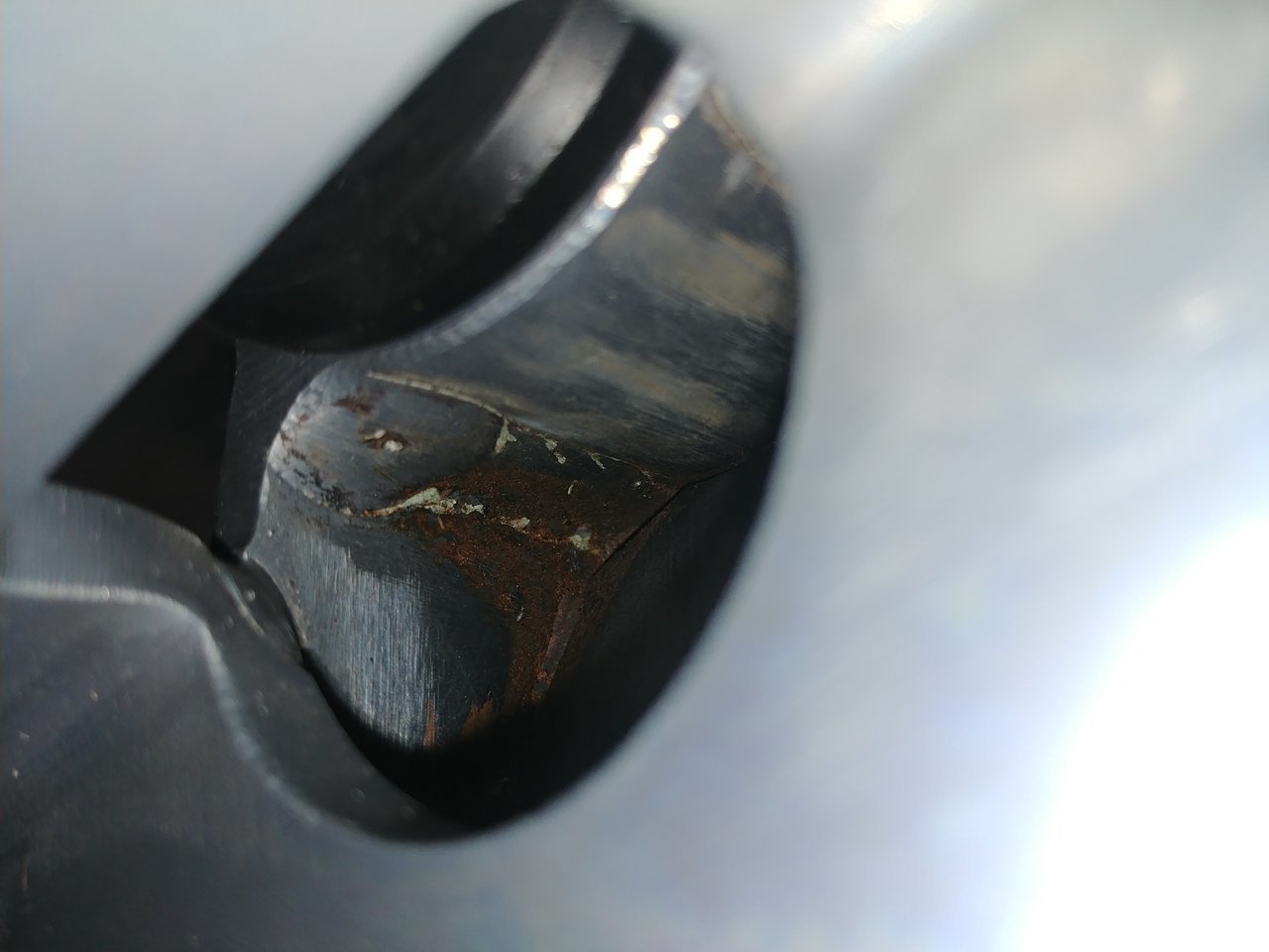

    I received mine today. Cleanest looking welds I've ever seen. The shackles are beefy as fuck. Only thing I can see that I don't like is the inside of the mount has an area where the coating hasn't quite reached the corner. Otherwise very happy. Quick shipping, good customer service.

    Thanks, that inside plating issue happens if the plating company hangs it opposite way. Adding another vent/drain hole on next batch so that's less likely. Spray a little Fluid Film in there to help

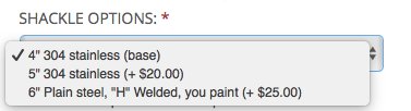

    REAR END SETUP ?
    I am going with Baja Kits front 2+ LT kit and want Archive for the rear setup to compliment the front.
    I have a 2013 DCLB, with a topper. Planning on adding a front runner roof rack to the topper and a rear bumper.
    Can you advice me if I can add all these components or what the best setup would be?
    This was my thought on components for the rear:
    2005 - 2017 2nd gen TACOMA Premium Shackle Flip Lift Kit - Not sure what setup I would need or the options to select, help? (ATTACHED PHOTOS)
    Deaver Springs U539/540 SUA 1 inch lift (pair) 2005+ Tacoma
    2005-2017 Tacoma 2.5 x 14 in or 12 in mid / long travel Shock Relocation Tower kit

    Hey Kyle,
    Thank you for considering Archive! For your mentioned plans, the U539's SUA are a good option, especially for getting uptravel at lower lift. You might choose to stay with stock hanger for now, and mounting a 12" travel shock will give you good uptravel potential, as high as your bed sides will allow, to help soak up washboards and get that needed compliance. I'm getting more experience on this setup and it is a good option
    Eric

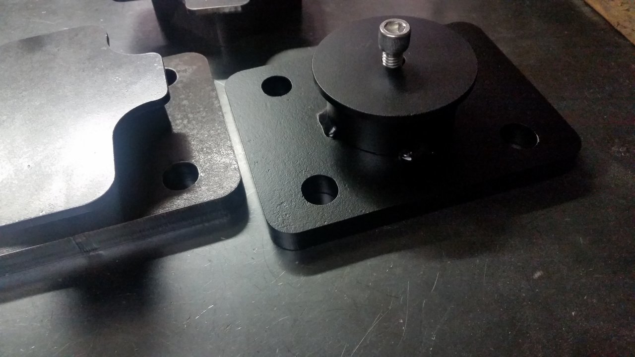

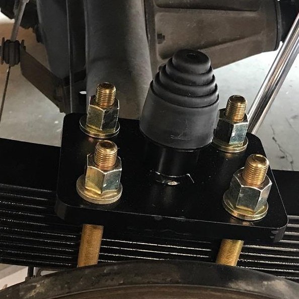

    Updated and new U-bolt flip kit/SUA kit bump options, all made from tough 1/2 & 3/16 A588 50,000 psi steel:
    1. The rubber bump mount is 3" diameter 3/16, with grade 8 3/8-16 flanged lock nut welded and stainless bolt supplied
    2. Air bump 3/16 landing pad raised 1" on square tube so you don't hit the U-bolt threads (recommended for SUA & SOA)
    3. Air bump 3/16 landing pad flush mounted to U-bolt plate, (best for SOA)
  15. Oct 10, 2017 at 4:52 AM

    Some of the things...
    Looks great!
