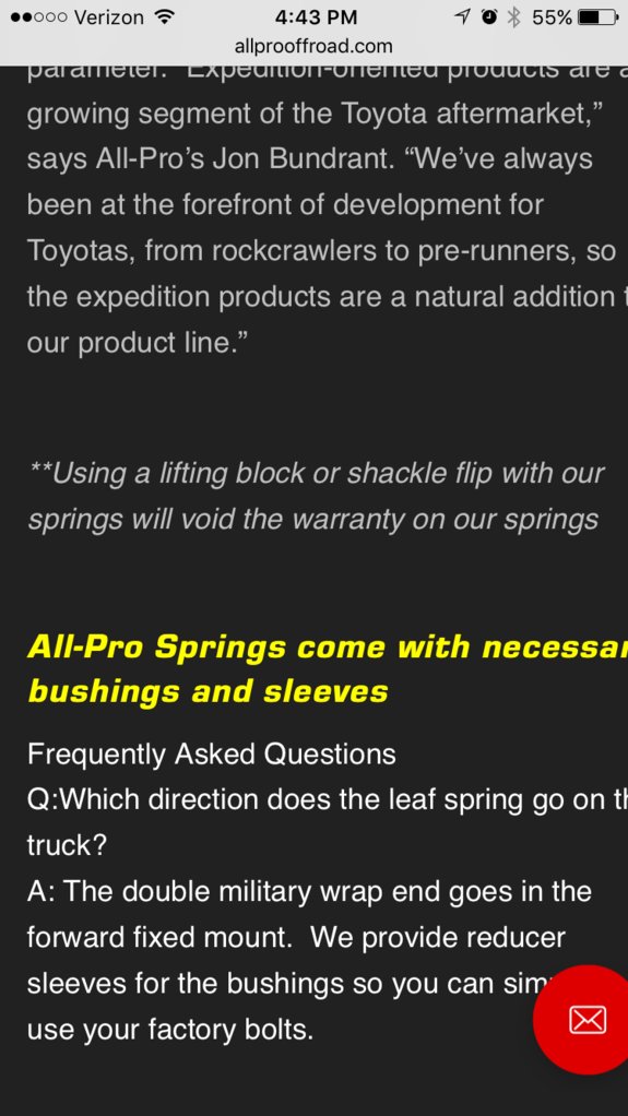

    Directly from Allpro:

    Seen it and think it is bullshit, but if you like cheap springs AllPro may be the way to go. I would try the new Icons before the AllPros but will put deavers on my truck when I can afford them. I don't know a single manufacture that will warrant their springs with a shackle flip. To me the spring broke at the U bolt pressure point.

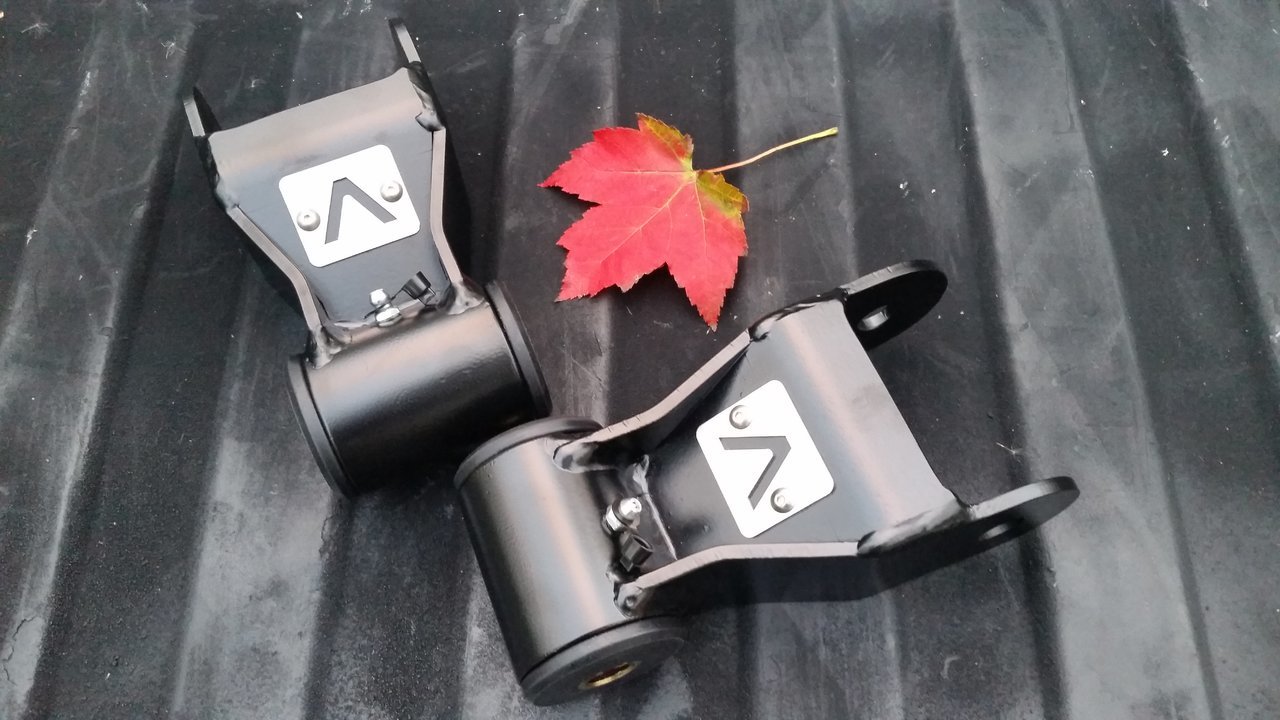

    This will help hold you guys over

    Is it just the angle or do those really hang low?
  8. Oct 15, 2017 at 5:54 PM
    #1128
    90yota
    90yota Instagram: 90_yota
    Apr 13, 2016
    #184183
    5,408
    Dixon, CA/Truckee,CA
    88 T4R / 15 F350
    Stock....ish
    Looks like they hang lower but the shackle is longer. I could be wrong

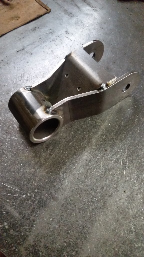

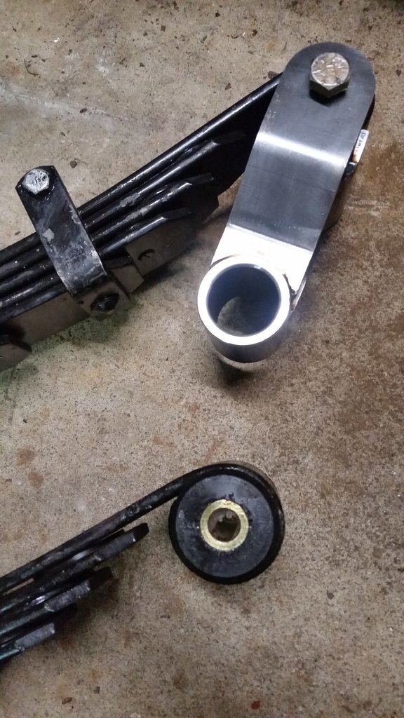

    Here's the long shackle option for the new hangers.

    So is this new shackle for SUA or for conventional SOA as well?
  13. Oct 16, 2017 at 9:09 AM
    #1133
    ARCHIVE
    ARCHIVE [OP] Well-Known Member Vendor
    Oct 29, 2015
    #168099
    2,164
    Eric
    Orchard Park, NY (Buffalo)
    '05 Taco, '22 Tundra, '91 Cummins
    2.5" Fox relocation * Hammer hanger * Archive MD springs
    Errathang
    TACOVRD[QUOTED] likes this.
