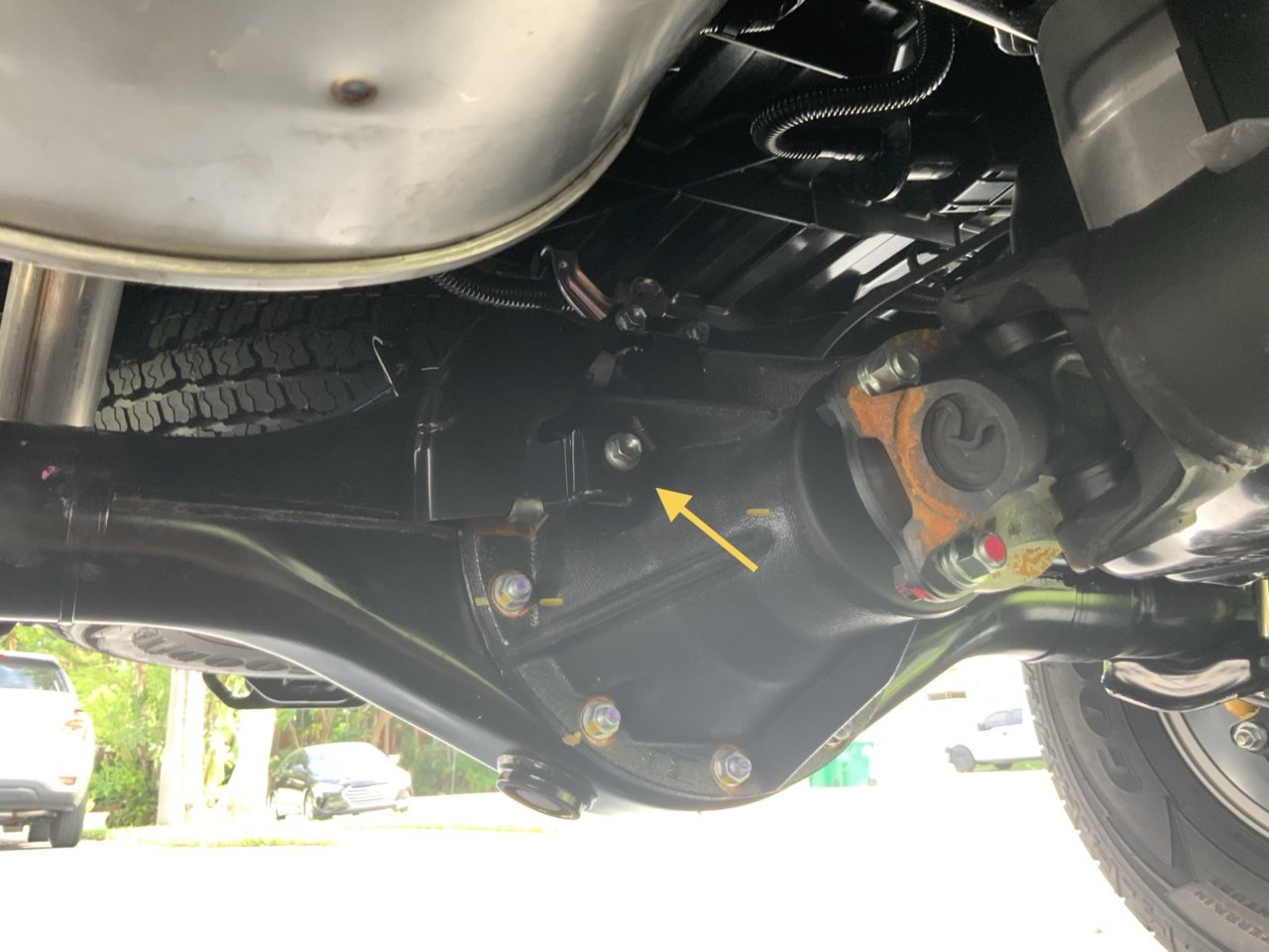

    Correct. I have a 8.75” rear differential (model BD22AN, made by Hino) with eLocker and a 4.30:1 ratio.
    I found some additional specifications on one of the differential repair/modification sites (I can not vouch for the accuracy of the information):
    High strength steel axle tubes
    43 ring teeth and 10 pinion teeth
    32 spline axles @ 1.37” dia.
    34 spline pinion @ 1.77” dia.
    Internally mounted electro-mech eLocker (see attached photo)
