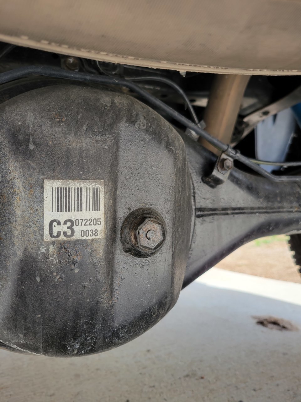

    My 07 has a C6 sticker next to the LSD sticker..Right on the rear of the differential...Double check but that means its a LSD w/ 4.300:1 gearing inside...Gotta go inside and check out that intense hum that is so ambient and hard to peg down...The pinion bearing has a clear grind with my stethescope...I am praying for no more damage past the crush sleeve...

    A04C is the code thats in my doorjam..According to the LC Engineering site. The A, well,even they don't completely understand it but 2 types of gearing was offered that year. A and B..The 04 is showing that my gear ratio is 4.56..The C is " 2 pinion,LSD ? " with a explanation about older models...bla...AND I'm running Michelin Defender LTX 265/70R17...which depending on several other things, will alter the gearing as well.. Amazing that even though I believe what I'm seeing, LC still has me not convinced...The fact that I'm about to have a nice snifter of bourbon makes everything somehow, fade to the rear of my mind till tomorrow..lol

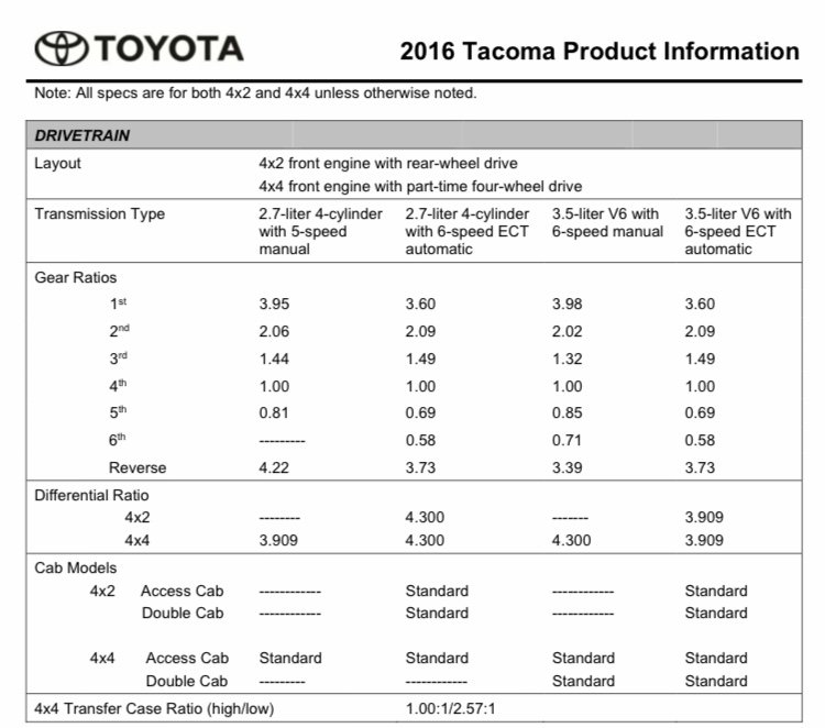

    2016 OEM Gear Ratios:

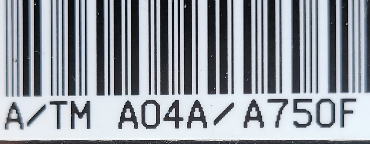

    A04A
    The entire line:
    C/TR:040/FQ13 TM: A04A/A750F

    According to the 2005 Tacoma Specifications guide: That is correct. I think these remained and applied to all 2nd gens
    right through to 2015.
    2.7l 5-speed manual (4x2): 3.307 PreRunner/4x4: 4.10
    2.7l 4sp ECT auto (4x2): 3.583
    4.0l 6-speed manual (4x2): 3.153 PreRunner/4x4: 3.727
    4.0l 5-speed auto PreRunner/4x4: 3.727 (4.0l auto 4x2 not listed)

    I was about to buy a locker.
    I do have a C6 lsd Oil only sticker on my diff.
    So do I have lsd or locker?
