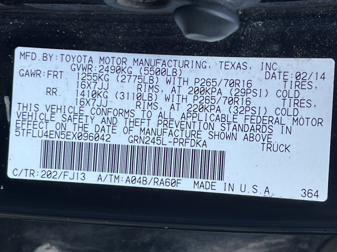

    2013 Tacoma ACLB
    I know this is an older thread, but after checking my door jam, my 2013 V6 6MT Access Cab says A04A. I was under the impression that all 6MTs were geared with 4.30, or is that just for 3rd Gens?
  2. Feb 25, 2023 at 3:34 PM
    #102
    Jeff Lange
    Jeff Lange [OP] Well-Known Member
    May 19, 2015
    #155616
    2,269
    Calgary, Canada
    '86 AE86, '05 NCP13, '11 GSE21
    That only applies to 2016+.

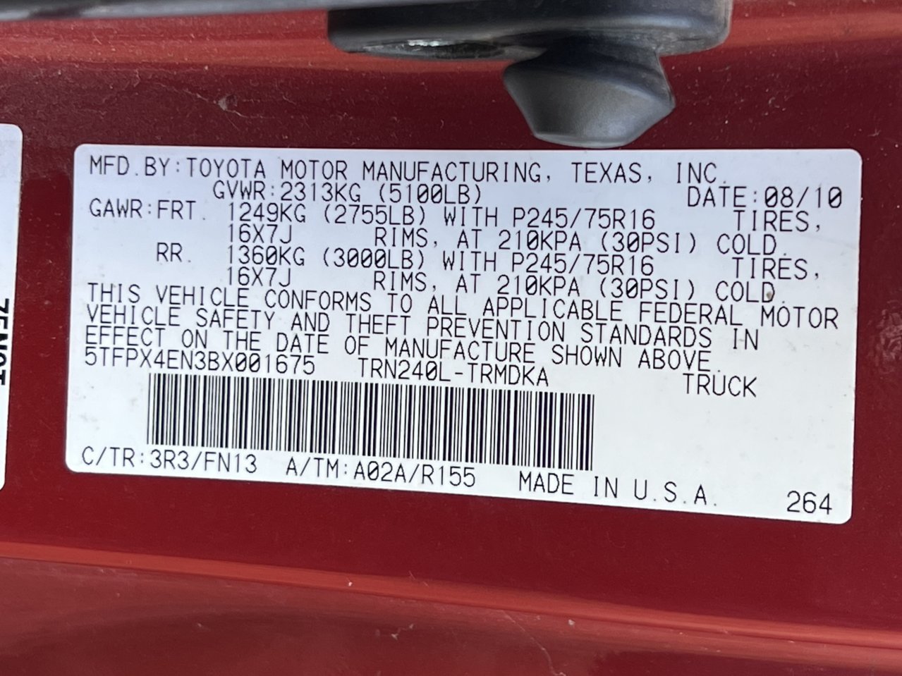

    IMG_6972.jpg 2011 two door 5 speed 2.7 liter. This looks like 8 inch open diff 4:11 gears ?

    This is my 2014 TRD OFF ROAD 4 liter 6 speed manual. With the E lock magic button with 3.727:1 gears correct ? IMG_6971.jpg

    2017 MGM DCSB Off Road, 6 Speed MT, P&T
    Yep, if memory serves me correctly, all 2nd Gen V6's have 3.73.

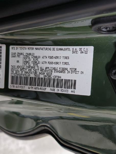

    I've run into a SNAFU and need to source a 4.30 front diff but all the info I'm finding is conflicting (including VIN searches at Toyota.com/owners for specs) and the junkyards (namely LKQ) are not helping with their mislabeled offerings. Been trying to stick to searching for V6 MT trucks but apparently not all of them have 4.30 ratio diffs like I thought. If I've got a door jam sticker, is there a way to tell which final ratio it has? If it's got an 06 in it, is there a any question if it's 4.30?
    Please help me out!

    That's a new one to me! Didn't realize any 3rd gens came with 3.73 gearing. What's your door jam sticker say for the code? Have you verified by turning the tires/driveshaft test?
    As for me, it doesn't help my understanding that LC Engineering's door jam sticker chart appears wrong (Differential Information) and different from the one in @Jeff Lange 's original post here. His chart seems like the most accurate one so far but he did mention discrepancies so I'm wondering if there are any new insights.
    So far, please tell me if I'm wrong but if it's a manual transmission 3rd gen Tacoma with *06* code in the door jam sticker, there's a pretty good chance the truck has 4.30 gearing right? Turns out I purchased a mislabeled 4.30 front diff from LKQ and I need to either swap it for a 4.30 front diff they have in stock somewhere or get my money back. It seems like most, if not all, the 3rd gen diffs they have are mislabeled but at least they're pretty good about cataloging the door jam sticker from the donor truck.
    EDIT: Looking into it more it appears 2020+ Mexico-built Tacomas have a change in the axle coding. The door jam stickers I see there on manual transmission trucks have *07* instead of *06*, but the Texas/USA built trucks still have *06*. Hmmm?
    Example: 2021 model year, built 9/20 in Mexico, RC62f manual tranny TRD Sport and A07A axle code.
