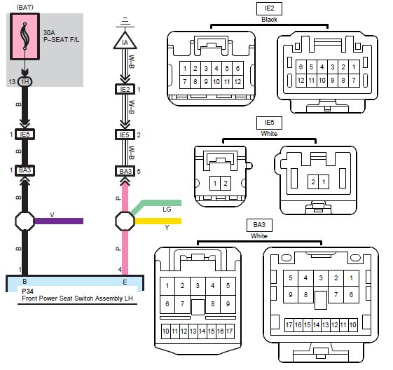

    More OEM detail...
    ORDadster and DG92071[OP] like this.
  4. Jan 30, 2020 at 8:47 AM
    #24
    caribe makaira
    caribe makaira Well-Known Member
    Feb 13, 2011
    #51121
    11,786
    Caribbean, Puerto Rico
    05 PreRunner TRD Offroad AutoTrans
    Hood Struts, My version Fogs always ON, Map & Overhead Light Mod,
    OP, I suspect that BA3 is the all inclusive connector, i.e. seat power, SRS, heat, etc.
    DG92071[OP] likes this.
  5. Jan 30, 2020 at 8:51 AM
    #25
    DG92071
    DG92071 [OP] Well-Known Member
    Nov 29, 2019
    #312004
    2,996
    You're really good at that. I'm not good at that, lol. How exactly do you get these schematics? I'd love to know.

    TIS site then MSPaint to modify...
