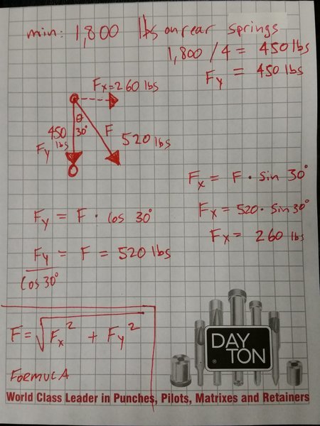

    With shackle angle at 45°, the shackle is putting approximately the same force backwards on the spring as it is downward. With Nathan's angle of 55° from vertical, that's more force backwards than downward.
    Take an empty Doublecab with an estimated 1800lbs supported by/above the spring mounts. 1800lbs/4 = 450lbs each spring mount must support.
    That means with shackle angle at 45°, the spring eye is supporting 450lbs while a rearward force of approximately 450lbs is also being exerted on the spring stretching it out. The rearward force is not there with stock hanger and a vertical tension shackle, the spring only has to deal with 450lbs.
    My recommended shackle range is between 30° and 10° from vertical. If you plug 30° into above example, the rearward stretching force drops to 260lbs. You don't need to be scared of going past vertical shackle angle with droop, you just try to limit it and keep a sufficient amount away from locking to shackle.
    I am happy to give my recommendation. You're welcome to do what you prefer, but there are different solutions for different uses.

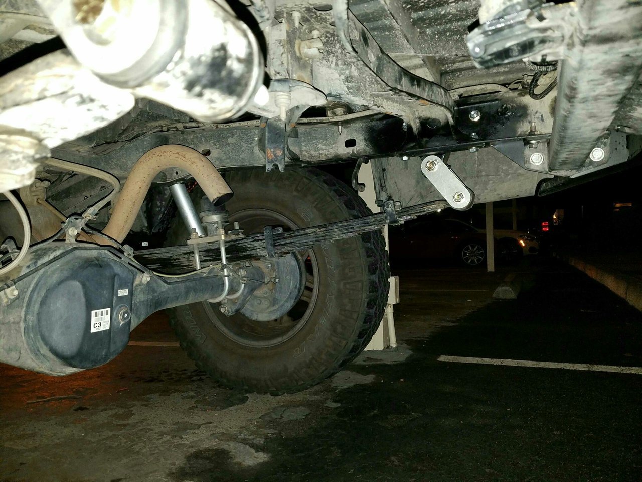

    For the comments on the last 2 pages about shackle angle at rest, I'm running AllPro expo leafs and my resting angle is like this... d9fa51ac4bdbf2afbc3c6cf2995316a3_3641224108f2d55d9de734d4377b6c3ddf8f9d0f.jpg

    Although my leafs look crazy flat on that picture... I need to check that in the day because I don't remember them being that flat 2 weeks ago when I installed them lol

    Thank you for this pic.:thumbsup:
