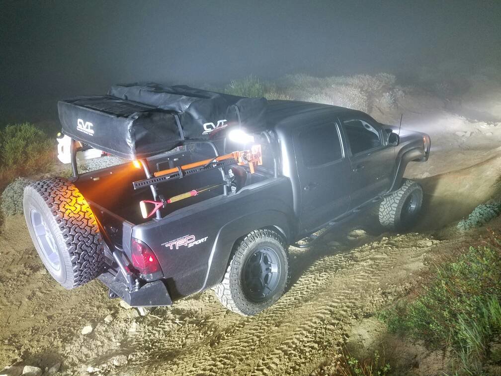

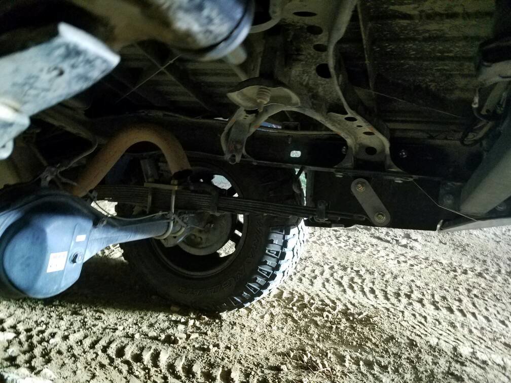

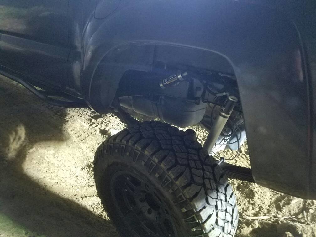

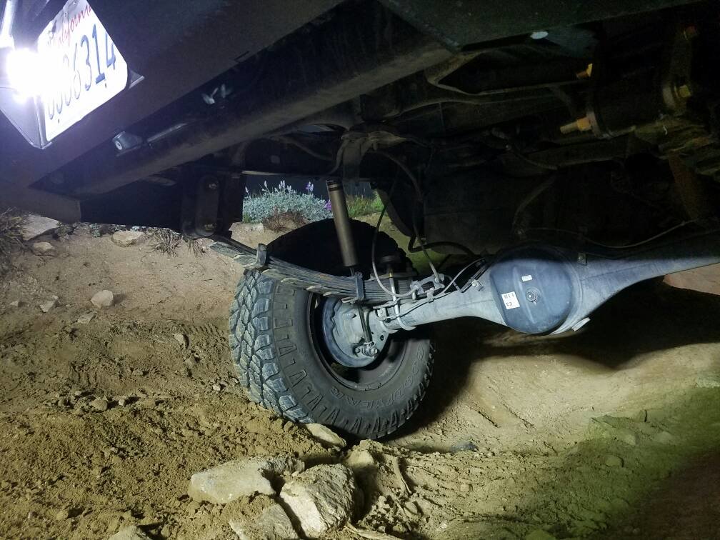

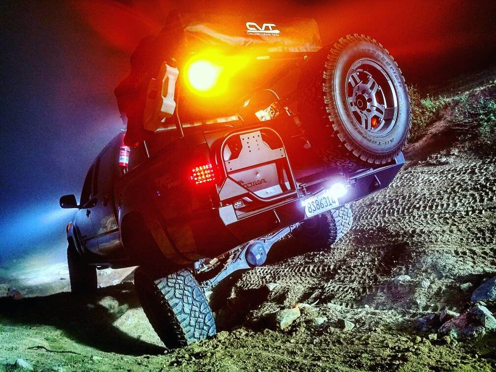

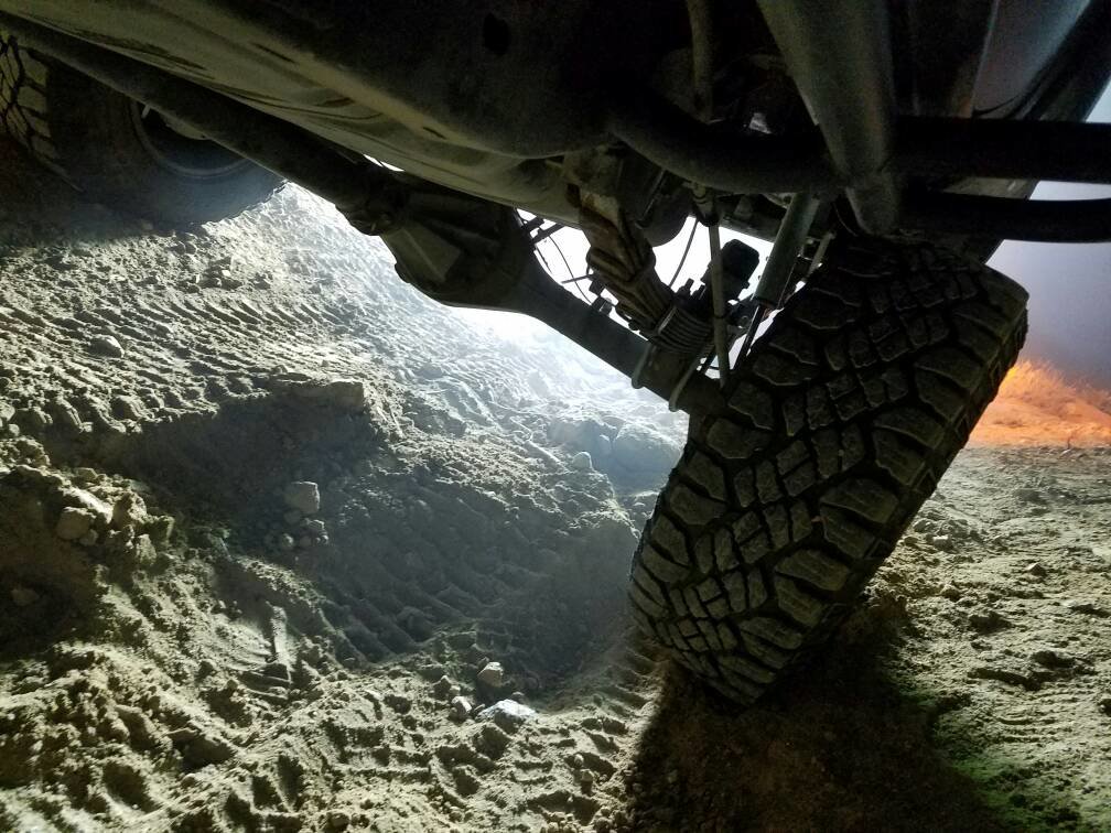

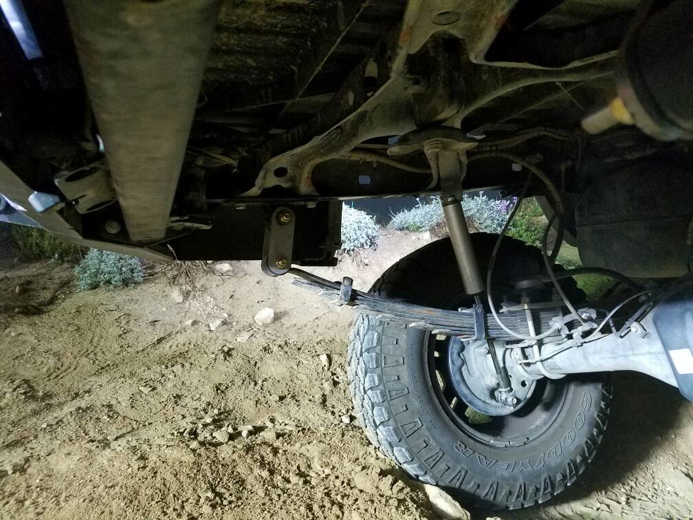

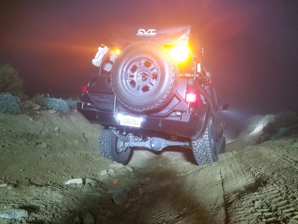

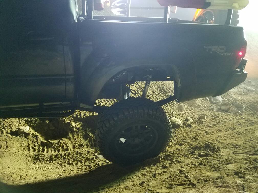

    Few pics from last night. Tried to droop as much as a could considering it was dark, cold, and wet. The 1 time I got the rear wheel off the ground I couldn't get out because I almost rolled, so hopefully you guys will enjoy these for now :)

    Shackle angles looked good. Didn't go past vertical and I'm almost certain I had more room for travel on the shock.

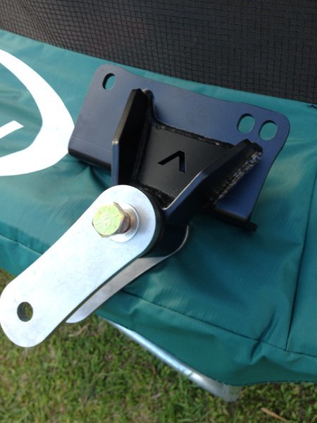

    Hey Eric, I got my kit yesterday! I'm really impressed! The parts are beautiful. The welds are nice and uniform, the brackets have a great coat of paint, and everything was very neatly and carefully packaged.
    To anyone who is in the market for a shackle flip kit and is on the fence about this small company, fear not. These parts are gorgeous!
