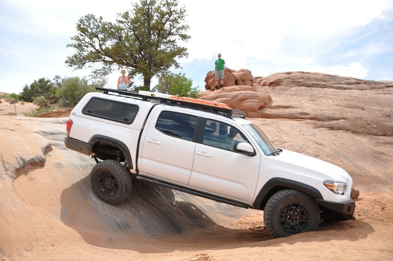

    @Brosefff flexing out his dream build 2016 in Moab. He has the Deaver/Total chaos spring under conversion with HD springs. The added weight of the topper, bumper, racks and typical camp gear weight left him looking for some lift as he was only 1" from the King bumps tapping and it didn't seem right for it to be tapping down the trail. The Archive shackle flip has been working well for him thus far, and brought him nearly 1.5" lift. The shackle angle at normal weight (shell, rack, and Pelfreybilt bumper) is sitting about 25deg from vertical with brackets in foremost position.
