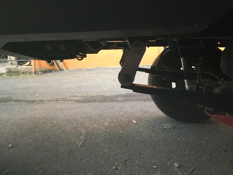

  16. Jun 25, 2016 at 10:30 PM
    #296
    kumz
    kumz Well-Known Member
    May 12, 2013
    #103998
    563

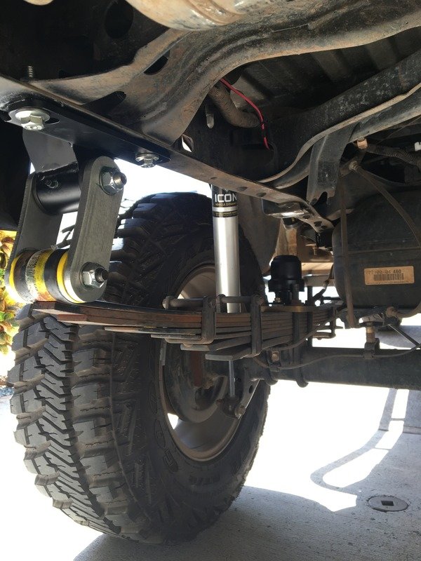

    Installed my flip today. I'm running dakars, and extended travel icon 2.0 shocks (56503R-EXT). I normally don't have much weight in the bed, with the exception of a dirt bike, or camping shit. shackle angle is at 25 deg. My truck is on a slope, so the shackle angle looks worse. Its not too bad, actually smoother than the inverted shackle. gained around 1" in the back. May try a smaller shackle to bring the height back down a bit.
    8E6CA178-84C1-4060-A593-534767613878_zps_c421965b229e401412e1b700642af2796fcc8a8a.jpg
    B25F5EAE-184E-4EE4-B6CE-0D0DEFBA0121_zps_fbb0d1687cf1e61e9a5236143c95bf8ff6af4055.jpg
    Overall, very happy with the purchase. Thanks archive garage :cheers:

    Thanks for posting your results. I'd like to see you keep the 4" shackle. Some with Dakars have removed 1 of the 2 overload leaves which would lower you maybe 1/2". That might work good in your case with your not carrying much extra weight
    -Eric
