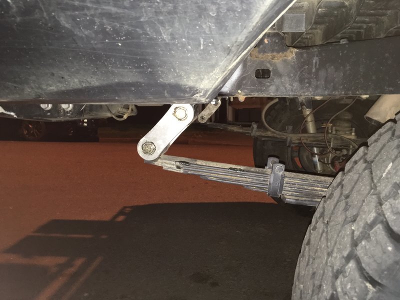

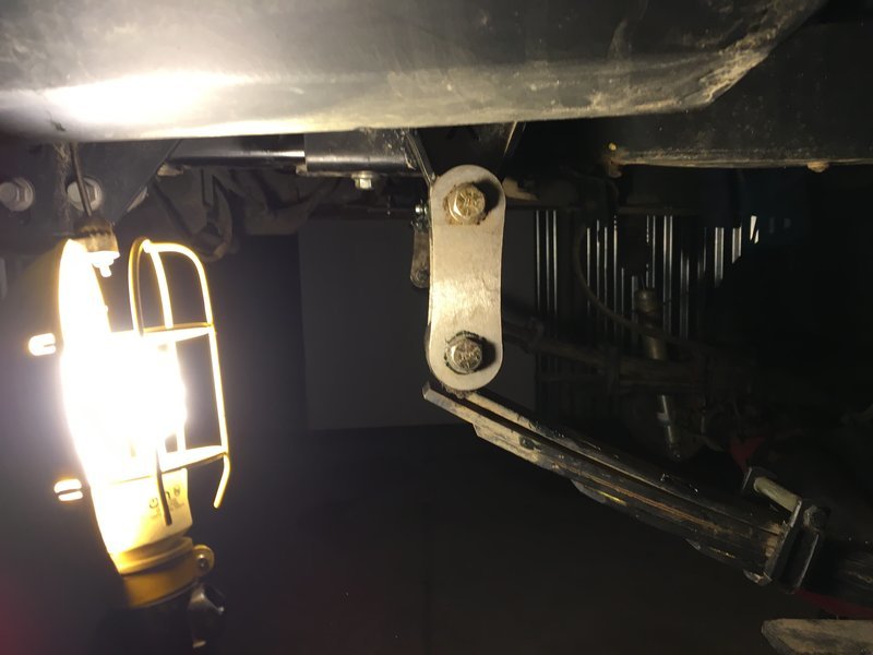

    I moved forward about 1 and 1/8 inch from the forward most position. I drilled 4 new holes in the frame and 1 in the shackle hanger. I'm much happier with the angle now. :thumbsup: I'll have to check how the spring look compressed this weekend.

    does drilling new holes screw up the cross member at all? If I recall that cross member uses the rivets to fasten it to the frame. Once the rivets are gone the shackle hanger bolts take their place. Are you guys putting some bolts through the factory holes just to hold the cross member?

    It won't mess up your cross member. You should be able to get a bolt in the rear most position, if you take a look at @kumz photo post #310. I also had to bend just the corner of the cross member to get the nut on the side of the frame where I drilled the top.
