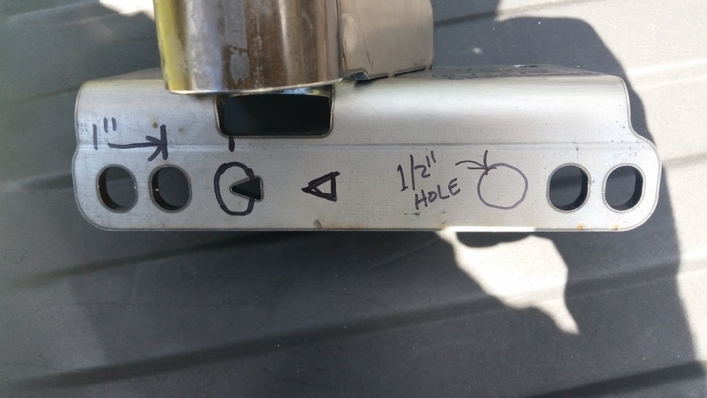

    Thank you Brandon @kumz for trying this and testing it out!
    Thank you also to @Littles @weldo @deeezy @58 Siesta @Adventurous @SMKYTXN @ROK-NJA for adding your constructive criticism, it was cool that this was 3 pages of discussion in 3 days. My goal is to make the best products available on the market. You have been heard and I am willing to add holes that help owners with OME Dakars. These springs are considerably shorter than other brands, I wonder if the Dakar packs were designed for the HiLux outside of NA?
    Deaver spring packs #u402 and #j66, and All-pro packs already can achieve ~45 degree shackle angle with current foremost position because they are the right length.
    I think KUMZ did a really good job with where he added holes and made sure he bolted through the crossmember so I will just add holes similar to what he did. However, I am kinda feeling it should be 1", but I will listen to opinions whether it should be 1.125 or 1.25"
    These holes will be added to next batch which I am about to start and should be available to order around August 1st. I will also add the option on my site to add (4) extra frame bolts to use with the Dakars for $10.
    While I'm announcing stuff about adjustment, Archive shock relocation brackets are in development!! It will have all the quality of Archive products and raise the bar for what's currently available.

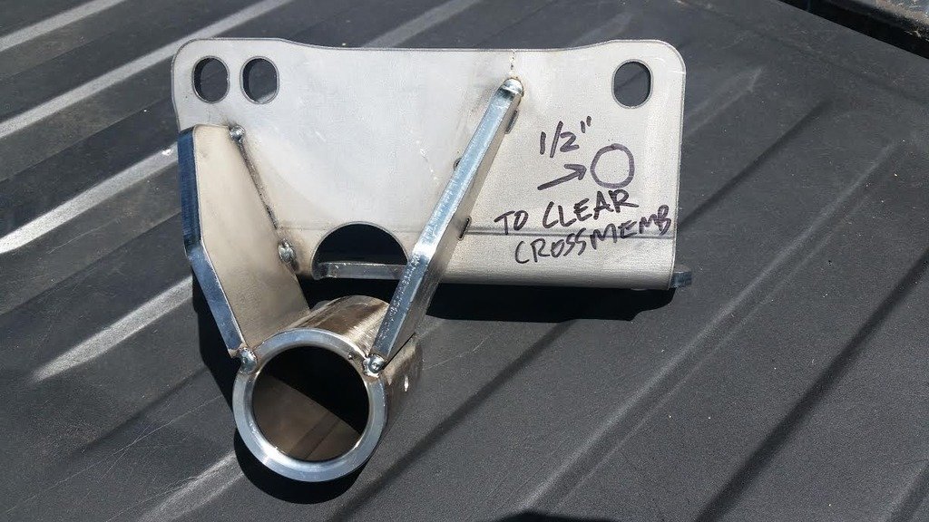

    This pic shows where I intend to add another front hole to tie in crossmember, but you will still match drill thru foremost bottom hole for strength. I will possibly add a rear hole to to clear crossmember if the current doesn't clear, and then you'll also have another bolt at the rear that is just for frame to crossmember, just like KUMZ did.

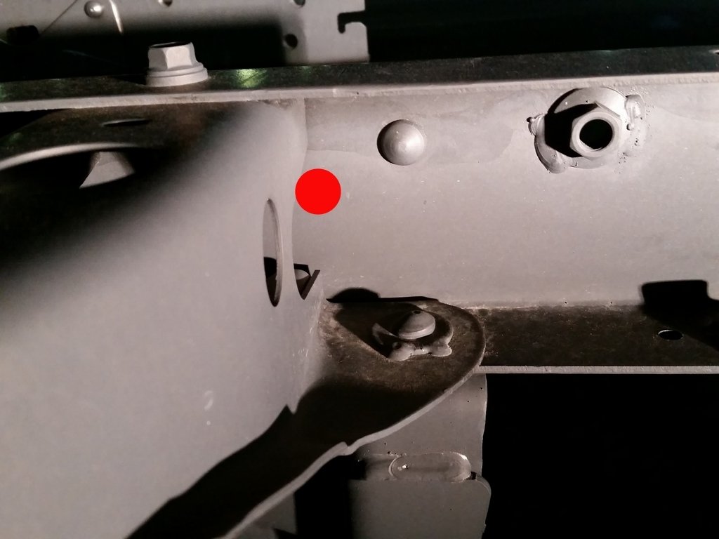

    This shows a rear upper 1/2" hole to be added to clear crossmember, you will match drill thru new hole in bracket into the frame. For strength reasons, I will not add a 3rd front hole, you just match drill thru the foremost hole like Brandon did, this way no additional stress will result on frame or brackets
    and here is a pic of how the frame looks inside near rear bolts, looking at passenger side. The red dot is close to where new rearmost upper hole would land.

    IMHO, I would go with 1" on the new holes, which is what I was shooting for originally. You probably will need to add that lower hole to clear the cross member...I match drilled through existing one and was almost flush against the cross-member, but was able to bend it out of the way with pliers to get the washer and nut on.

    Thank you Bryan for the feedback, and you're right, I forgot about the webbing welded in the crossmember. The 2016 crossmembers do not have that webbing.
