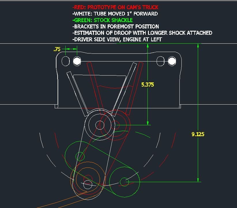

    I have contacted the guys who purchased the production kits to get some pictures. Could be a few weeks. However, I am confident there will be plenty of angle on the shackles with production updates.
    Here is a diagram showing the production shackle tube moved 1” toward front on the brackets. With this change, even with the brackets in the rearmost position, the tube will be ¼” forward from Cam-shaft’s truck (in foremost position). This change will make the brackets work from stock springs, thru the overlanding spring range, and up to more aggressively arched springs. Then there is the option to slide the brackets along the frame and drill new holes if your setup is extreme. Cameron did look at the situation with the shock unbolted and the spring did not get too close to inverting. He mentioned it showed about a 3" gap to his current shock length (Bilsteins).

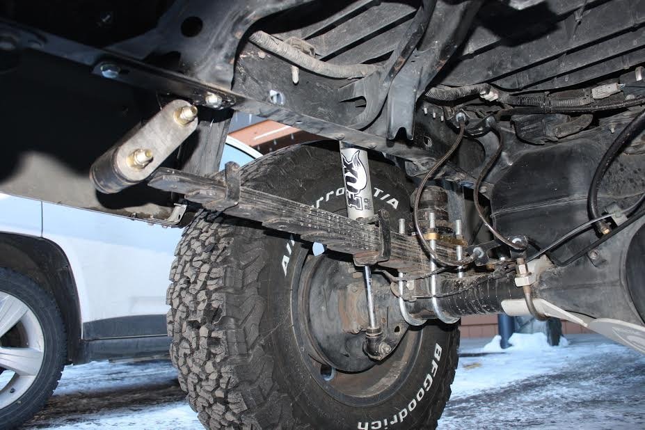

    So here is one of my customers install with Deaver 10 pack springs. He has the brackets all the way forward hence that steep angle, but looks like the deavers are fairly long. He says the shock is the limiting factor and is planning a 12" stroke air shock install in the coming months. He says he is very satisfied and already had them off road in rough conditions. Follow @alternativecreation on Instagram
    One thing I noticed from his picture is the stock bumper bracket "teeth" looks like it will need to be trimmed 3/4" to fit brackets in rearmost position
