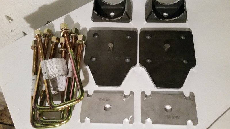

    Dude, that is Awesome! I notice that the "bump plates" have a wing that protrudes to the outboard side (towards the wheel). I'm guessing that is for the use of hydraulic or air bump stops?

    Thanks! Yes the bump plate has the landing incorporated. You can see there is good clearance under the springs, not an ugly drag point.
