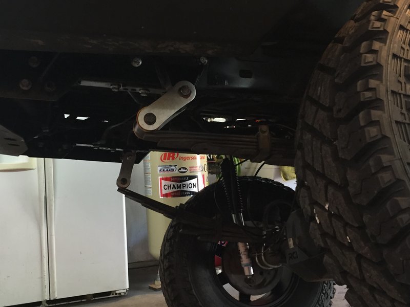

    The shackle flip is working out very well with the new Toyota 3+1 springs, and this is a great way to get lift, probably 1-1.25" and when installed in the middle position returns a shackle angle about 30-35 degree. Also, droop is working quite good with this combo as well.
    $250 for the shackle flip or maybe $500 for new spring packs
    And then get some Bilsteins B110s about 26" long +or- 1" for an affordable option

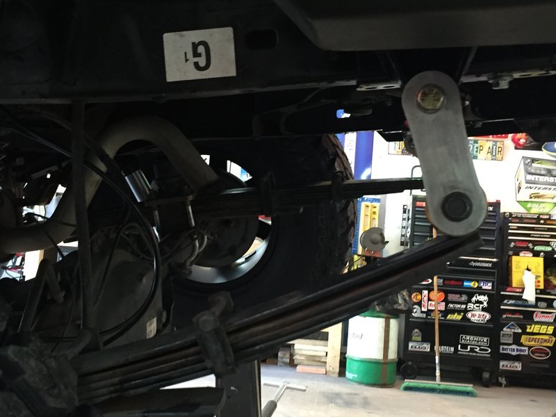

    Just reposting this to show results with Toyota TSB 3+1 springs @BeaverYota
    Edit: this shows brackets in rearmost position with least shackle angle

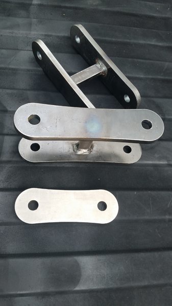

    New 6" shackles are now an option.
    Plain steel with H-connector welded in since they are 2" longer.
    This will add min 1" to droop travel, I recommend using with significant shackle angle.
    This will add additional pinion angle, maybe about 2 degrees.
    Shown here next to 4" stainless shackle:

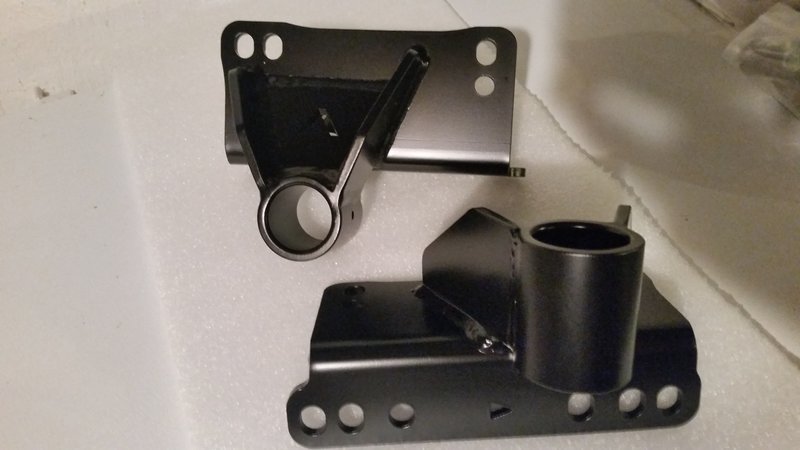

    Here is the latest revised version of the brackets to allow about 40-45 degree shackle angle with the shorter length OME Dakars similar to what @kumz
    I went with 1" forward holes. I think in addition to working with OME springs, this forward position will be good for SUA conversions and longer than 4" shackles.

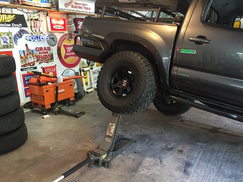

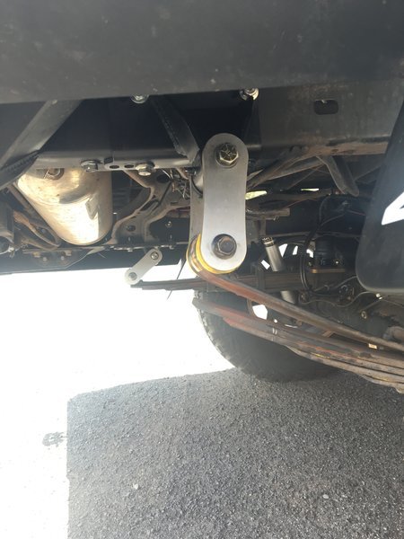

    Installed. Thanks Eric for the great setup, and the great customer support. I'm very happy with this :thumbsup:
    Now I need to flex it with the fork lift at work to see much it'll go. My floor Jack ran out of lift.
    Durdy, Crom, Dogg23 and 4 others like this.

    Nice dude! That's awesome! Shackle angles look great!

    Thank you. I'm really happy with the angles. Of course, that part is preset. Another reason why I love this kit.
